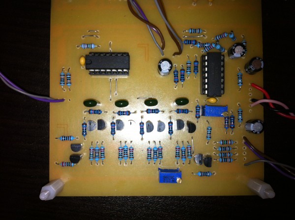

Hi
does the self osc suppose to clip when i put the reso all the way up?
it reaching to the red lines in my sound card, but hard.
is there any way to reduce the gain of the self osc?
one more thing...it seems i cant get more then 14.5khz when self oscillating.
can i get it to 20khz?
Isak E. _________________ http://www.myspace.com/mgmtrance |

1-No I don't remember it would clip, normally it's a nice sinewave but with a very large amplitude.
2-That's the normal behaviour of this filter _________________ Yves |

ok, i did some tests and pics..
this is the pic of the clipping..
and this is the sine wave in different freq position.. (no VCA, straight from VCF).
any idea or help please? _________________ http://www.myspace.com/mgmtrance |
yusynth
Joined: Nov 24, 2005 Posts: 1314 Location: France
Posted: Thu Jun 20, 2013 11:16 pm Post subject:
OK, therefore the auto-oscillation is not clipped in the filter but by your audio recording board. If you look at the scope you'll see that the signal level is something like 8 to 10V peak to peak, this correspond to an audio level of something between +10dBU to +14dB.That's completely normal, signals and CV in modulars are way up the so-called audio-range. That is the output signal of a module MUST be attenuated (at least 8 times) before being fed to a normal audio device.
Now I am puzzled by the waveshape you show for the highest frequency auto-oscillation getting a quasi triangle shape.
Which type of power-supply are you using ? _________________ Yves |

Yves,
Could the shape be like that cause of bad transistors matching?
Or maybe the lm3900 is bad? _________________ http://www.myspace.com/mgmtrance |

I have just checked the auto-oscillation behavior of the yusynth ARP filter with my oscilloscope and I obtained a perfect sine wave from 21Hz up to 19,4kHz (corresponding to the full range of the cut-off potentiometer).
Concerning the peak to peak amplitude it rises from 8Vpp at 21Hz to 20Vpp at 19,4kHz.
Freq shape amplitude
21Hz sinewave 8.0Vpp
100Hz sinewave 9.0Vpp
500Hz sinewave 10.4Vpp
1kHz sinewave 11.6Vpp
5kHz sinewave 15.6Vpp
10kHz sinewave 18.2Vpp
19,4kHz sinewave 20.0Vpp
Are you sure that you are using your oscilloscope correctly ? Are you using a X1 probe or a x10 probe, in both case have you calibrated your probes ? _________________ Yves Last edited by yusynth on Sat Jun 22, 2013 12:25 pm; edited 2 times in total |

Do you have a scope function in your recording software ? How do look the waveforms (without clipping of course) ? _________________ Yves |
yusynth
Posted: Sat Jun 22, 2013 12:29 pm Post subject:
OK doesn't seem to be a problem with the probe. I am puzzled. Can you post photos of your PCB (good resolution) so we can check there's no mistake. _________________ Yves |
isak
Joined: Dec 13, 2009 Posts: 847 Location: Israel
Audio files: 18
Posted: Sat Jun 22, 2013 12:46 pm Post subject:
| yusynth wrote: | | Do you have a scope function in your recording software ? How do look the waveforms (without clipping of course) ? |
2 kinds of comp scopes, no clipping.
isak
Audio files: 18
Posted: Sat Jun 22, 2013 2:10 pm Post subject:
| yusynth wrote: | | OK doesn't seem to be a problem with the probe. I am puzzled. Can you post photos of your PCB (good resolution) so we can check there's no mistake. |
