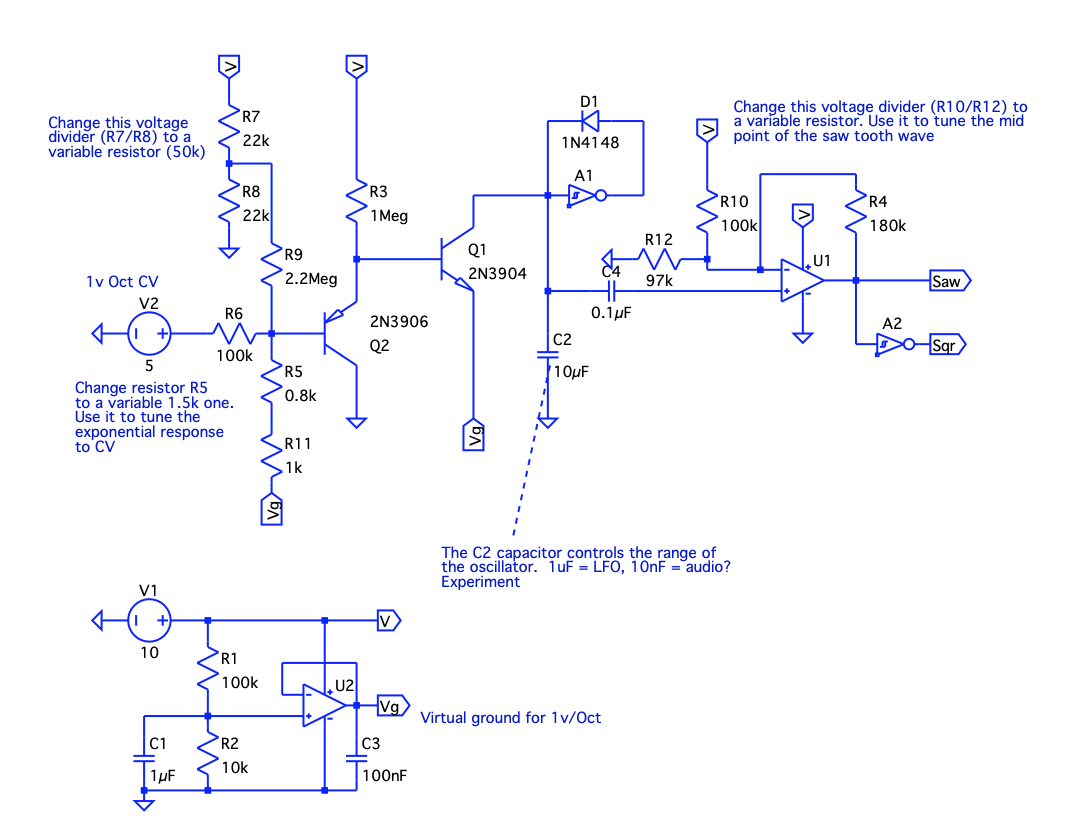

PostPosted: Wed Nov 27, 2019 1:00 pm    Post subject: Reply with quote  Mark this post and the followings unread
Here's my take on this circuit. The expo converter is taken from Rene Schmitz's 4069 VCO, but I adapted it to work on a single sided supply (0 to 12v).
My big contribution is centring and amplifying the saw tooth wave before passing it back into an unused 40106 inverter to form the square wave. If you add a dc offset to this, before passing into the inverter, you will get pulse width modulation. Smile
If you want to keep it strictly CMOS, you can substitute the op-amps for 4069 unbuffered inverters, but you'll have to experiment with the resistors, and reverse the R1/R2 voltage divider (I think - not tested, I just use a TL074!)
this VCO will not behave very "well tempered". R4+R10 are a load for C2 and sink/source current that adds to the expo current.
nrrrd
Joined: Jul 27, 2019
Posts: 4
Location: Oxford
PostPosted: Wed Nov 27, 2019 3:01 pm    Post subject: Reply with quote  Mark this post and the followings unread
elektrouwe wrote:
Hmmm. Should I use an op-amp to buffer the output of C2? i.e. between C2 and R4?
elektrouwe
Joined: May 27, 2012
Posts: 146
PostPosted: Wed Nov 27, 2019 11:26 pm    Post subject: Reply with quote  Mark this post and the followings unread
yes, an opamp buffer would help. You could amplify & offset with a noninverting opamp to save the extra buffer. Also think about replacing the single 40106 with 1/4 TL074...

PostPosted: Fri Jan 24, 2020 5:25 am    Post subject: Reply with quote  Mark this post and the followings unread
I forgot about this (I got distracted making a dual Wasp filter) but here's my revised circuit, using ideas from kaputtpanzer and elektrouwe
Don't use a 10uF cap for C2, I just put that in to speed up the Spice Sim. Try 1uF, 100nF or 10nF.

Everything in my setup is 0-5V in and out, but I was hoping to get as much range out of this as possible, so thought that I could use +/- 9V just for the expo convertor and keep the 40106 running on 5V...
The expo converter is a voltage to current converter (current source or current sink), so the output is a current that charges the integrator's capacitor.
The amount of current passed sets how fast the cap charges.
The voltage on the 40106 input is the capacitor voltage.
It starts at 0 volts and climbs until it hits the trigger point of the schmitt trigger in the 40106 gate. Once that is reached, the cap is discharged back to near zero.
So the voltage at the input never gets high enough to damage the 40106.
As for the range of the oscillator, I would start by choosing the cap for your needs. If too large, high pitches need more current, I would rather make the cap smaller than increase the current to get higher pitches. The correct cap is the one that gives you the range you need with the voltage range you have. Experiment.
I would try it.
