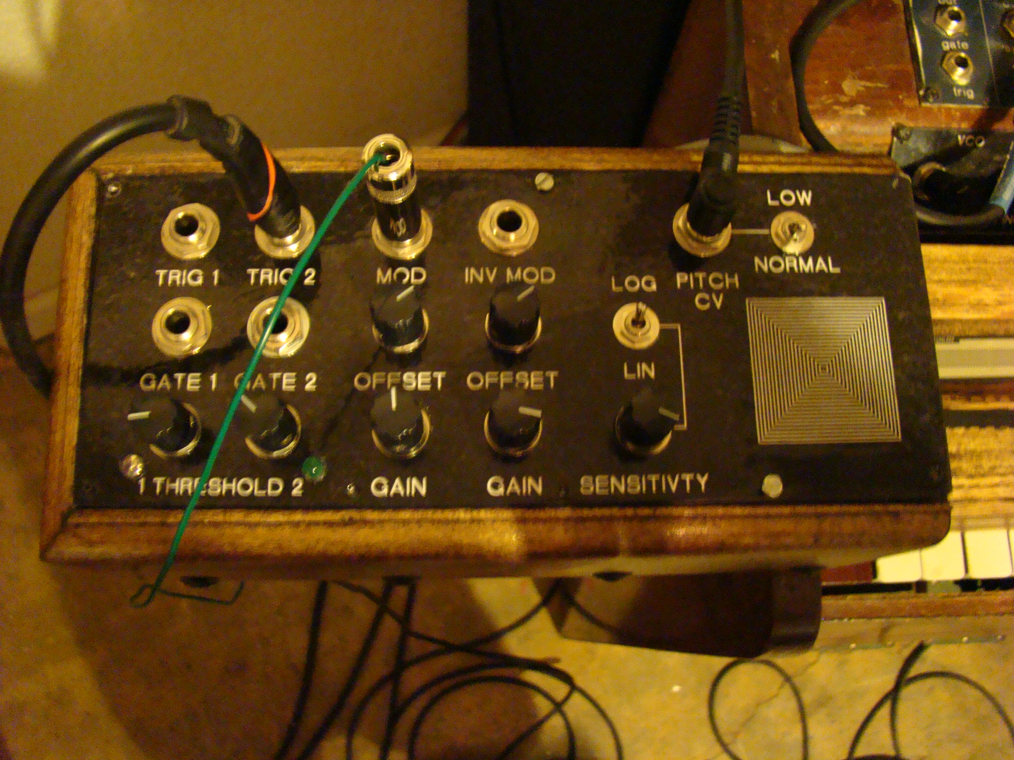

PostPosted: Wed Jun 26, 2013 7:05 am    Post subject: Reply with quote  Mark this post and the followings unread
just need to sand/finish the wood, replace a pot that i managed to destroy, and build a couple A/R generators for the right side control panel. everything is tested, just need to put it all together. I found the transducers i need, i need a gong now. I'm also mounting a couple of them on the soundboards of the reed organ this is built on. Also need to re-tune the keyboard as i switched from +/- 12v to +/- 15v. Probably wait on that as it only does about 20 keys and i think that can be improved. i need to be able to hold the voltages [0-12VDC and 0-150VDC)after key up until the next key down to really make it nice.
 Filesize:  976.07 KB
 Viewed:  1176 Time(s)
 Filesize:  954.17 KB
 Viewed:  1153 Time(s)
tojpeters
Joined: Feb 04, 2013
Posts: 22
Location: cali (far north)
PostPosted: Wed Jul 17, 2013 4:13 pm    Post subject: Reply with quote  Mark this post and the followings unread
everything works. now i need to add position markers. will add 2 ADSRs in the future.

Beautiful work, tojpeters.

PostPosted: Wed Aug 28, 2013 2:01 am    Post subject: Reply with quote  Mark this post and the followings unread
tojpeters... this is looking great. Can't wait to hear it!
tojpeters
Posts: 22
PostPosted: Wed Aug 28, 2013 8:46 am    Post subject: Reply with quote  Mark this post and the followings unread
thanks. i was going to post video but this thread kinda died out. it excels at the things one would expect- vibrato, slides. not as good at fast playing,takes time to move up an octave or two.
