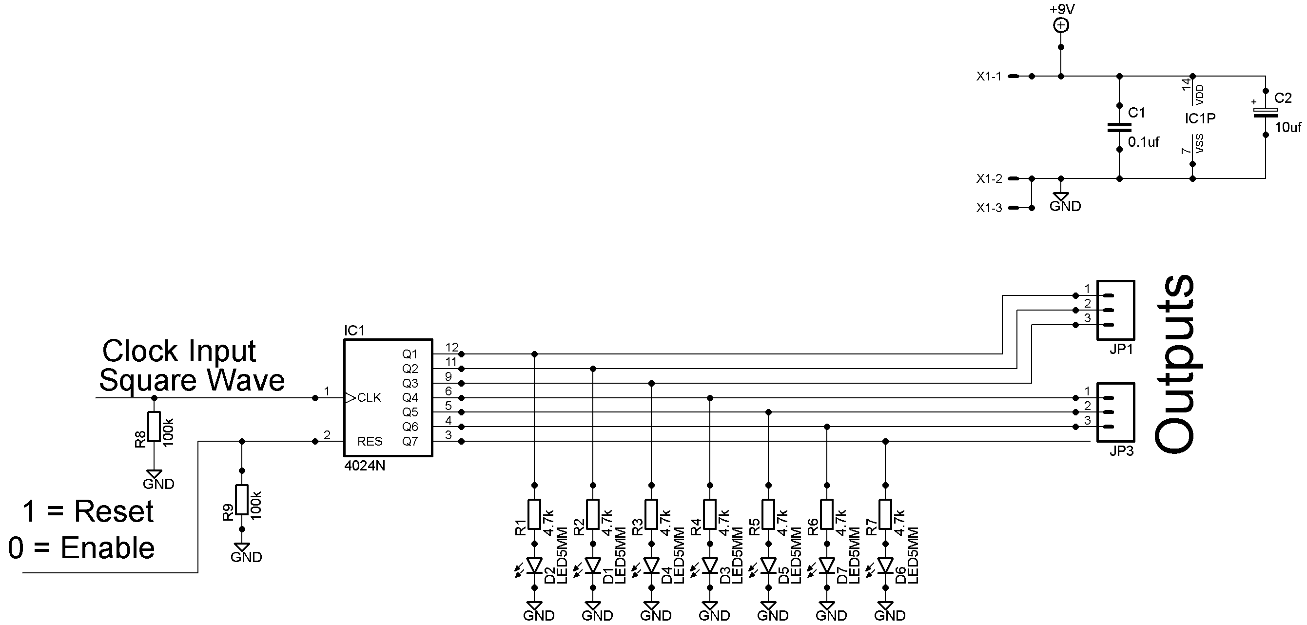

-- could someone post/direct me to a simple 4024 circuit that involves a low part count so that I could test my 4024 chips to see if they're working right?

here is a simple schematic for the CD4024.
Feed the 4024 input with an Logic level Square wave. Simple Hex Osc will do the trick.
If you are not sure about digital circuits check out this link.
http://www.milkcrate.com.au/_other/sea-moss/
The 4040 chip is explained in the above link and works on the same principle as 4024, just less division outputs. The LED's will let you see what is going on. you can also listen to the output square wave as well.
Also here is the datasheet for the CD4024. The intro tells you how the chip functions.
http://www.classiccmp.org/rtellason/chipdata/cd4024.pdf
have fun
