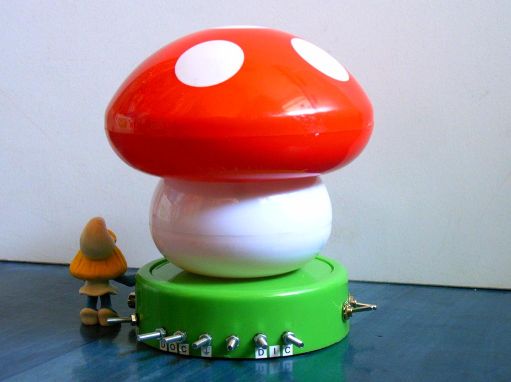

The 2nd thing the video inspired me to do is pretty much unrelated to the previous experiments. I happen to have some LED mushrooms myself
which I've been wanting do something with. They're larger then the ones RingMad has and have bright white LED's powered by 4AA batteries. My
initial idea was to install some colored LED's and make it so I can control it with a lunetta patch to have some extra lights to go with the sound.
I found out that you can get some pretty random effects by clocking a shiftregister with an LFO and feeding a high frequency signal to the
data input. (It shouldn't be random but it's most likely caused by drifting of the used oscillators). A nice bonus with a using a shiftregister is that you
can link it to another one which is useful since I have 2 of those mushrooms

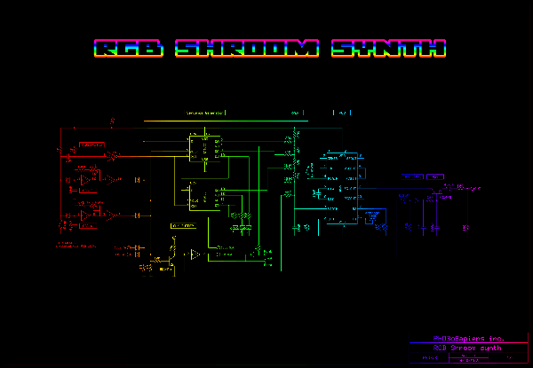

To make them usable as blinking shrooms without the need for external control signals I added 2 oscillators. The CLK is provided by OSC A the
'data' by OSC B. I used the original on/off switch (which is mounted in such a way that it works by pressing the mushroom) to turn both
oscillators off, which is what the diodes on the inputs are for. Because turning them off results in a high output they are also both inverted (U1b, U1e).
To be able to use external signals as well without creating shorts I added OR gates using diodes and a pulldown resistor.
When the switch is closed there's also a pulse generated (1M resistors + 1nF cap + U1d) which resets the shiftregister, so It works like an on/off
switch when there are no external signals connected. The CLK output is buffered to prevent any problems when linking it to something else.
(It's also necessary for the ENV. GEN.)
This worked nice, but as usual you can always add moooore!
So besides LED's I added an R2R to the outputs of the shiftregister to create a CV for a VCO. At first I had them connected to the same outputs
as the LED's but I noticed on my scope that the LED's affected the voltage. The 4M7 resistor connected between the R2R and the (inv) CLK
causes a small pitch change after each note, and the 10nF capacitor creates a (very short) glide effect. Both are added to give the sound a bit
more shroom
The VCO is just a CD4046 with a (de)range pot to have some control over the frequency. The 2M2 resistor attached to pin 12 makes sure it doesn't
go too low which I didn't like for this synth. The XOR gate inside the 4046 is used to create a ringmod signal from the VCO and the signal that is
used to control the data input of the shiftregister (OSC B or external). This creates a nice metallic sound. The frequency of OSC B is controlled
by an LDR mounted near the RGB LED's for even more shroominess.
The signal then passes through a simple env generator and 1 transistor VCA to create short sounds. In Step mode it produces a sound on every
CLK pulse in Funk mode it is controlled by the shifregister and is more random. Because the output of the shiftregsister often stays high for
several CLK cycles I added the diode and 1K resistor, so even if the output of the shiftregister stays high it will go low when the CLK does.
And by this point I pretty much reached the limit of what I could add in the available space. Actually it was quite a challenge to get everything in
I managed to make the PCB small enough to fit it inside the battery compartment. and had just enough room for the pots, connectors and
switches. I also had to keep the wires short because they take up space too, but with a bit of patience I got it all in and closed up

| Quote: | | The XOR gate inside the 4046 is used to create a ringmod |
Wow!
Did you use pins 3 and 14 for the inputs and 2 for the output? |

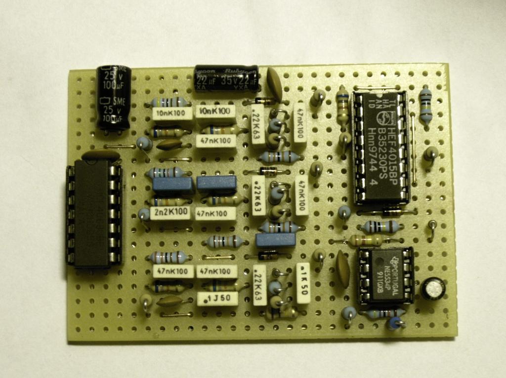

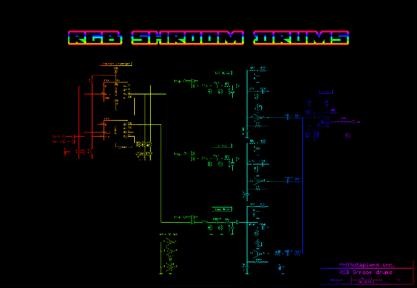

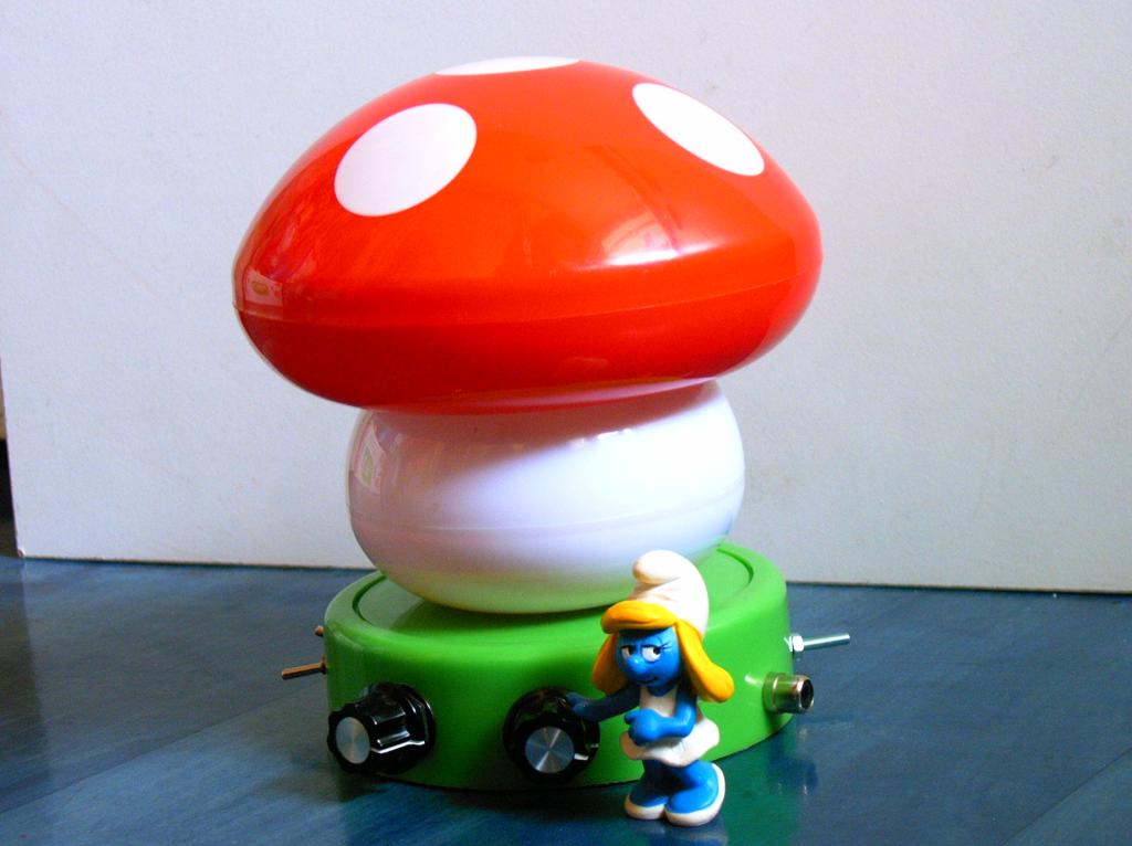

I finished the RGB Shroom drum and had some fun with it yesterday (will post a part of that later). I left out the hi-hat and had just enough
room for 3 drum circuits and a shiftregister. So it doesn't have it's own oscillators, but I have the other shroom for that. The drum circuits I used
came from an old elektor magazine, which can also be found here.
I first tried a 4011 as used in the original schematic, and although it worked the output level was pretty low and there was some humming.
That's when I found that thread where bugbrand mentions using a CD4069 instead, so I gave that a try and it worked a lot better. I
experimented with some different capacitors until I had some sounds I liked and I also added a tuning options to 2 of the drums (I couldn't fit 3
pots in the mushroom). With the current values there is some self oscillation at certain settings. The bass drum actually kept oscillating
once I transferred it from breadboard to perf so I had to reduce the feedback resistor a bit (from 1.2M to 820K). I also noticed some clicks
which I got rid of for the most part with the added (shottky) diodes to GND.
The control circuit is just a shiftregister as I used for the other shroom to which it can be linked. But the drums can be triggered directly as well.
There are switches to turn each of the drums on/off but I did notice that even when they aren't triggered they still make a soft sound, which is
probably due to some noise on the power lines caused by the LED's. It would be better to use some (transistor) drivers for the LED's especially
the red one, but I simply didn't have room for it.
When I put it together it seems to work at first but I started to notice that the Synth Shroom was actually flashing a lot more then the Drum Shroom.
Which doesn't make sense because with the shiftregister linked they should behave the same although delayed. I breadboarded another
shiftregister with 3 LED's attached and that worked fine. So I tried swapping the chips but no success. I also tried pullup/pulldown resistors
and at some point I had my scope attached to it and that made it work So I managed to solve the problem with a small capacitor connected
between the data input and GND. I'm not sure what caused it, it might be a combination of noise on the power line and the voltage drop on the output
caused by the LED, but it works now
