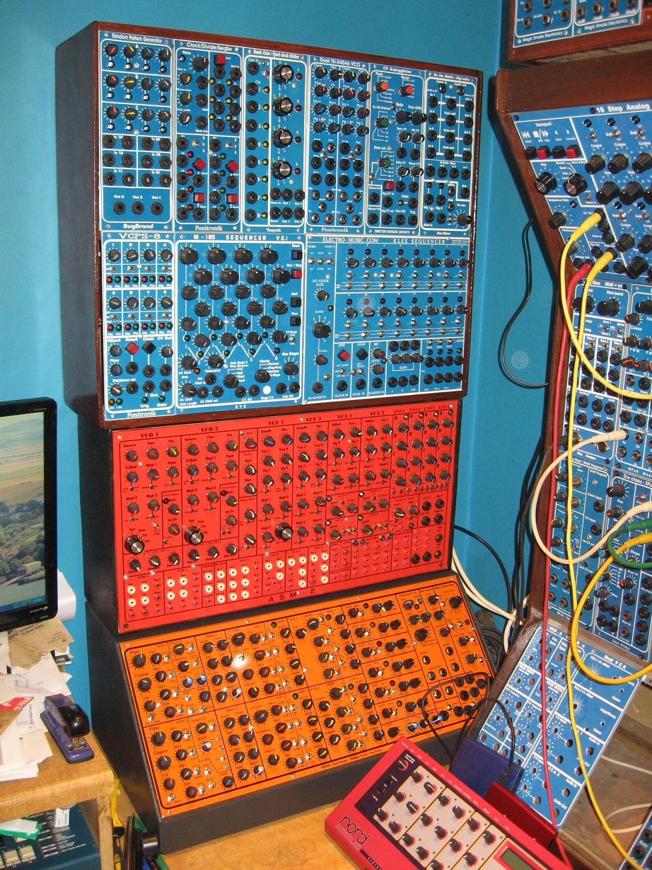

Hullo , got a chance to get back to working on the new synth Smile
Fitted two 70mm air vents , that should help the 3 regulator's heatsinks get some fresh air, fixed the sample & hold too (wire mix up Embarassed )
Just need to record and post some sounds from it Very Happy

PostPosted: Tue Nov 12, 2013 11:38 am    Post subject: Reply with quote  Mark this post and the followings unread
Hullo
Jammed out some more sounds with my Mfos sequencer & Keyboard (korg-X5) into the Poly-DAC 4voice midi to cv converter for some transposed sequences Very Happy .
Sounds 1 - Sequencer & Keyboard vco2 through vcf2 highpass / vca2 to FX600 Flanger.
Sounds 2 -Keyboard vco1 through vcf1 / vca1 to FX600 Chorus.
Sounds 3 -Keyboard vco1 sub through vcf1 / vca1 to FX600 phaser.
Sounds 4 -Random sequence vco1&2 vcf1 / vca1 to FX600 Delay.
and a pic of the new synth nestled into it's tower Very Happy
Dave.
