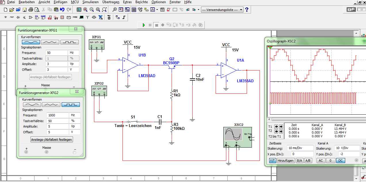

PostPosted: Wed Feb 05, 2014 4:27 am    Post subject: Reply with quote  Mark this post and the followings unread
some simulation
TL07x
 Filesize:  108.54 KB
 Viewed:  649 Time(s)
LM358
 Filesize:  107.52 KB
 Viewed:  555 Time(s)
JingleJoe
Joined: Nov 10, 2011
Posts: 878
Location: Lancashire, England
PostPosted: Thu Feb 06, 2014 5:28 am    Post subject: Reply with quote  Mark this post and the followings unread
beep wrote:
The op amp charges the capacitor up? YEES! That fits perfectly to what
I'm hearing. And a TL072 wouldn't do that?
I know there are other opamps around 3€ rather than 30 cents
and they have even higher input impedance
To elaborate; the lm324/358 has a pnp transistor input, and current flows OUT of the base of a pnp transistor so a tiny amount of current flows out of the input (nice and confusing, eh?).
TL074 op amps have FET based inputs which, if I remember rightly, theoretically have no current flowing in or out of the input. In reality there is a small amount but it's orders of magnitude lower than the LM324.
You can go one better still with something really high end like a CA3140E, I hear the TS912 is really good aswell.
Hey fantozzi, do those circuits work as well in reality? Wink
