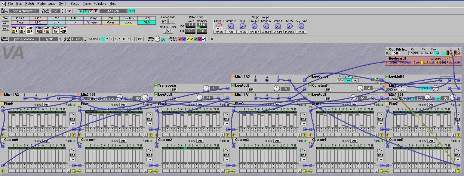

Can I use the Scala G2 tool patch (.phc2) for interbus slot patching ? Control the pitch on a synth to another slot ?
Not working with a "NoteSend" module linked to another slot. I tried this too :
Slot1
The output cable from the Mix1-1A1 in a new "2 outputs" module (Left In) and the gate from the "Keyboard1" module in the "2 outputs" module (Right In). I select BUS 3/4 on the "2 outputs" module.
Slot2
On the synth slot I create a new "2 Inputs" module. Select Bus 3/4. Left side go to "pitch oscilator in" and right side go to the envelope AMP gate.
The pitch move like a lfo or legato mode when I play keyboard. Can I have to convert the signal before to connect it in the OSC pitch input ?
EDIT : I cleaned the patch above to make it clear. I just need a tip to dig to understand the problem. Is it an issue about interslot (DSP) latency that I can fix with a delay? Or an issue about the amplitude from the signal ?

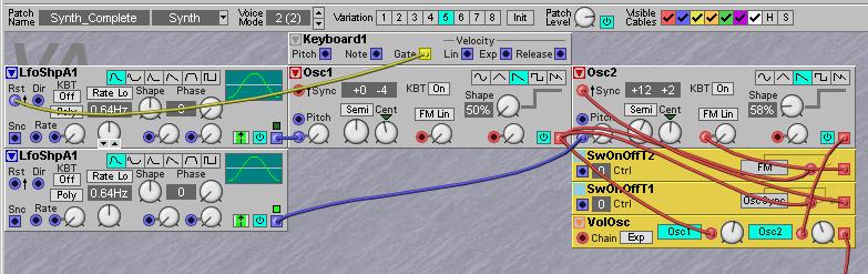

Electromagnetic Wave wrote:
...I want to understand something else. How to increase the resolution...
Yes, it appears that the pitch inputs of the oscillators quantize the signal to the nearest 1/128 of a semitone, even though the G2 system can produce control (pitch) signals much finer than that.
But, the G2 oscillators with an FM input can produce finer pitches in between this limit if you patch a pitch control signal into the FM input. I use this trick to get a very fine pitch detune that cannot otherwise be produced by just setting the Cent knob alone.
So with clever patching of pitch control signals into the FM inputs of capable oscillator modules, you should be able to get a much finer pitch offset than can be had by patching the Scala module signals into the oscillator pitch inputs.
Too bad that not all G2 oscillator modules have an FM input though Rolling Eyes

the G2 buss can only pass one signal value at a time
This is not the first time that the voice mode is causing me a headache. I've had a similar problem when I converted some NM1 patchs for the G2.
Thank you! I just tried and it works well. But this is a parameter that I automates all the time to vary the timbre (as in the screenshot, the wellow part) in my synth patchs. I need to dig to fit all this.

PostPosted: Fri Jan 10, 2014 8:58 am    Post subject: Reply with quote  Mark this post and the followings unread
I was wrong. The pitch is controlled from the Osc1, not from the Osc2. It works.
