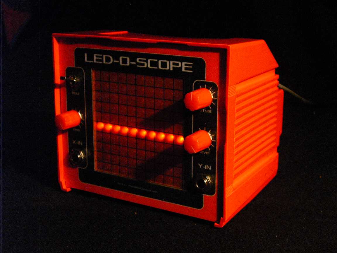

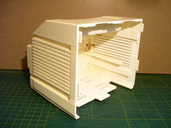

In 2012 I used a mini portable TV to create the Dronoscope and I kept the backcover of the TV for some future use, maybe for a synth or something.
I came across it again while looking for a suitabe housing for a project and when I saw it I got the idea to combine it with something else I had still
laying around: a 10x10 LED matrix that I soldered up > 10 years ago.
Originally I made it to be used for an audioscope circuit using 2 LM3914's, but I never got to that (probably because the LM3914's were too expensive).
So I looked on the web for some inspiration for what I could use it for which led me back to this site, and this thread where Fenris posted the following
schematic:
So I gave that a try it and worked pretty well. Very Happy
But the input needed some boosting and I wanted it to be usefull with AC and DC signals (positive and negative), external time (X) input, a better
offset control and see if I could make it somewhat useful to measure a voltage too.

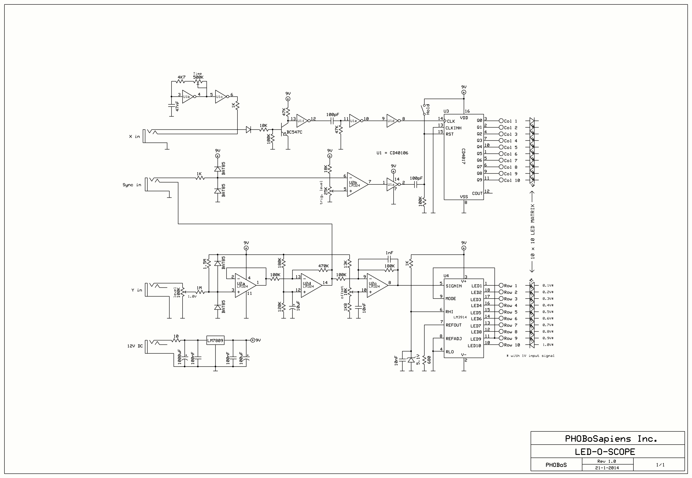

X / time section:
I started with an oscillator made with a 40106 followed by another inverter as a buffer. The output is connected to the switch contact of the X-in
jack, buffered by a transistor (so it can be used with lower input sgnals) and then turned into a pulsewave which is fed to the CLK input of the 4017.
I used the reset input for the hold switch instead of the clk enable input so when put on hold it will always stop on the first column. The sync input
was added because I had a spare opamp and inverter and it's made with a comparator buffered by the inverter to get a clean CMOS signal. This is
then turned into a short pulse to reset the CD4017.
Y / input signal section:
There's an attenuator on the input for a wide voltage range, followed by a voltage divider which pulls the voltage up. This way AC and negative DC
voltages can be used aswell. I added diodes for protection but they're probably not necessary with the 1M input resistor. The signal is buffered
by opamp u2a and then amplified (+ inverted) by opamp U2d. According to the dataheet the LM324 can swing between 0V and Vdd-1.5, so with a
9V supply that woud be 7.5V, I choose 7V to be sure and biased the opamp at ±3.5V. The signal is then amplified some more by opamp U2c
and this one also has offset control. The offset control is needed for negative DC and AC signals and there's also some offset change when the
input signal is attenuated so that can be corrected aswell. There also a capacitor in the feedback loop to create a lowpass filter which is mostly
there for when it's used as an audioscope. But it also creates nice vertical lines on squarewaves Laughing The output then goes to the input of
the LM3914 that is set to a range of 0..5.1V (zenerdiode).
There's a 9V regulator on the DC input to provide a stable voltage and to make it somewhat useful to measure a voltage I made it so that with an
unattanuated input signal the full range is 1V, and there's a difference of 0.1V between every row. But I'll probably use it as a nice audio visualizer
most of the time Shocked
LED-O-SCOPE schematic
 Filesize:  84.87 KB
 Viewed:  809 Time(s)

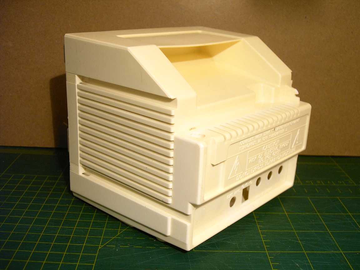

TV housing
 Filesize:  62.88 KB
 Viewed:  431 Time(s)
TV housing
 Filesize:  72.24 KB
 Viewed:  398 Time(s)
LED-O-SCOPE front
 Filesize:  67.84 KB
 Viewed:  433 Time(s)

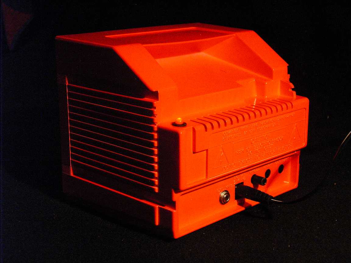

LED-O-SCOPE back (with sync input and trig. level control)
 Filesize:  68.61 KB
 Viewed:  401 Time(s)

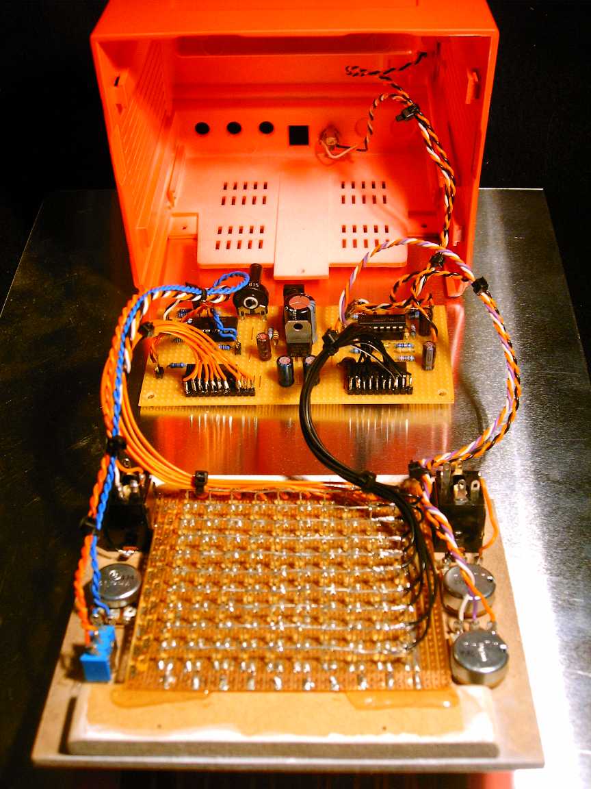

wiring pic and some animated gifs Laughing
wiring pic for RingMad
 Filesize:  106.53 KB
 Viewed:  457 Time(s)
