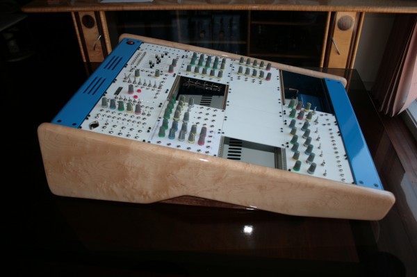

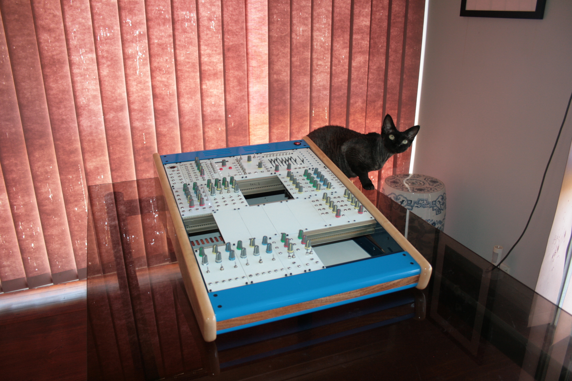

work in progress - small euro console
maple , blackwood and ally
top row- hexinverter midi 2 cv , 4ms scm/rcd, triggerhappy,
tombola RLS(modified), RLS voltages expansion (my own version of that )
proposed dual logic module quad AND-XOR (waiting on board proto's
2nd row- barton arpegiator, hexinverter postman EG, space for frequency central loop env eg's and wave rider LFO's( on there way Wink )
fonik attenuvertors x 5 , fonik dual cascadable dc mixer , my own dual quad unity gain mix / quad distro
third row- space for 5 vco's probably digital thinking 4 of wsy's fm operators and a frequency central digital vco , 2 x barton quad mix vca's
fourth row- 2 x L1 mutant filters, 2 x LM4250 rev 5 filters , space for 2 more vca's probably yusynth and either pt2399 based delay's and/or a reverb to fill it out.
still need to sort power supply as well [/img]

Nice work Smile

Smooth cheeks you have there Wink , very nice looking synth , Diablojoy .
Are you still going for a big RAW DC main power unit using your large 35A bridges you picked up , distributing to lots of regulator busbars , if you need help give me or phobos a shout , our RAW DC power substations are still sort of relatively fresh in our memories Very Happy .

hope the black cat didn't mark it's territory , it's got a suspicious look on it's face. Very Happy Very Happy

Hi dave
No for this one i am thinking of trying 3-4 x approx 750mA supplies, each with their own on board torroidal transformers instead of the single large torroidal/ cap / rectifier feeding multiple regulator boards
J3RK over on muffs is prototyping a board at the moment which i hope will work out nicely.
marty is a good cat he's just sus of the camera Laughing
usually he runs as soon as i pick the camera up.

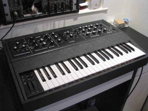

Finally finished the Minimoog clone (well, Minimoog-ish).
I cheated on the VCO's, and used Roland System M ones (Frequency Central System X, thanks Rick!) - I built the original Moog VCO (741/Tempco) and it was dreadful… So I tried the u726 version and found that my 726's were fake Rolling Eyes
Decided to take a long break from Synth DIY, as I now have what I need, but I'll keep popping in from time to time.
Thanks everybody for your help over the past few years, it's been invaluable.

orsm work yet again andy Cool
was kinda hoping you would release info on your 3620 keyboard soonish
I hope you enjoy your break and make some music with your creations
i spend too much time just building myself.

wow Andy, amazing work man!
enjoy your break, i'll miss your cool posts, please come back soon Smile

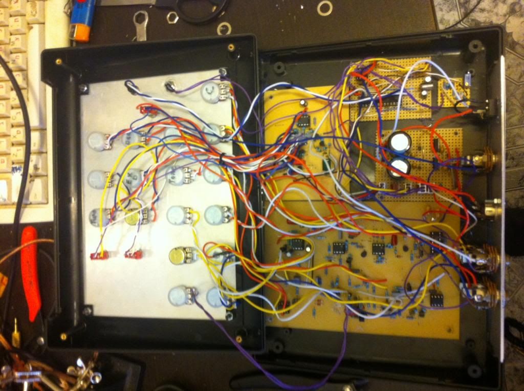

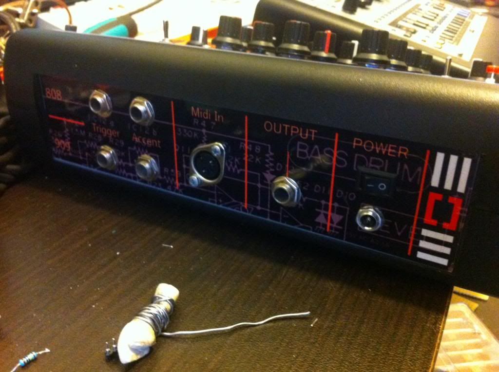

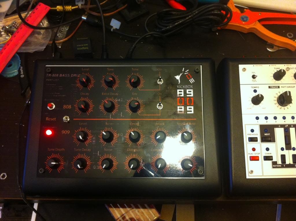

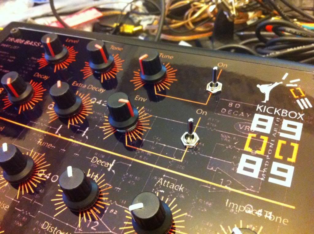

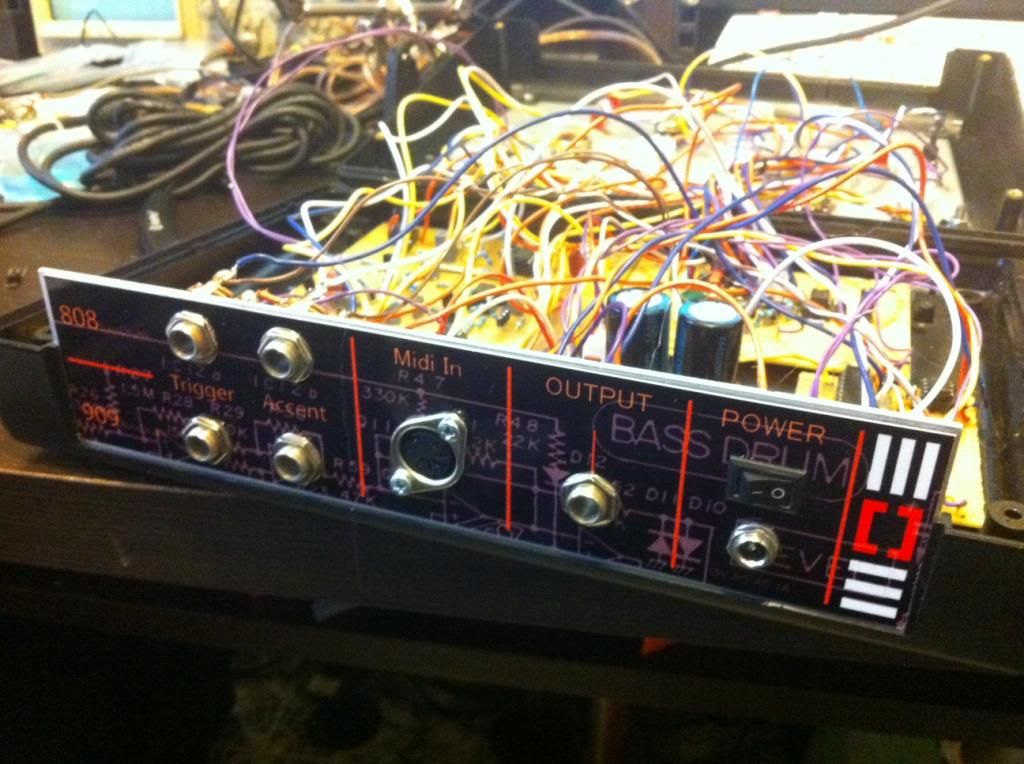

Hi Guys.
i finished my KICKBOX machine.
i took the 808 and the 909 kicks and put the in the same box named it KICKBOX, i even design a cool logo for that Smile
some pics..
the vid clip is in Hebrew, but i'm sure you'll get the point Wink
from 8:50 i'm adding my x0xb0x with some cool mods.
Isak E.

Hi Andy
that is really nice clone
thumb up
do you have somewhere more pics from that case, with lifted panel etc...?
what everything you copied so far? I remember ARP2600, did you get also Synthi?
If you will start in future with your own copy of Roland system 700, let me know I would like to participate. Although I know that with u726 is hard to find reliable supplier.

Sounds good, and nice design.

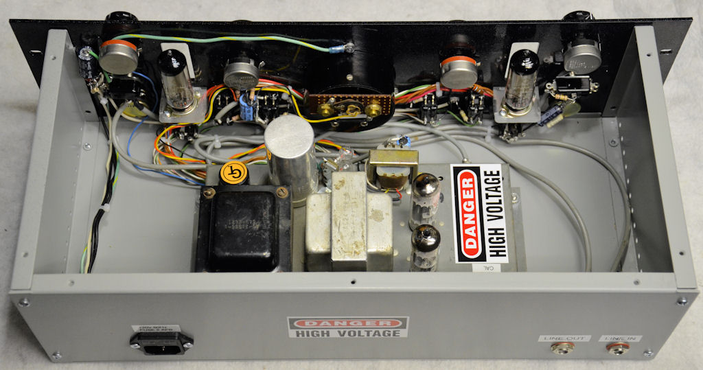

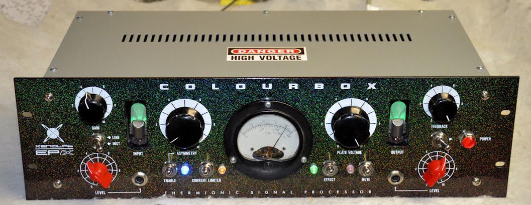

Just finished a project for a friend, the Colourbox Thermionic Signal Processor:
http://www.electronicpeasant.com/projects/colourbox/colourbox.html

nice build isak!
and loving those tubes peasant. some lovely builds happening so far this year. keep it up guys Very Happy

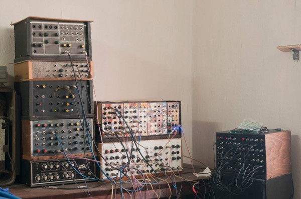

This is as far as i got with my modular , these is just a pretty pic so i thought i'd share it - not nice panels! just what i could find at the moment .. the last builds in the colorful panel from this year .. VCS ,and SOU (just two parts of it )

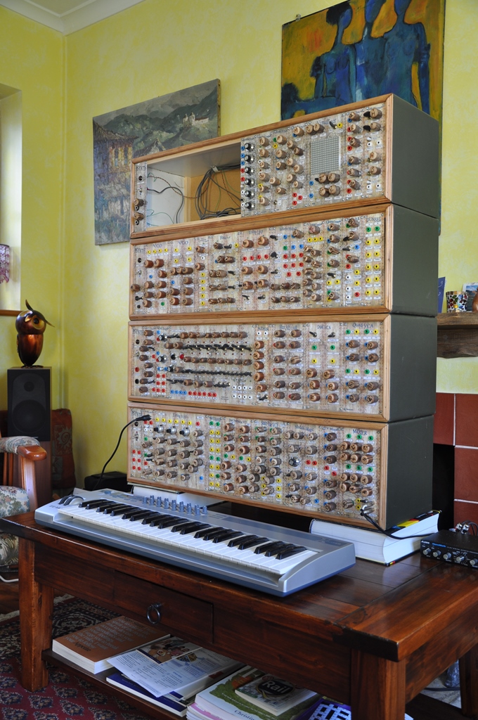

Curent state of build of my modular (in the house while the better half is away Very Happy ). Latest addition was Yusynth Sequential Router.

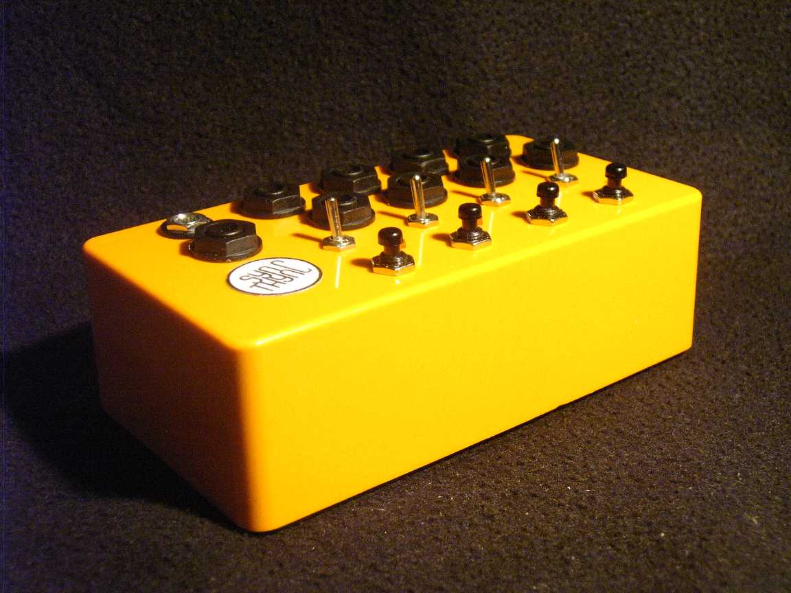

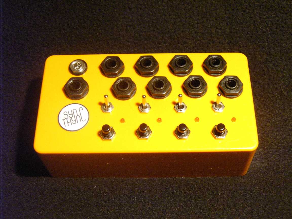

I made a Sync Thync Cool
more info here

Great builds guys, loving all the different faceplates , cool stuff Smile .
