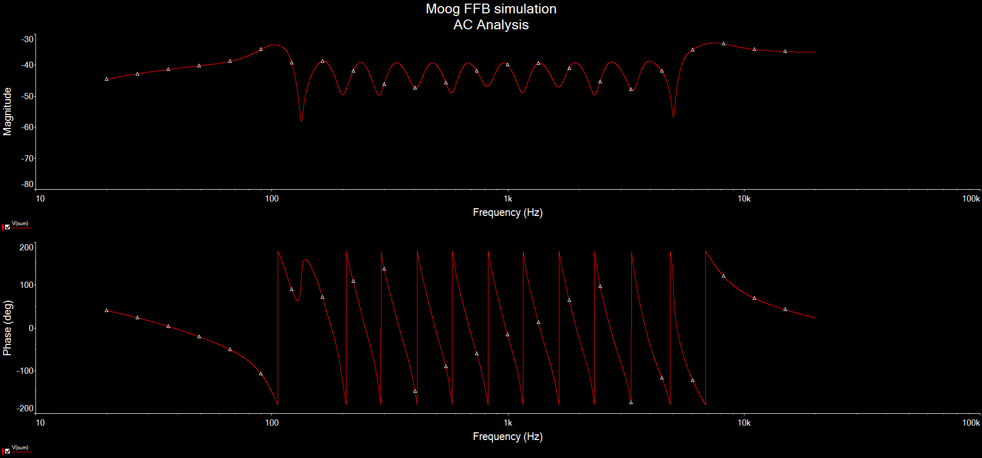

It's pretty easy to saturate the Moog output amp, so I added a clipping indicator so that I can adjust the input attenuation to prevent clipping. I also added outputs for the even and odd cells separately, each using a Moog output amplifier to maintain the same signal path as for the main output. The only difference is I added a high impedance voltage follower in front of the Moog amplifier so these extra output stages don't load the filter cells and change the behavior.

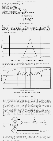

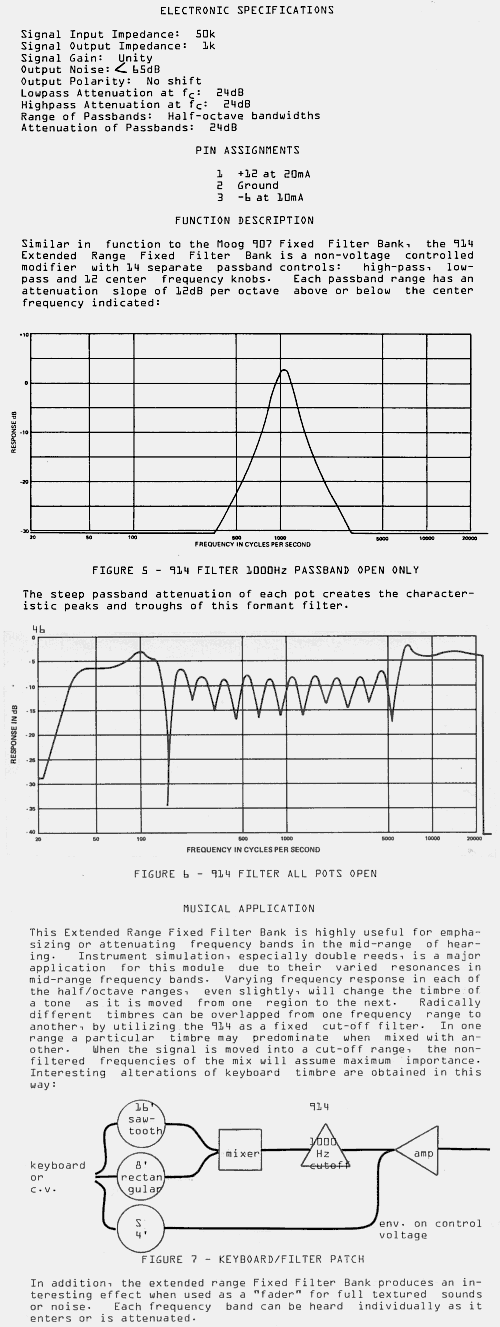

I'm attaching the current MultiSim model as well as a shot of the AC response, as well as the Moog published response for comparison. I think it's a good match. The "Q" of each cell is around 2.7 to 3.0 give or take and I think the relative gain and output is good.
I'm just going to be laying out the PCBs now, so prototype is about a month or two away.
Here is a screen grab of the AC response of the Multisim model for comparison to the Moog published response.
 Filesize:  189.61 KB
 Viewed:  561 Time(s)
Moog published response of the 914 will all pots open
 Filesize:  54.72 KB
 Viewed:  557 Time(s)

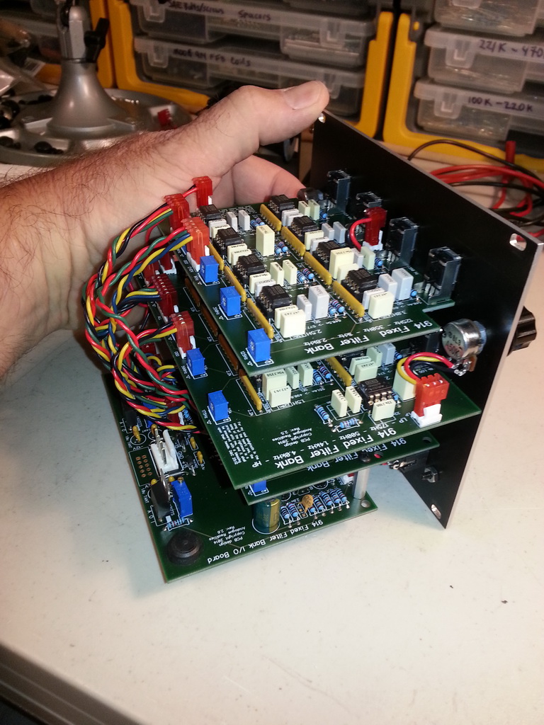

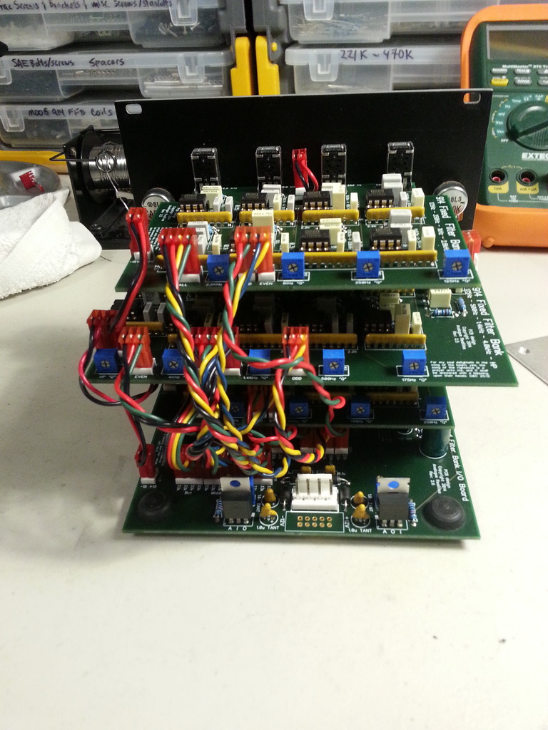

Time for a quick update.
I got a prototype all built and discovered inductors will do what inductors do and pick up every stray EM field in the universe! Smile Seriously, I puttheh prototype in my cabinet and discovered I can't move it far enough away from my open frame PowerOne power supply transformer to eliminate the hum. Sigh...
Despite the excellent inductors from Carsten Tonesmann (many, many thanks Carsten) I find I need to abandon my hope of an inductor clone of the 914. The cost and effort of a new power supply system and/or cabinet and rack redesign is far more than simply using a GIC paradigm which should be a very close emulation of the inductors minus the annoying "cons" of a real inductor.
I have now completed a layout for a GIC based unit using a GIC for each of the grounded inductors and a "back to back" GIC for the floating inductors in the low pass circuit. Circuit boards should arrive next week and I'll post the results. The simulations are very encouraging.

OK, almost done. I'm waiting on the last iteration of the PCBs which get rid of all the input/output attenuators so I can actually spread out the controls more and actually grab the dang knobs and turn them without turning all the adjacent pots at the same time.
I'm attaching a first cut at the response plot. Note the fall off on the low end. There is a high pass filter with a cutoff of about 60 to 70 Hz on the input to the final amplification stage. After some discussion on the sdiy mailing list, I think it was added to the 914 (it isn't in the 907) to eliminate low frequency and sub-audio rumble to clean up the bass. But what do I know? Smile
So far as the sound, I'm very pleased. Side by side with Yves' version, they sound very much the same. I haven't formally "calibrated" it. I'm waiting for the final PCBs, but the trimmers seem to adjust the "Q" just as expected.
When it's done and really working, I'll post the DipTrace schematic, PCB drawings, and BOM for anyone interested.
David

OK, after many, many hours and lots of prototype PCBs, I think I have a good handle on the filter. I just ordered what I hope is the final revision for PCBs for the GIC version. I went to some very extreme measures to minimize outside noise and hum pickup, like a 4 layer board, ulta low noise op-amps (OPA2227), etc. I think I can safely say any noise is due to the original filter design. I think the inter PCB connections carrying the summed output signals may derive benefit from shielded wires due to the low levels from the resulting summed filter cell outputs.
For comparison, I did some quick "ear" checks against my Yves Usson 914 filter clone and I was very happy. I'll work on some more analytical comparisons over the next week or so.
I need to think about the Inductor based version a bit more, but I think I have the final version of those PCBs ready to go, too. I will buy a set of last prototypes soon and will post here as soon as I have them built.
David

Done...
Here are photos of the GIC version. I should have the final prototype inductor version tomorrow and I'll stuff as soon as I can. Work is ramping up and I'll be pressed for time. I think the low pass is a little hot, but that can be adjusted by making the summing resistor bigger. I'll try to get audio and a spectrum analysis posted as soon as I can make time.
