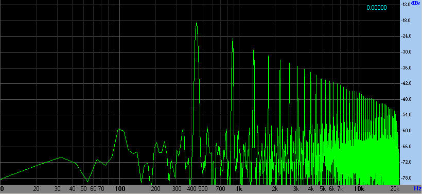

OK, I decided to go with PolyBLEP because DPW doesn't work very well with FM/PM. Attached are spectrum screenshots of the regular saw oscillator and HrastOsc, both at 440Hz (WREN is running at 44.1kHz samplerate) Very Happy
It will be a combined saw/pulse/ramp oscillator. Bandlimiting is configurable so you can achieve even less aliasing at the cost of loosing some brightness.

Looks like you broke the mirror Shocked Laughing
What do you use to make such nice spectrum plots?

PostPosted: Mon Mar 31, 2014 6:17 am    Post subject: Reply with quote  Mark this post and the followings unread
Visual Analyzer
http://www.sillanumsoft.org/
Indispensable tool when working on software like this, I used it all the time while developing Tranzistow ...
