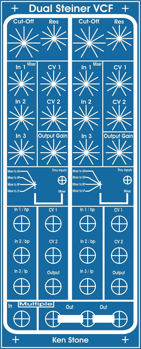

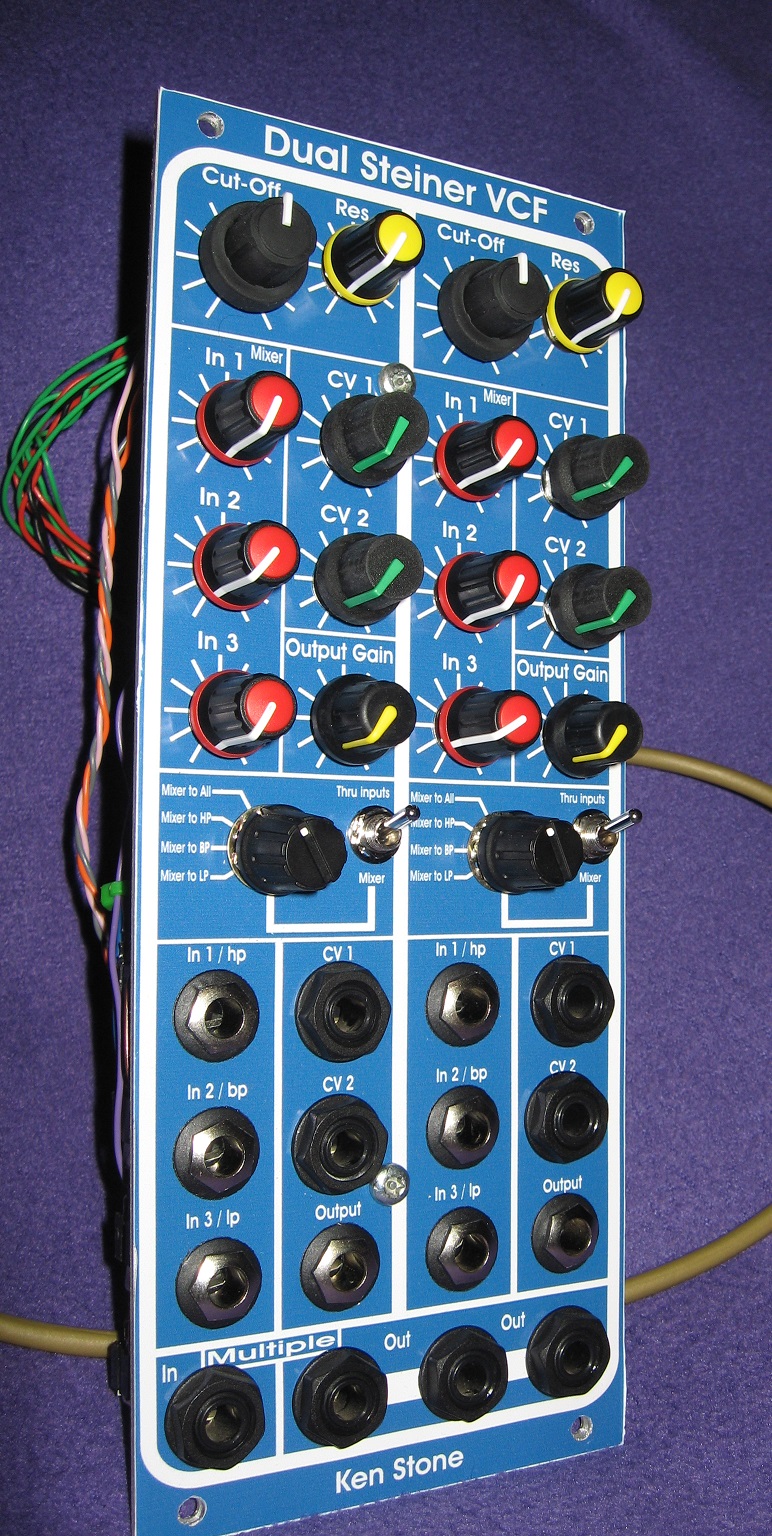

Hi there , while finishing the panel design for my CGS89 sequencers I thought I would try some ideas for the panel for 2 CGS35 Steiner vcf's , and get the 2 designs done at the same time at the local sign / printers shop.
After a few mock up designs , I've settled on this layout Smile .
I had a look at some great looking diy CGS35 modules just doing a pic search , most having either 3 separate inputs for the HP in / BP in / LP in or a single input with selector rotary switch .
After a coffee & a blueberry muffin Smile I sketched some ideas for inputs , using a 3 pole / 2 way toggle switch (middle of the panel under the pots) ,in the up position, set to "Thru inputs" in1 goes to HP / in2 to BP / in3 to LP .
Switched in the down position,"mixer", it connects to a 3 pole 4 position rotary switch, where pole A goes to HP / pole B to BP / pole C to LP , the rotary will be wired to send a sum mixed out of the 3 inputs to all or each individual vcf in.
.....And I had room for a handy 1 in / 3 out multiple, Smile .
here's the first blue panel layout ,this design may get some adjustments before printing at the shop Wink .
Dave.

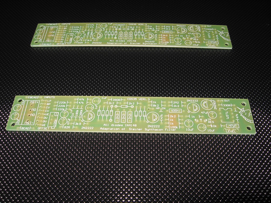

PostPosted: Wed Apr 16, 2014 9:41 am    Post subject: Reply with quote  Mark this post and the followings unread
bare boards....

PostPosted: Wed Apr 16, 2014 9:56 am    Post subject: Reply with quote  Mark this post and the followings unread
Quick text fix on the input sockets....
Panel V2.

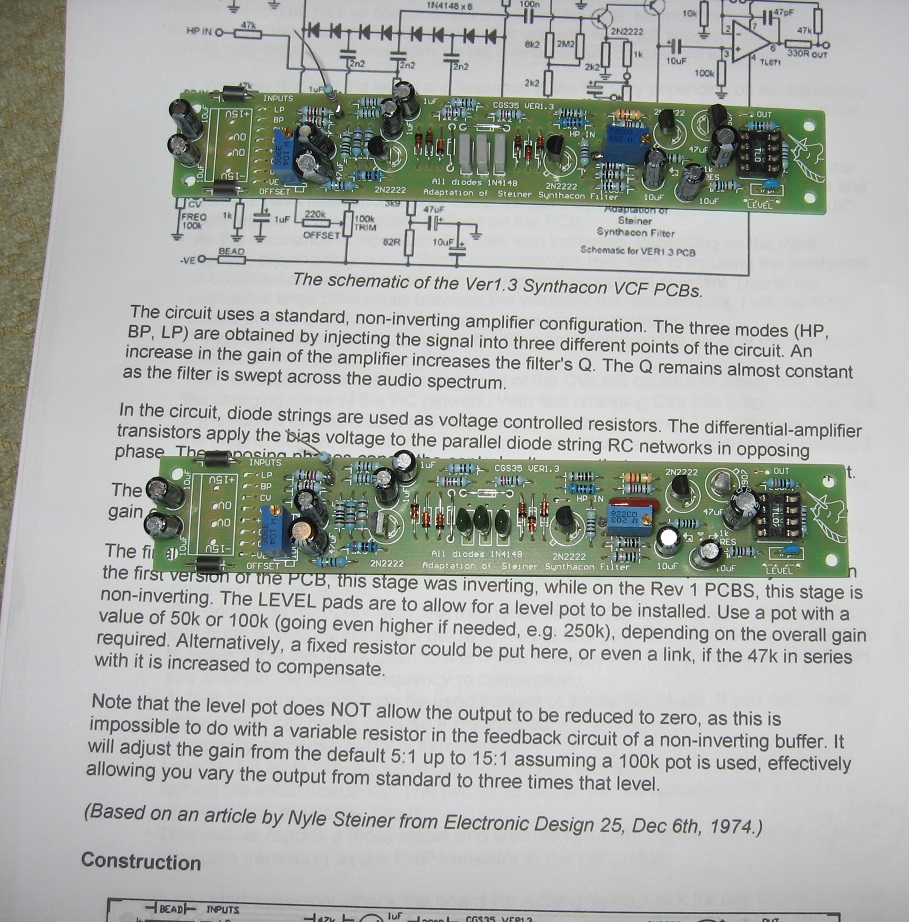

PostPosted: Mon Apr 21, 2014 6:51 am    Post subject: Reply with quote  Mark this post and the followings unread
2 boards stuffed with components now.
The supply will be my usual +/- 12V, reading the documents, I have wire linked the 2 diode positions with the rings round them.
The panel sticker is due through the week , tho I think I will finish the gate sequencers first.
Dave.

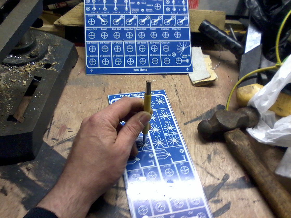

Hi , Tackled a bit more of this module last night Smile .
Panel is now drilled / stickered / pots 'n' sockets on , boards wired .
I just need a couple of 1K pots for the res. controls , I'll order them while i'm at the wiring stage Smile .
Dave.

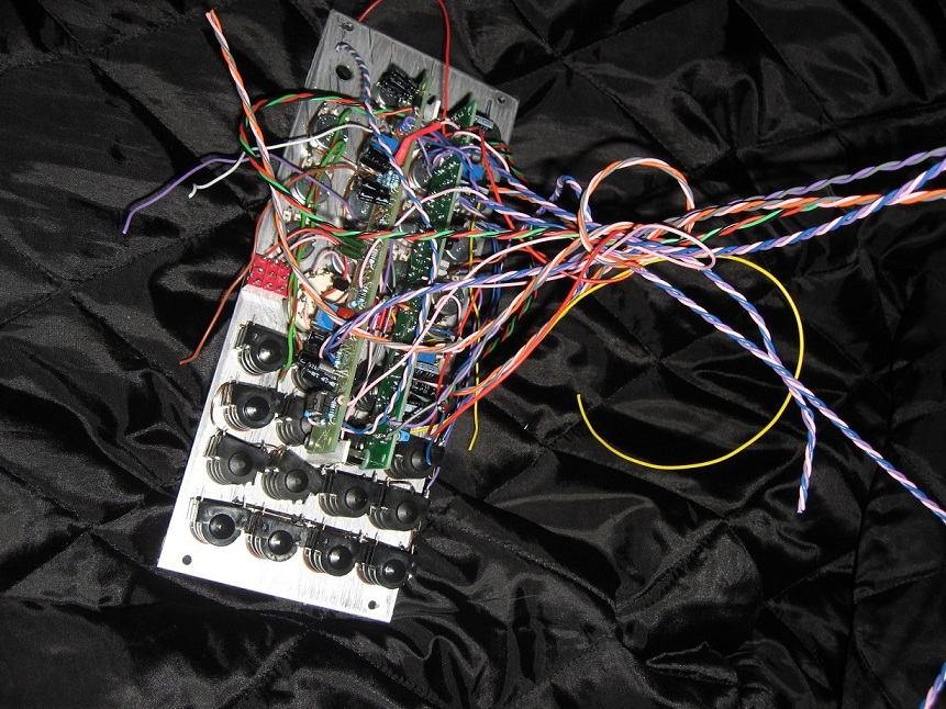

PostPosted: Sat May 10, 2014 6:22 pm    Post subject: Reply with quote  Mark this post and the followings unread
At the wiring stage now , hope to have this working by next weekend Smile .
Dave.

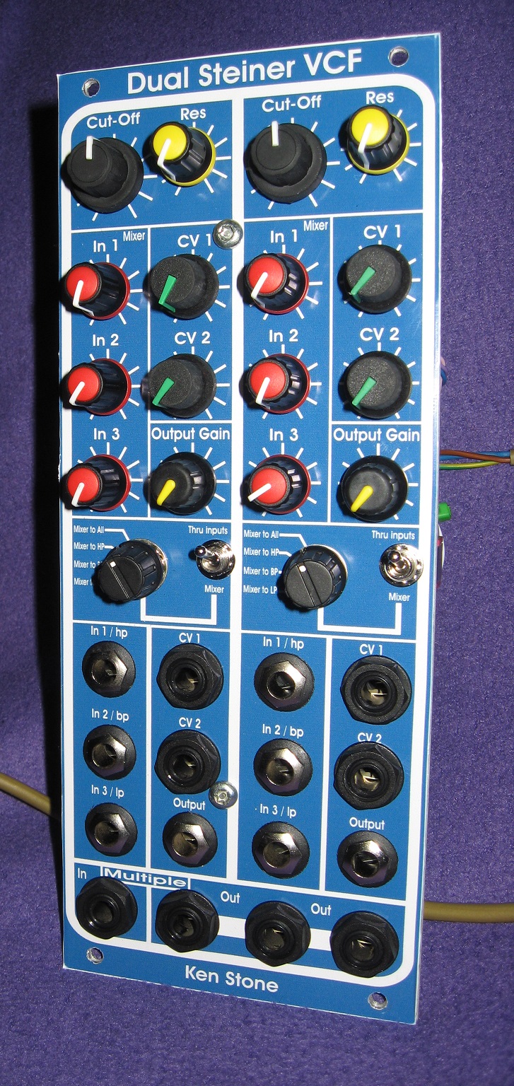

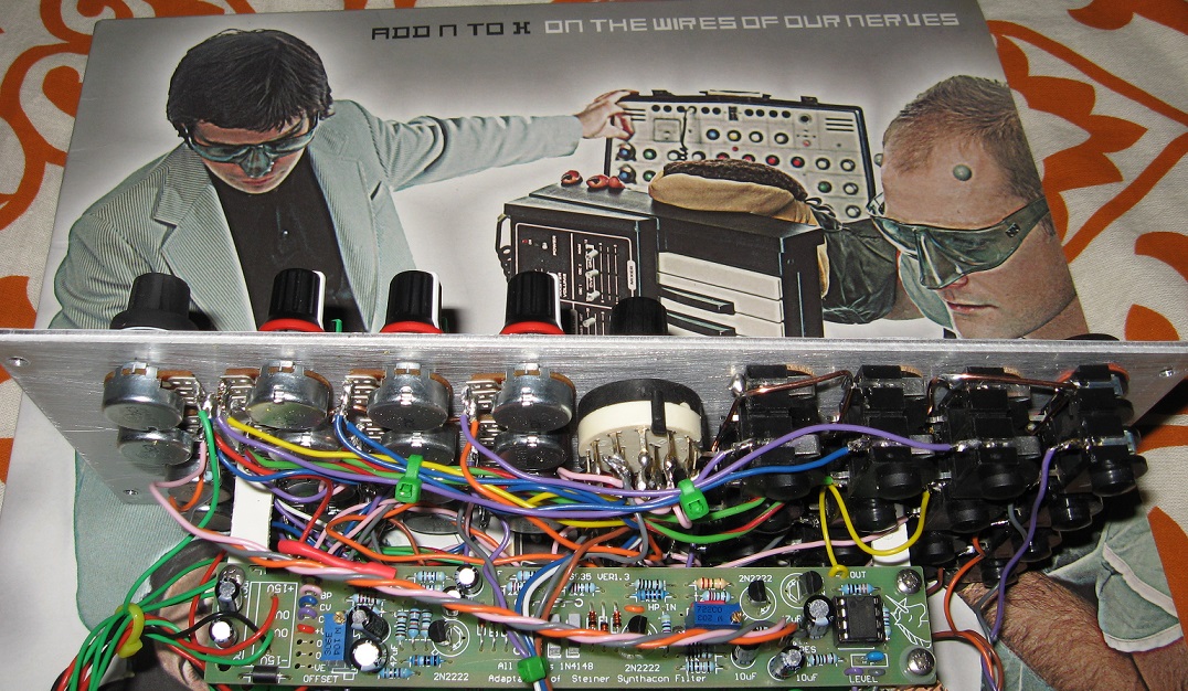

PostPosted: Tue May 13, 2014 9:38 am    Post subject: Reply with quote  Mark this post and the followings unread
Hi again Smile
Module now wired & front panel finished , Tested the supply cables & powered it up without chips first, then power up with chips , all good so far .
Just need to set up the cv trimmer for the cutoff action and also set the trimmer I put in instead of the 2K2 in the resonance area.
I used 2N3904 for npn on one vcf and 2N2222 on the other vcf , both have 2N2907 for pnp ,the 2 vcf's sound pretty similar , but I've used up what was in the component drawers Smile .
For the audio inputs I have a level pot for each hp/bp/lp inputs , flicking the toggle switch makes them act as a 3 input mixer ( veroboard simple mixer) the rotary switch sends the sum of this mixer to - all pass/hp/bp/lp .
Some pics below and sounds to follow through the week after I've set the trimmers Smile .
Dave.
