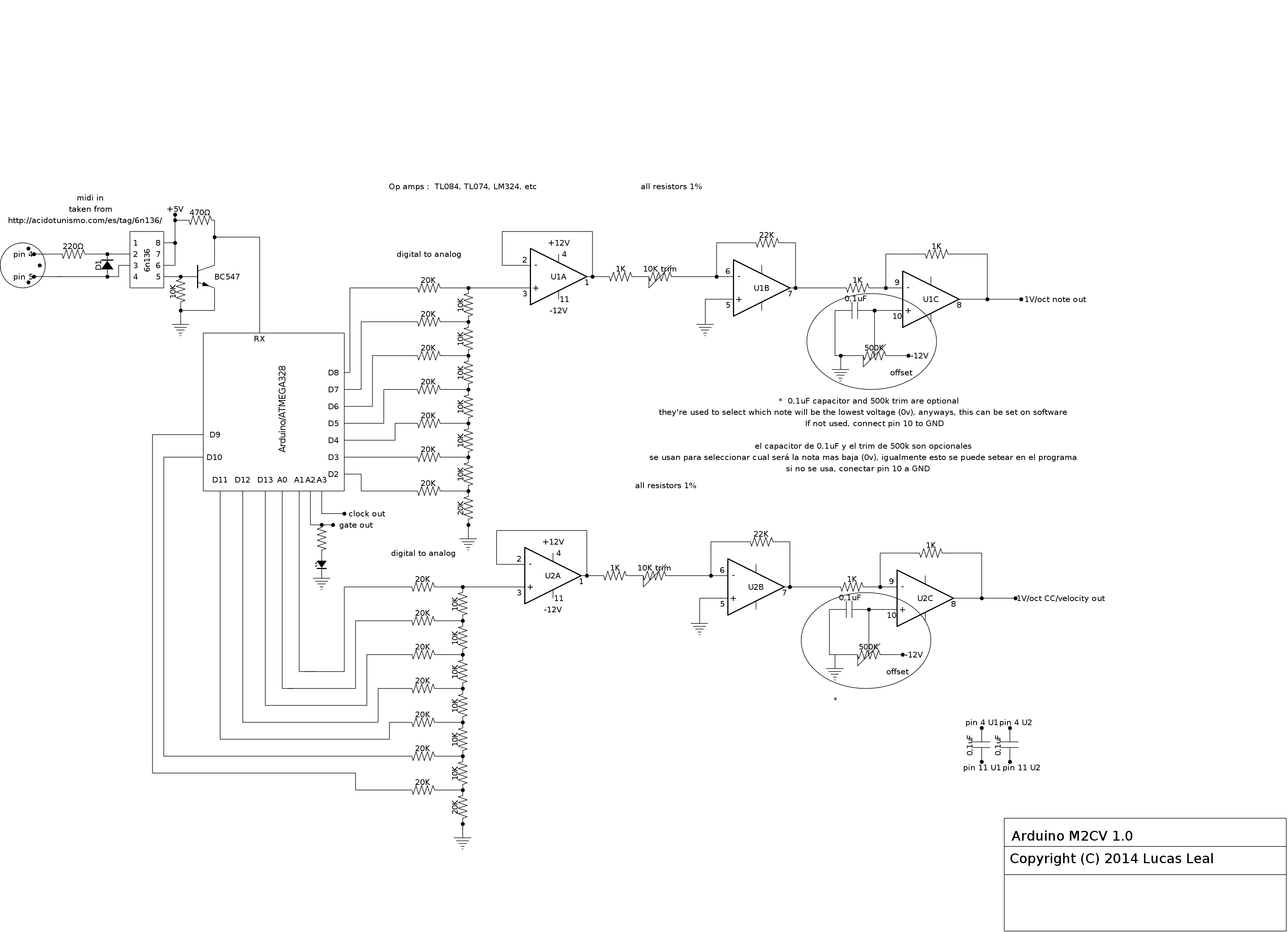

Hello. So the last week I designed this midi 2 cv with arduino. It makes use of two R2R 7bit dac. Inexpensive and easy to build. Here in my country it's impossible to get dacs from Microchip or Maxim. The only ones we can get are the 083x dacs, they're very expensive here, and also sometimes it's hard to get them.
So... i decided to build an R2R dac.
It works fine, i didn't match the resistors, they're 1%, I suppose if they're matched to 0,1%(or maybe an array of resistors) it'll be better. But I measured it and it was pretty good.
I share it with you.
I didn't add the clock part yet, although i already programmed it and tested it on another device, if anyone is interested in this feature I'll add it.
Any suggestions are welcome. The next version will be polyphonic

what is the voltage range of the cv behind the OPamps?
capicoso
Joined: Nov 19, 2012
Posts: 128
Location: Argentina
PostPosted: Wed Apr 30, 2014 9:02 am    Post subject: Reply with quote  Mark this post and the followings unread
the voltage at the dac output range from 0v to 4,96v. At the opamps output it's 0v-10v

You can also set the PWM outputs to 60kHz and use them with a low-pass filter that has a high cutoff. That gives you an 8bit resolution.
I tested this with a Monotron and it worked well.
But the Monotron is only 0-5V. I don't know how useful 8bits of resolution will be across a 10V range. Have you tested your 7bit solution with an oscillator?
capicoso
Posts: 128
Location: Argentina
PostPosted: Mon May 05, 2014 5:01 pm    Post subject: Reply with quote  Mark this post and the followings unread
I thought PWM wasn't accurate, before building this one, I googled a little and the result wasn't very good for PWM, but that was with stock PWM, not at 60KHz.
I tested it with a yusynth vco and it was fine, however, I'll also build one with dac0808 , this one is cheap and not so hard to find here. At least for the note cv, i'll compare them.
Then if everything is fine i'll build it with 595 shifters and make it with at least 2 note cv outs. I need it for my 8x2 sequencer, so i'll do it with different midi channels
It doesn't behave in a 1:1 ratio, probably in part due to the lowpass filter, so I had to tune the PWM setting for each MIDI note. It took a while, but I only did it across a five octave range.
It was a while ago that I tested it, but I think I got up to the highest A# before the voltage was limited and the tuning went flat. Also, the lowest C had to be set to change the PWM output to a digital OFF because the PWM can never get down to 0V.
It wasn't perfect, but it did the job for a 0-5V range with a Monotron, which isn't too great at staying in tune anyway.

I breadboarded this circuit today and it's pretty great. I am experiencing one problem though, I seem to be getting stuck notes every once in a while. It happens more often when I am playing fast notes. I'm not much of an Arduino buff so I don't know where to begin to fix this issue. Any suggestions?
Cynosure
Joined: Dec 11, 2010
Posts: 1025
Audio files: 82
PostPosted: Wed Jun 04, 2014 7:37 am    Post subject: Reply with quote  Mark this post and the followings unread
That can be caused by many different things. Here are some steps on how to fix it.
1. Check your midi connection. Make sure that there are no loose wires. If you are using breadboard, then consider soldering together at least the midi portion of it for the remainder of your testing.
2. Optimize your code. If you are doing too much and using up too many cycles in your main loop where the midi is handled, then you will run into this problem. In addition to optimizing your code, also only do things as often as is necessary. For example, you probably don't need to read all of your pots every time your program runs through the main loop. Read just one of the pots every 5 or more times that the loop runs.
3. Connect your controller directly to the arduino. Routing it through a computer and DAW can cause issues. Some DAWs will bunch up midi messages and spit them out in batches. This overloads the buffer in the arduino.
4. Increase the rx input buffer. I think that the default size is 64, but you can increase it to 128. You need to edit a file that the arduino compiler uses. I don't remember the name of the file, but you should be able to find it if you search the arduino forums.
One other thing that probably isn't this problem but that you should consider - your code should handle both NoteOff and notes with 0 velocity as note off messages.

Hey.
The only problem I found that i'll fix it when i have time, is that when you play in legato, for example, note 60 and then 62 without releasing 60, when you release 62, it'll still send the voltage for 62 and not 60. I didn't mind because this is for my sequencer, and it's monophonic so this never happens. But i'll fix it when asap and also add the clock out.
Glad you like it Benjamin. Could you be more specific with your problem? Maybe it's because the bug I mentioned earlier? The legato thing. The gate gets stuck? Or the cv out? When it's stuck on a note and you play another one does it change?
It should work with arduino nano yes, if it's the atmega328 one 100% sure. If it's the 168 i'm 99.9% sure Smile . The ram on the 168 is only 1k, my code uses very little though.
The file to edit the input buffer is the hardwareSerial if i remember correctly, however, look at your ram usage.
By the way, acording to my code, it should handle both noteoff and noteon velocity 0.
this responds to note off message:
