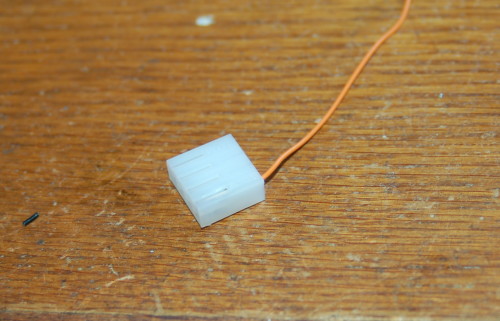

etaoin
Joined: Jun 30, 2005 Posts: 761 Location: Utrecht, NL
Posted: Mon Nov 26, 2007 2:39 am Post subject:
| Randaleem wrote: | | What do you use to crinp the wires to these connectors of yours? Do you solder them? |
I put the pin in a small vice to hold it steady and add a little dab of solder in the middle to hold the wire, then solder the wire and crimp the end using needle nose pliers.
it's a "good enough for me" type of connector  _________________ http://www.casia.org/modular/ |

etaoin
Posted: Mon Nov 26, 2007 4:28 am Post subject:
And as I needed to make some anyway:
| Description: |
| Header pin in vice with a bit of solder |

| Etaoin wrote: | | And as I needed to make some anyway: |
Hi again, Etaoin. I'm glad you posted these. Your pic, header 3 shows detail I'd missed in your earlier connector pic. You DO have 3 side contact with the pin with these. Excellent. Good enough for anybody, I'd say!
FWIW, Waldom/Molex makes an inexpensive yellow-handled pliers crimp tool that will work on these connectors to eliminate even the soldering. Maybe 15USD ? I'm mentioning it for completeness of the information in this thread. It works really well for this type of connector.
It has W-HT1921 stamped on the nose. It also works well for the PC disk drive power connectors mentioned earlier in the thread, and for molex .063 round pins and sockets. Rolls the wire and strain relief wings of the connector just as well as a more expensive tool. Has a crappy wire cutter/stripper I never use, and a bolt/screw cutter from 4-40 to 10-32.
EDIT: http://www.action-electronics.com/molex62.htm (Many pics of connectors and crimpers, I have also the # PHT-DS-STMP red-handled open barrel crimper shown near the bottom of this page and it too works well. Between the red and yellow handled tool, nearly everything except MTA's and machined pin types is easily crimped.
Kind regards, Randal |

| Etaoin wrote: | | Randaleem wrote: | | What do you use to crinp the wires to these connectors of yours? Do you solder them? |
it's a "good enough for me" type of connector  |
hey!
AND, the same vice as me too!!
I also use a pair of flat nose pliers (which I bought for £2 in ALDI). They're not brilliant, but they work The trick is to bend one flap (sorry can't remember the term used) over, then bend the other one round the first one- trying to avoid the 'triangle effect'- if you see what I mean?
The blob of solder is a great tip as well- although careful not to let the heat travel up the metal and melt the trapped wire's sleeve. If that happens, it looks really shitty. _________________ ACHTUNG!

frijitz
Joined: May 04, 2007 Posts: 1734 Location: NM USA
Audio files: 54
Posted: Mon Nov 26, 2007 12:36 pm Post subject:
| Rykhaard wrote: |
- I strip approximately 1/4" of the 24 guage wire
- I lay the pin with 4 wings on the desk
- I place the stripped wire portion fully between the wings
- Putting the 1/32" soldering iron tip into the space between the wings, heating the pin and wire, I add enough solder to make a full connection |
Ummm ... It works better if you strip off less wire and put one pair of "wings" around the stripped end and the other around the insulation. (strain relief)
EDIT: as in Etaoin's pics. |

| frijitz wrote: |
In that regard, you DO get more strength on the wire itself at the connection to the pin. The rear wings on my 'fake Molex' pins though, aren't long enough TO go around the 24g insulation. (Mode Electronics copy. )
I'll be looking into ordering authentic Molex pins and harnesses during my next order later this week. I HAVE crimped that way in the past, when I was using real Molex pins.
I'm okay with this for the moment as there's very little disconnection / reconnection going on. But still ...... I prefer to have as much strength in things I build, as possible. (Especially with how crappily so much in life around us is built, nowadays. ) |
