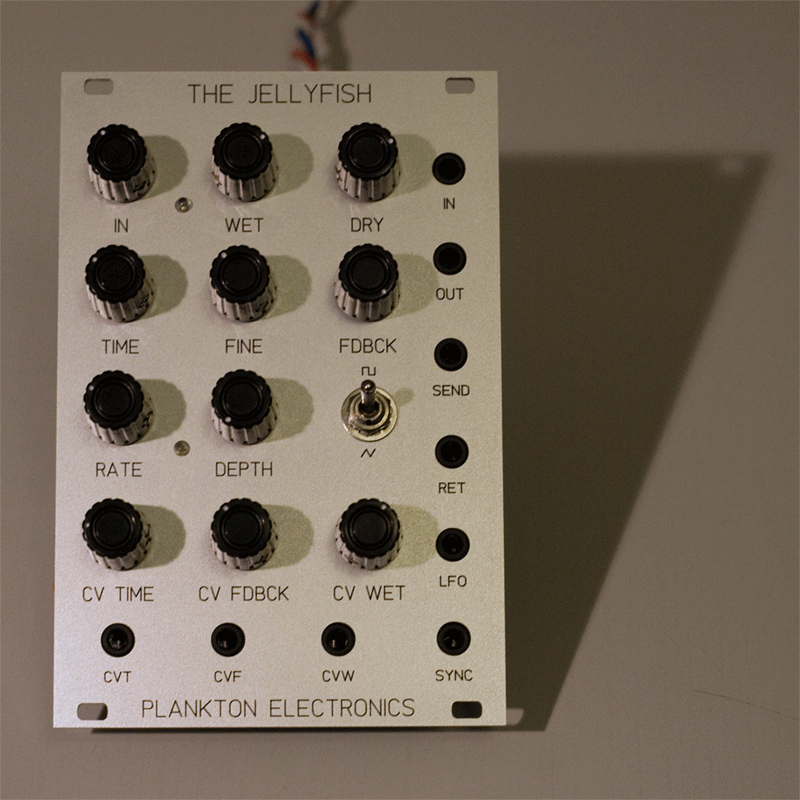

Hi!
The Jellyfish V2 Modular is finally here. Cool I'm taking preorders now. This means that I have no stock and no money for production so I will make a list of interested people and I will accept the money when I start the production, not before. This will be 2 or 3 weeks from now. Production will take 3 more weeks (for PCB, panels and stuff).
The Jellyfish V2 Specs:
- One single channel eurorack module.
- Gain potentiometer with clipping led.
- Wet and Dry controls for the mix
- Time and Fine controls for the Delay time. Delay times from 27 to 600 mseg.
- Feedback knob, from 1 to infinite reps.
- Send and Return connections for the feedback path. You can connect any effect or whatever you want here. It will affect the delay repetitions. Each repetition will pass through the chain. You can also connect more Jellyfish modules to create the "Xdelay" function of the V1. Or you can connect 2 clipping diodes for clip the reps.
- LFO with square and triangle waves directly to delay time.
- LFO output independent of the "Depth" knob.
- CV inputs for time, feedback and wet.
- Sync input! Input a clock signal here (0-5V square wave) and the delay time will be synced to it within the specs of the delay (slower or faster signals will be clocked to max o min).
- No wiring! This is a set of 2 PCB with "PCB type" components. Very easy building.
- Doepfer or screw type power connectors.
I will post video demos very soon!
I will make a well documented assembly manual. Check the website for reference of the V1.
I will post the schematics.
I will post the code for the sync function (it works with a small AVR chip).
Panel will change a little from the prototype. Letters will be thicker.
Prices:
Set of 2 PCB: 25€
Panel: 28€
Programmed Chip (Sync function): 3€
Kit: Set of PCB + components (chip included) : 110€
Assembled Module: 225€
Shipment prices will vary depending on the weight and zone. From 4 to 15€.
