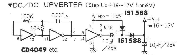

When all else fails, try a voltage doubler.
-minus- wrote:
Yes the transistor noise with the 47K and 4K7 resistors does work at 9V. I have had it working at less than 8V. You need to try different transistors of the same type and also test different types. I have had good results with 2N2222's 2N3904's and PN100's.
Thank you. My experience was with an out-of-spec 7809 that delivered 8.7V.
