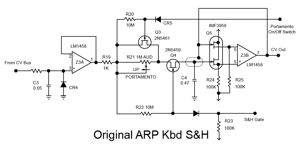

I'm having a tiny problem with the S&H section of the ARP3620 Keyboard clone I'm building - although it's working (more or less) I'm currently testing the board using two unmatched 2N5459 FETs in place of the elusive IMF3958 (or the expensive 2N3958)
I started thinking if the Dual FET business was really necessary - why not just take it out along with the LM1458 op-amp and replace the whole shebang with an LM442 or similar?
Do you think it would work? I can't see any reason why not... I just don't want to start tearing into my beautifully crafted PCB Wink
I've attached the original circuit along with what I THINK may work.
Any comments would be gratefully accepted.

Hi Andy,
This is petty much what Yves is doing on his Dual Gated Slew module.
http://www.yusynth.net/Modular/index_en.html
-Tim

Thanks for the pointer Tim, looks like I'm heading in the right direction... I'll give it a try - can't do any harm Smile

I never got round to trying it Wink
I discovered that the original problem I had (voltage droop on the second voice output) was due to a missing cap and not the FETs Embarassed
The two 2N5459's work fine. I also tried it without matching them (but they were from the same batch), and it still works with no problems, so I wouldn't get too hung up about sourcing IMF3958/2N3958.

I too had great results by using 2x 2N5459's instead of the expensive 2N3958 on my 4027-1 clones.
Not all pairs work out ideally though, but those from the same tape always seem to do however!

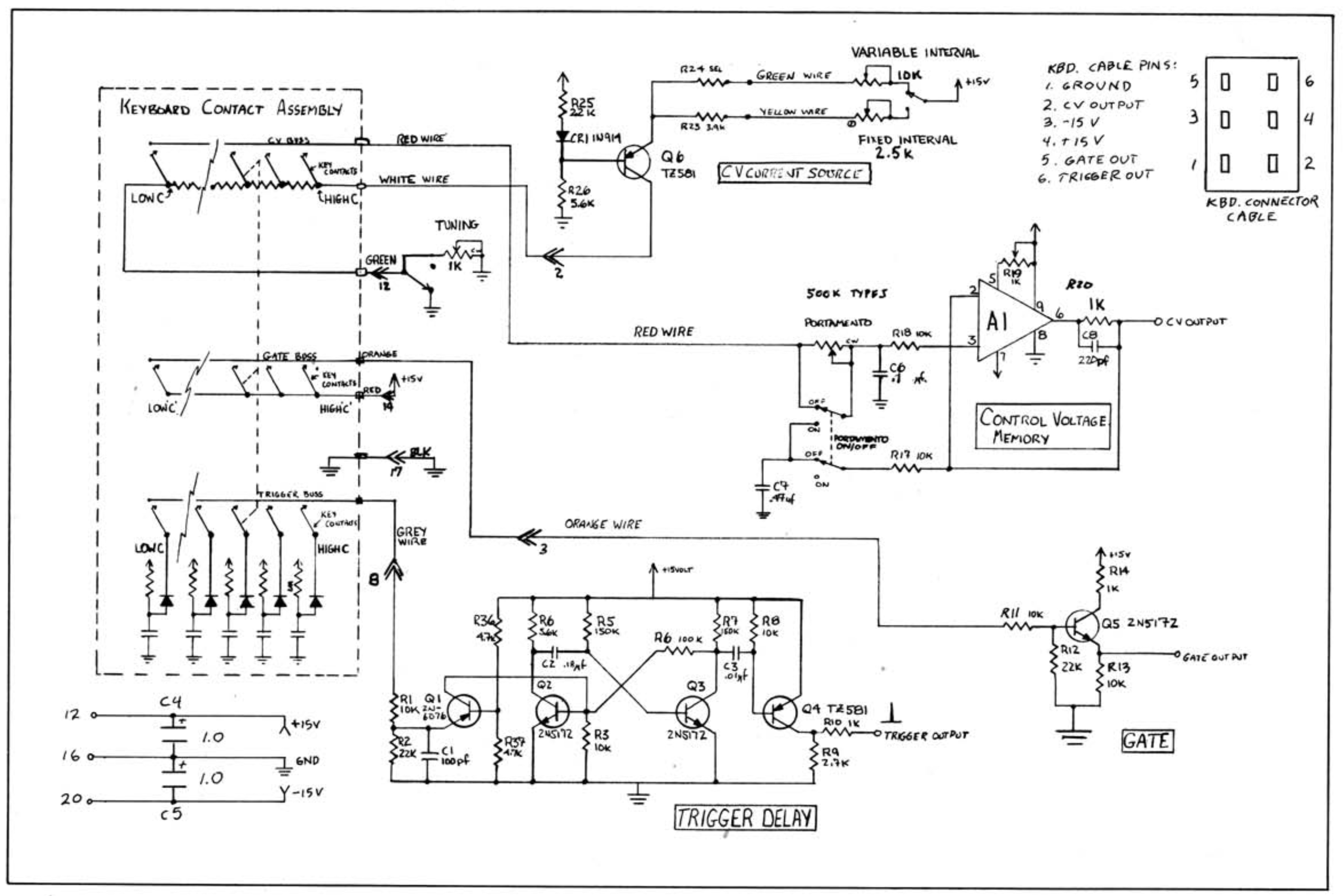

I have an older ARP 3604P keyboard that doesn't work properly. The S&H circuit is a little bit different from yours; it is more like a "track & hold" circuit, with an high-impedance buffer for the capacitor. This unity-gain amplifier was sold by ARP as a "closed" module and so the schematic isn't available on the user manual. I would like to repair (or rebuild) it. Do you think that the schematic proposed is good for that purpose? I mean, the operational amplifer Z3B with the double FET Q5 and related components.
Many thanks.

I've just had a look at the schematic, and I can't see why a standard FET Op-Amp (TL071) wouldn't work in place of A1 - just ignore the R19 offset resistor between pins 5 & 9. It's probably worth replacing C6 & C7 while you're at it.
It looks like most simple Keyboard S&H circuits I've encountered.

I've just had a look at the schematic, and I can't see why a standard FET Op-Amp (TL071) wouldn't work in place of A1.
Hi Broadwave, thanks for your reply.
I will try but I guess that the bias current of the OpAmp inputs is not negligible.
Yes, of course. I have two questions about if. What kind of capacitor do you suggest me to use? I'm thinking that MKP could be a good choice. Do you agree?
Another question: while C6 (0.1uF) is the hold capacitor, what is che purpose of C7 (0.47uF)? It looks like a low-pass RC filter on output, coupled with R17 and R20.

CA3140 is the input impedance king.
C7 is as you say a lp filter in off , probably to stop the pitch zinging back abruptly when you switch off the portamento. When on it is the majority influence portamento cap. Double duty. I'd blame Dennis Colin for that sort of intelligence.

with the switch in position drawn, A1 (with R17, C7, R20 and C8 ) is a bandpass filter ranging from about 70Hz - 400Hz
I'm thinking that in this configuration (with the negative feedback directly from the output) it shouldn't be a BPF, 'cause in that case the DC (control voltage) from the keyboard won't pass.
Thanks all, I will share my experimental results.

CA3140 is very good in replacing the old "high impedance amplifier" A1; it works fine. About the hold capacitors C6 and C7, I'm trying with different types; the best results are with MKP capacitors, beacuse of their good linearity and very low "dielectric absorption" (... of you are interested into this topic, some useful info can be found in the LF398 S&H chip datasheet, in the section of suggested capacitor).
About the network composed by R17 (10k) and C7, its purpose is very simple.
When portamento is on, C7 works as an added "hold" capacitor, increasing the time constant of the circuit composed by the 500K potentiometer; when portamento is off, the voltage on C7 is kept at the output level by R17 (10k) in order to avoid any charge exchange between C6 and C7 when portamento is turned on; in this way, the voltage at the output doesn't change if you turn portamento on.
I will let you know further developments.
