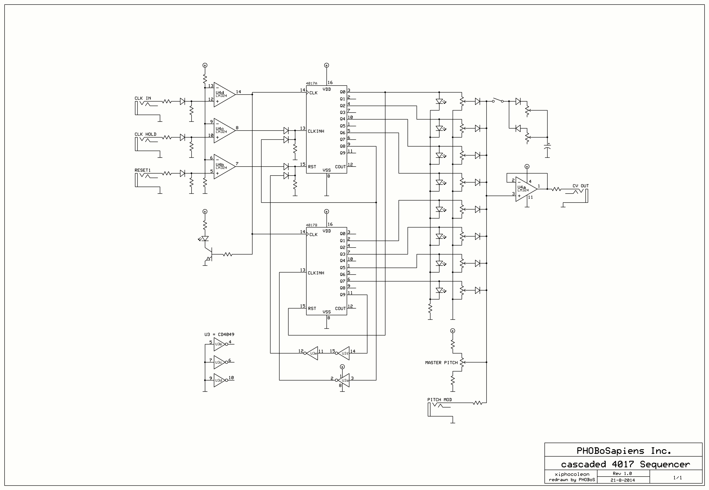

Hi everyone -- I have created an 8-step sequencer from 2 cascaded 4017s. The bread-boarded version of this circuit works. However, after soldering this together (through-hole, DIP style) on a very small board, the circuit is producing glitchy behavior. Now, after four straight days of checking all the connections, replacing the chips, and resoldering some nodes, I'm really stuck as to what could be going wrong. If you have worked with 4017s, 4049s, or op-amp inputs to circuits, could you offer me troubleshooting advice?
I have checked these chips in the working prototyped version, so let's assume the chips work fine. The 4017s are 4017BE.
At this point, the fishiest area is the clock signal. The clock leaves the 324 with a 0 to +10 V pulse, which on the prototype is enough voltage to make the 4017 count. However, when connected to the 4017, the 0 to +10 V pulse sometimes is "crushed" -- it looks like something is pulling current away from the Clock pin on the 4017. I have checked all nodes on my soldered board with a connectivity checker, and I have not found any nodes accidentally soldered together.
If you could please check the attached schematic and give me troubleshooting tips from your own experience that would be helpful. I am also wondering if the close proximity of the chips is causing the chips to interfere with each other. Also, I have heard that placing a 0.1 uF cap across V and GND for each 4017 is a good idea to reduce counting glitches. Thank you.
If possible I'll also post a picture of my crowded soldered board.

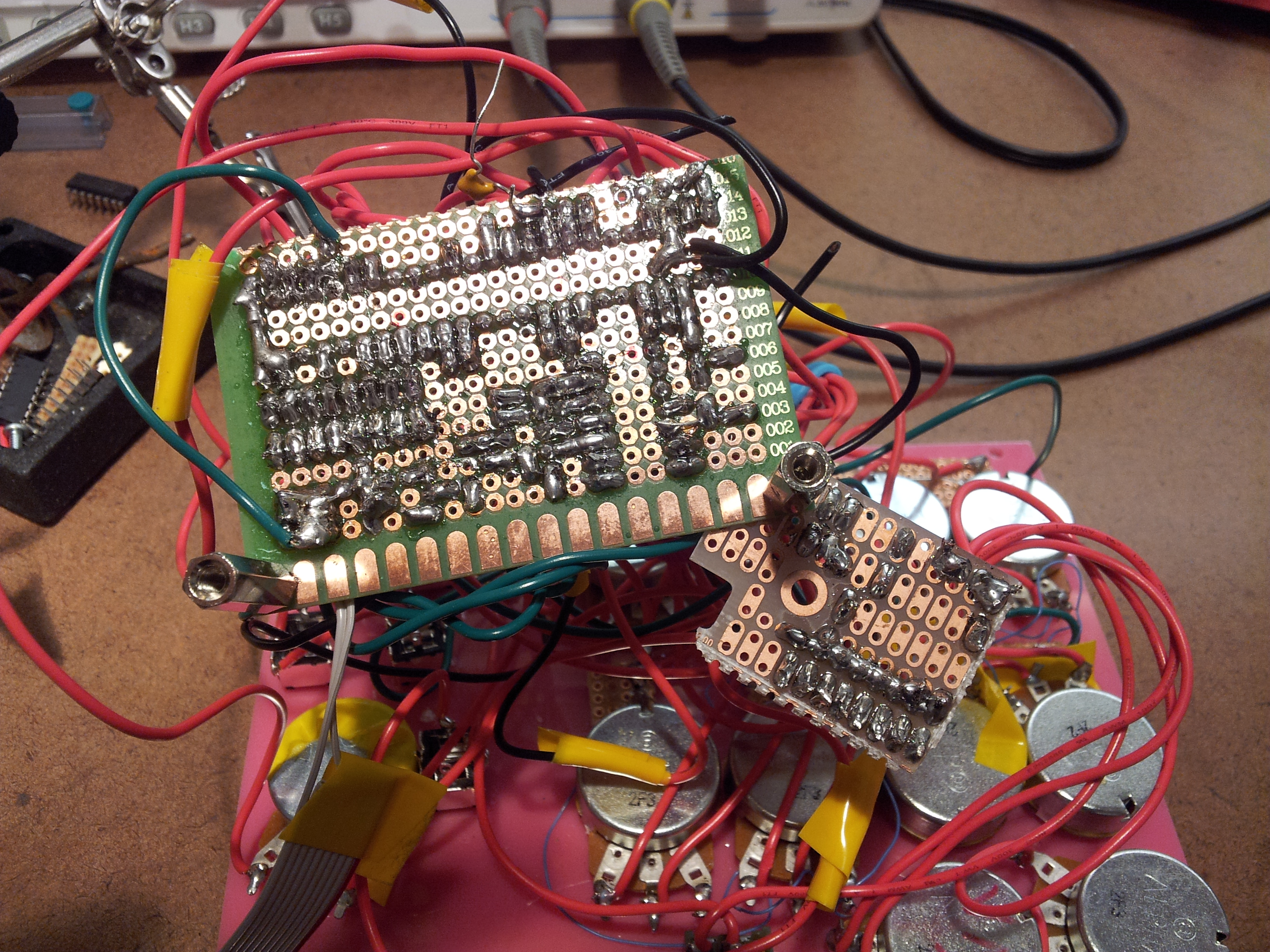

PostPosted: Wed Aug 20, 2014 12:11 pm    Post subject: pictures of soldered circuit Reply with quote  Mark this post and the followings unread
Attached are images of the physical circuit I've soldered together. Maybe by seeing the physical thing you can get a sense of if I've crowded the components too close together...

I see 2 things that could be a problem.
The transistor connected to the clock should have a resistor connected between the base and ouput of the opamp.
And the emitter of the transistor connected directly to gnd with the LED connected between the collecter and series resistor (R9).
The other thing is that you have some outputs connected together:
IC3E & IC4C
IC4B & Q8 of 4017A
Decoupling capacitors for every chip is always a good idea and can make the difference between a circuit functioning correctly or not.
Depending on what you're using it for you might want to buffer the CV outputs with an opamp.

Thank you so much PHOBoS for checking this out. I've been going a little craaaazy picking this thing apart... Smile Also, for background, I started this design with this schematic: http://electro-music.com/forum/phpbb-files/thumbs/t_16_step_4017_247.png
Oops, I forgot to include it here, but I used a 1 Mohm resistor from pin 14 to the transistor base. However, for the second comment here, are you suggesting a resistor b/t base and emitter? Or?
IC3E & IC4C
Right now if I leave these together, a voltage can trigger a 4017A reset. However, is this not a good design for that? For instance, since pin 15 of 4017A needs to be connected to the output of IC3E, is it a bad idea to allow an op amp output to connect here also?
IC4B & Q8 of 4017A
Here I think it is correct to connect these together. This way CE is low for 4017A, allowing it to count. When Q8 goes high, this will stop 4017A counting and through IC4B it will make 4017B's CE low, allowing it to count. What do you think?
Thanks again!

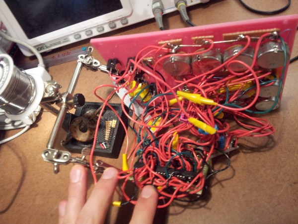

I also included another shot of the crowded board.
here is a shot of the top of the crowded circuit

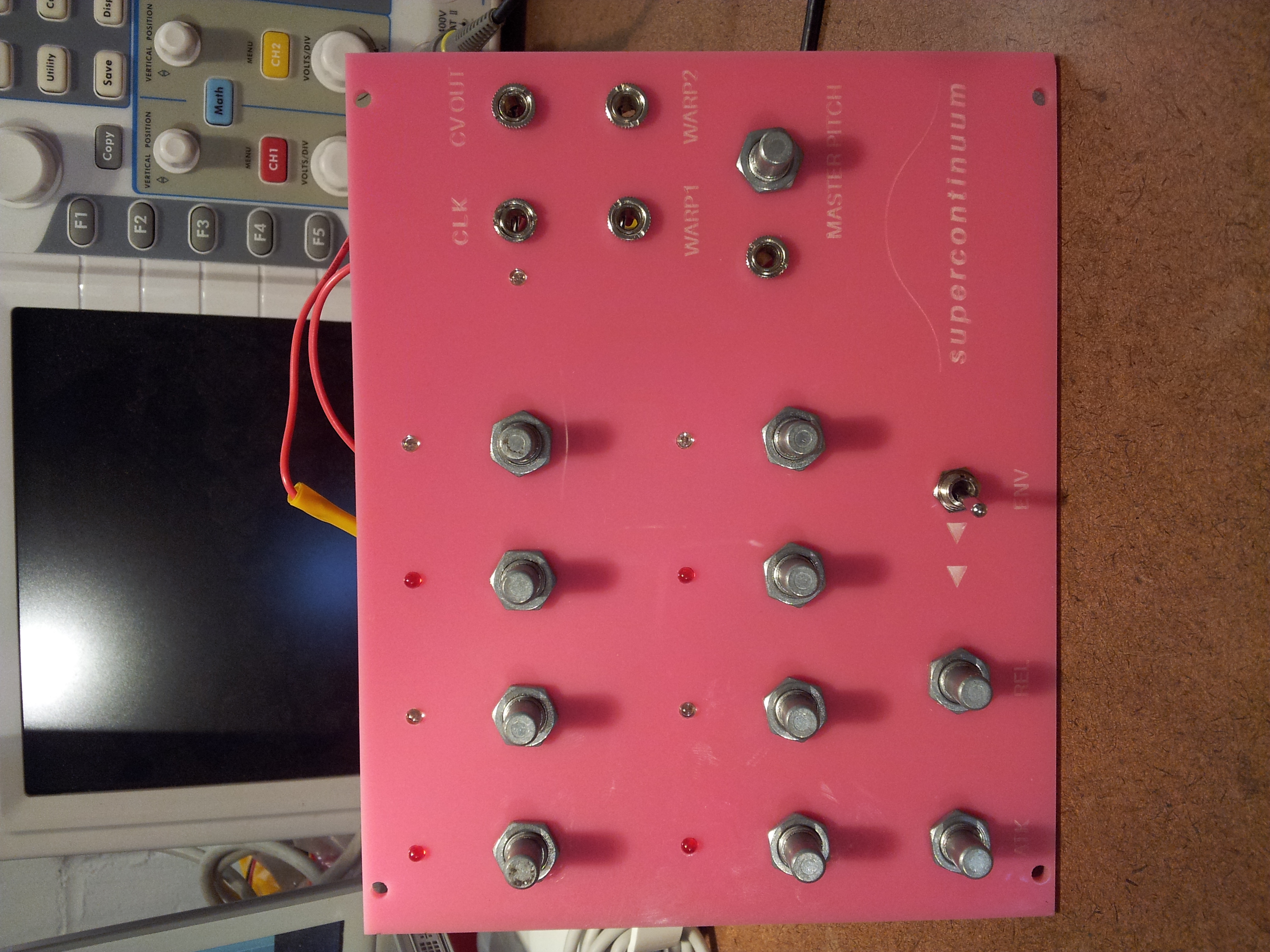

PostPosted: Wed Aug 20, 2014 5:43 pm    Post subject: faceplate Reply with quote  Mark this post and the followings unread
Also, here's the faceplate I had printed Smile Would be nice if the circuit behind it worked.

With CMOS you usually don't want any outputs connected to other outputs, including opamps.
If one output goes low and the other high you're basically shorting the power through the chips.
You can avoid this by using an OR gate which can be made with some diodes and a resistor.
I've redrawn the schematic with the changes that should make it work, I left the component values out, since those seem ok.
I'm not sure how you want the envelope part to work,. but I expect it's a reason why you're using 2 4017's and skipping every other output.
However I think the same thing could be achieved with just 1 4017 and 2 flipflops.
And I would use a summing amp to mix CV out from the sequencer with the master pitch, modulation and AR voltages.
But maybe this already works exactly as you want it.

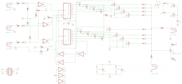

I reworked my circuit and redid it with the diodes in the newest schematic. It all works so far!
...except the first step will not trigger! ......... Sad
I think this is a common problem. It has something to do with the timing of the clock.
I have found that if I put a low resistor (10k or less) b/t 4017A's 15 (reset) and ground on my perfectly working breadboard prototype, I can also get the first step not to trigger. However, when I remove the 10k resistor b/t 15 and ground on the soldered circuit it does not fix the problem.
I have scoped the clock signals. They enter both my prototype and soldered circuit at the same speed. However, the soldered circuit sends out pulses that are slightly longer than the protoype version. And this is causing a timing overlap so the first step will not trigger. Any ideas why this is happening? I have put decoupling caps on both 4017s and the 4049. Could this affect it? There is also a polarized cap on the board near 4017A pin 15. Could this affect it?
Thanks.

The circuit I'm working with is the 2 4017s and 4049. No flip flops. It is basically the original circuit I started with, but I added the diodes and op amp that you drew in the post a couple back.
And this works on the breadboard.
But, on the soldered circuit it skips step one on 4017A (Q0/pin 3).
Anyone have ideas on how to fix this?

Ah! I solved it with a 100k resistor b/t pin 15 of 4017B and pin 3 of 4017A. I will post my completed schematic here (after I clean up my mess) for anyone else to try.
Posts: 5673
Audio files: 706
PostPosted: Sun Aug 24, 2014 8:28 am    Post subject: Reply with quote  Mark this post and the followings unread
I tried breadboarding it to see what happens, and got the same problem (skipping the first output).
So I started disconnecting everything from the first 4017 but it kept skipping the first step. Shocked
Untill I tied pin 13 directly to GND instead of through a 100K resistor, then it worked.
So I reduced the value and 10K seems to do it.

prgdeltablues wrote:
There's a circuit over on muffwigglers to sort out the problem of skipping the first step on a 4017, especially on reset. Might be what you need:
Thanks for posting this. Yes, they seem to be discussing my problem. The buffer created by two inverters was possibly causing my circuit to malfunction.
PostPosted: Tue Aug 26, 2014 10:09 pm    Post subject: Reply with quote  Mark this post and the followings unread
xiphocoleon wrote:
What do you think? Can you get 8 separate gates from a 4017?
You can get seperate gates by using AND gates after the outputs and add the CLOCK signal to them.
If you do this the outputs will only be high as long as the CLOCK is high.
this is not necessarily a drawback. it is rather a feature than a bug IMHO:
use a PWM clock and drive an AR or LPG with your sequencer - the sequence will come to life.
