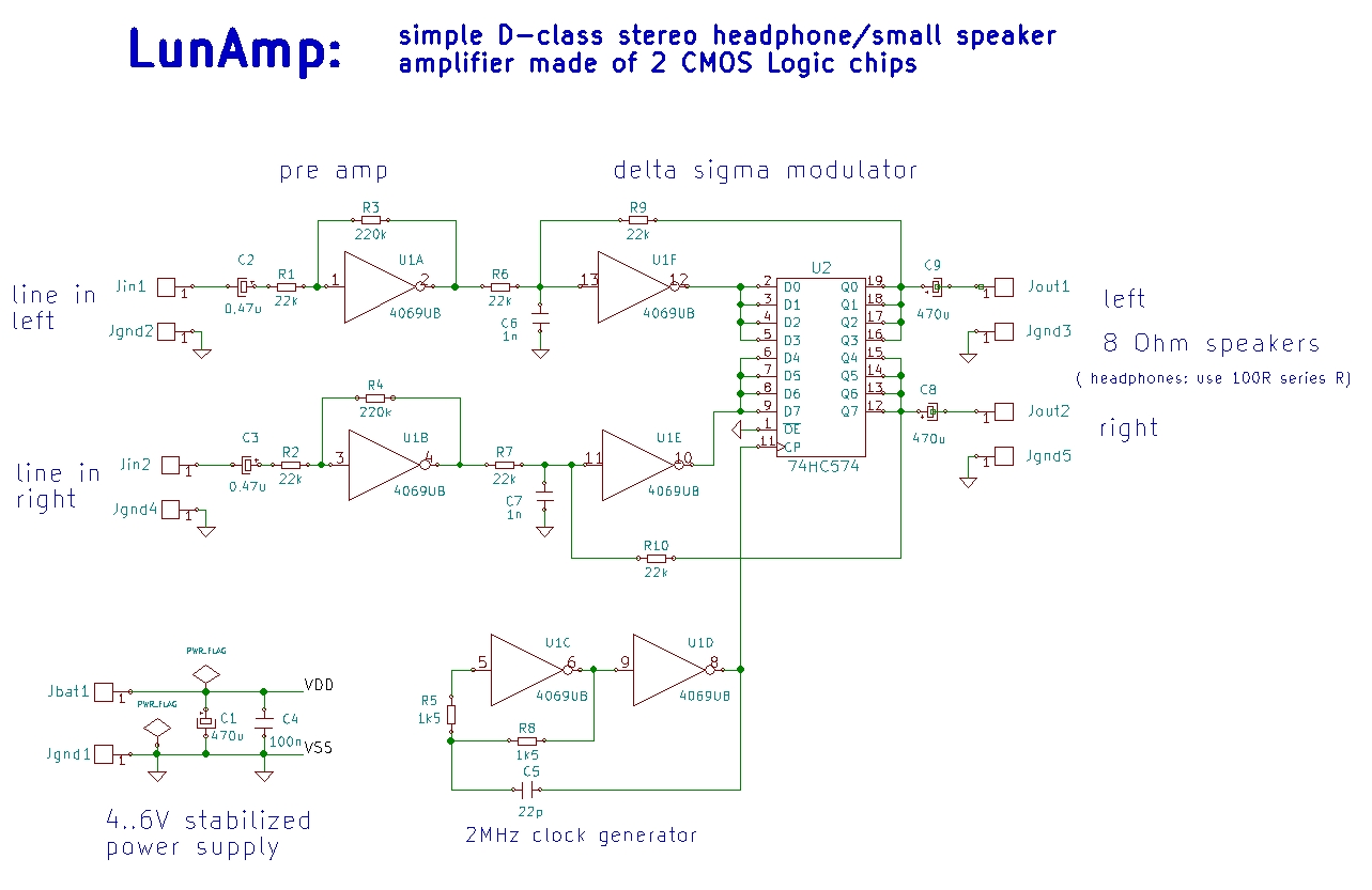

Subject description: a 2 chip Lunetta style stereo D-class amp
yesterday I successfully breadboarded 1mono channel of a simple speaker/headphone stereo amp. It's made of a CD4069UB and a 74HC574, so it is true Lunetta style Smile I checked it with an 8 Ohm 130mm speaker and 30Ohm stereo headphones : sound quality is astonishing good for 2 digital chips . 2/6 4069 is used as preamp, 2/6 make a delta sigma ADC together with the 74HC574 (or '374) D-flip flops and the remaining 2 inverters make the clock generator. The circuit works nice with 3x1.5V AA cells, USB-5V or 6V lead battery.
There is some noise floor that is a bit annoying @ low volumes. So I would not recommend LunAmp as high end amp Wink, but for pure Lunetta synth boxes it should be good enough. Use short (<30cm), twisted speaker wires if you don't want to use it as 2MHz transmitter. For headphones use series resistors (~100R) or voltage dividers on the output to bring down noise and avoid bleeding ears Smile

No idea how it works (guess I'll have to look up delta sigma ADC) but I think inputs D4+D5 should be connected to D6+D7 aswell, right ?
I don't have a 74HC574 but I might have something else to test with.

ADC) but I think inputs D4+D5 should be connected to ...
sorry, I had problems generating a correct picture. I updated the image now.
And yes, read about delta sigma ADC and look @ this, which shows the basic idea for this amp :
https://www.youtube.com/watch?v=DTCtx9eNHXE
you could use a 4013 instead of the 74HC574 and buffer each output with
with another 4069 (all inverters parallel). This will not be enough for 8Ohm speakers, but may be ok for headphones.

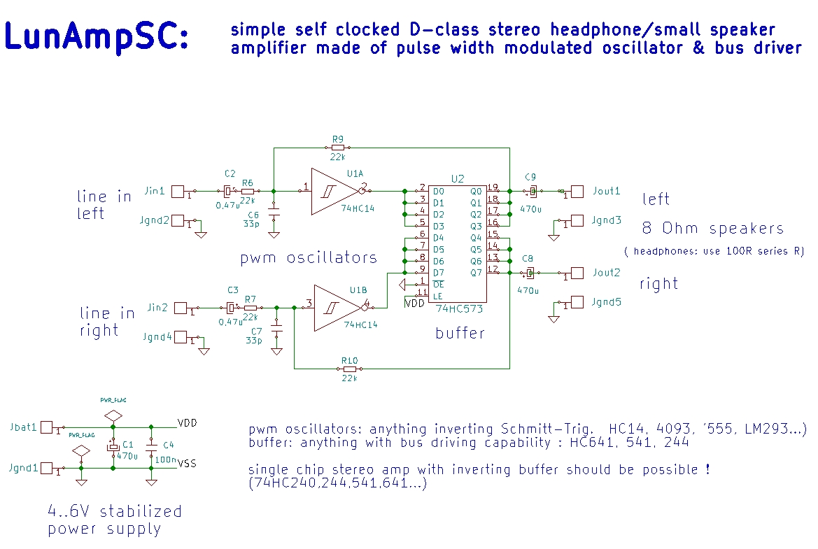

update: my friend Chris, who did a lot of Schmitt-Trigger experiments in the last month sent me a link to his PWM-oscillator post:
http://hobby-roboter.de/forum/viewtopic.php?f=5&t=150
I suddenly realized that if I could rise clock frequeny to "infinite", that means
just using a buffer without any clock, the delta sigma amp smoothly transforms into a simple self clocking pulse width modulated oscillator !!!
I breadboarded it, and yes, it works like a charm : the "infinite" clock rate of a transparent latch 74HC573 avoids interference between sigma delta clock and time constant of the modulator. So less components & less noise now by just using a pure good old Schmitt-Trigger oscillator Smile
