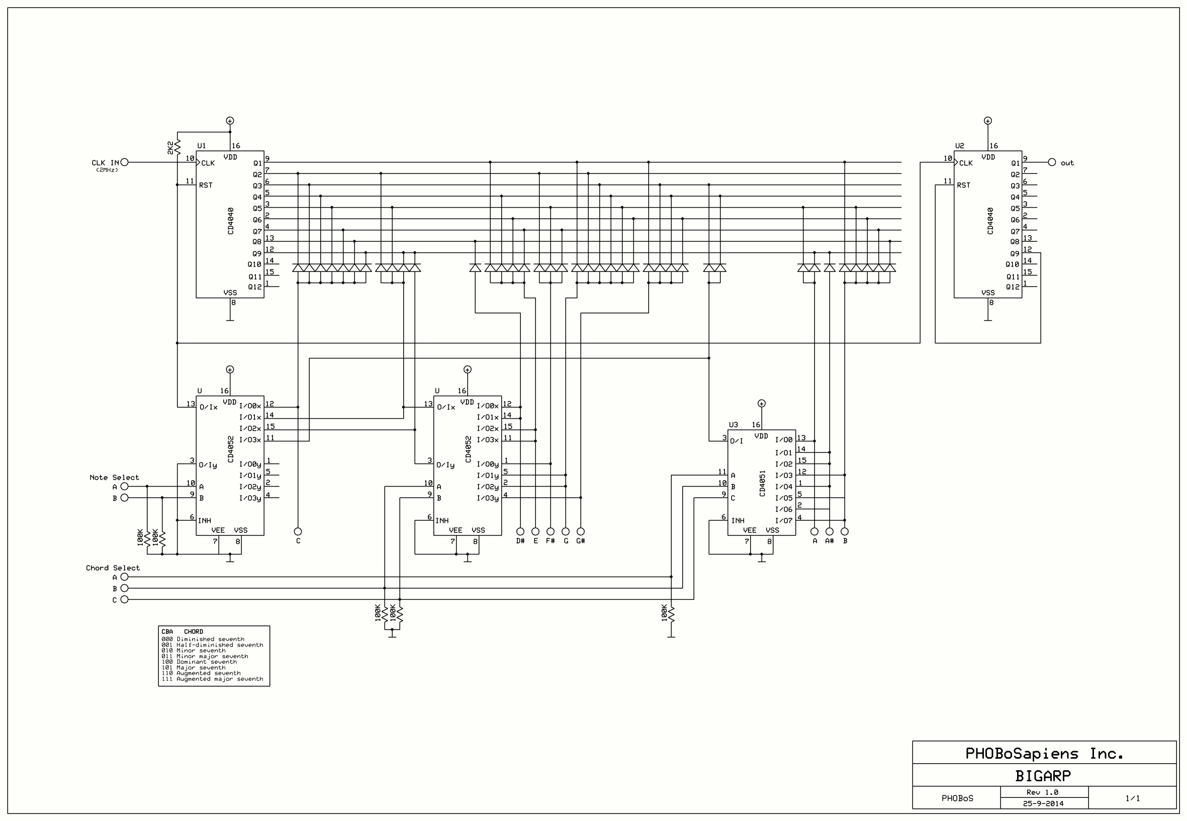

PostPosted: Sat Sep 27, 2014 12:58 pm    Post subject: BIGARP Reply with quote  Mark this post and the followings unread
Here's one I drew up that can step through 8 different chords using the 9 bit divisions.

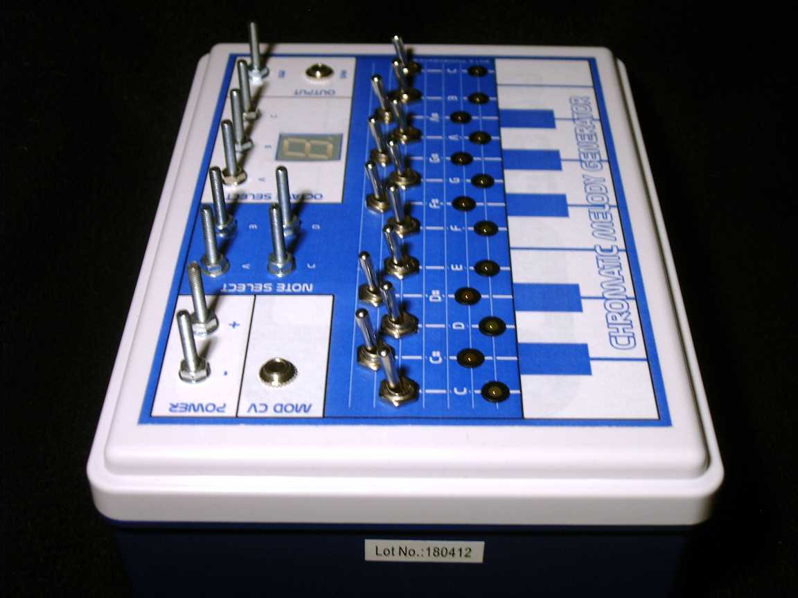

I'm putting the Chromatic Melody Generator in an enclosure. everything is mounted and some things wired up,
but I can't finished it before I have figured something else out first: Can I rearrange the noteorder to get more musical combinations ?
Of course I can already make all the combinations/chords but I want to group them to correspond with the binary inputs combinations.
note:I'll be ignoring the higher C for now and just work with 1 octave
By changing only 2 inputs at a time you end up with the following 24 permutations:

great, a string of notes and some chords but what the hell does it mean ?!
The string of notes is the order in which I will wire the outputs from the diode matrix to the mux. (of the chromatic melody generator)
Which will have the effect that when cycling the bits of 2 of the note CTRL inputs it will produce notes that form a chord.
So it's like the ARP circuits and it can cycle through multiple chords.
Code:
note inputs DCBA = [0000,0001,0010,0011] = C  E  G# _  = Augmented triad: C,E,G#*
note inputs DCBA = [0100,0101,0110,0111] = A  C# F  _  = Augmented triad: C#,A,F*
note inputs DCBA = [1000,1001,1010,1011] = G  B  D# _  = Augmented triad: D#,G,B*
note inputs DCBA = [1100,1101,1110,1111] = D  F# A# _  = Augmented triad: D,F#,A#*
note inputs DCBA = [0000,0001,1000,1001] = C  E  G  B  = Major seventh: C
note inputs DCBA = [0100,0101,1100,1101] = A  C# D  F# = Major seventh: D
note inputs DCBA = [1000,1010,1100,1110] = G  D# D  A# = Major seventh: D#
note inputs DCBA = [1000,1001,1100,1101] = G  B  D  F# = Major seventh: G
note inputs DCBA = [0000,0010,1000,1010] = C  G# G  D# = Major seventh: G#
note inputs DCBA = [0100,0110,1100,1110] = A  F  D  A# = Major seventh: A#
*the only difference between these is the order of the notes.
Also all the notes it produces will be within one octave (unless the octave CTRL inputs are controlled too),
so notes that should be spread apart to form a chord will now be closer together.

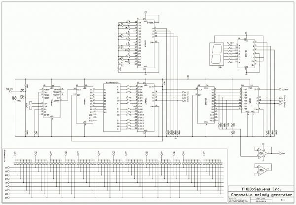

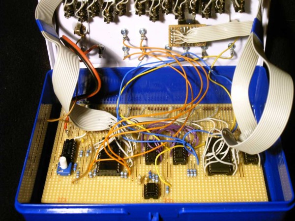

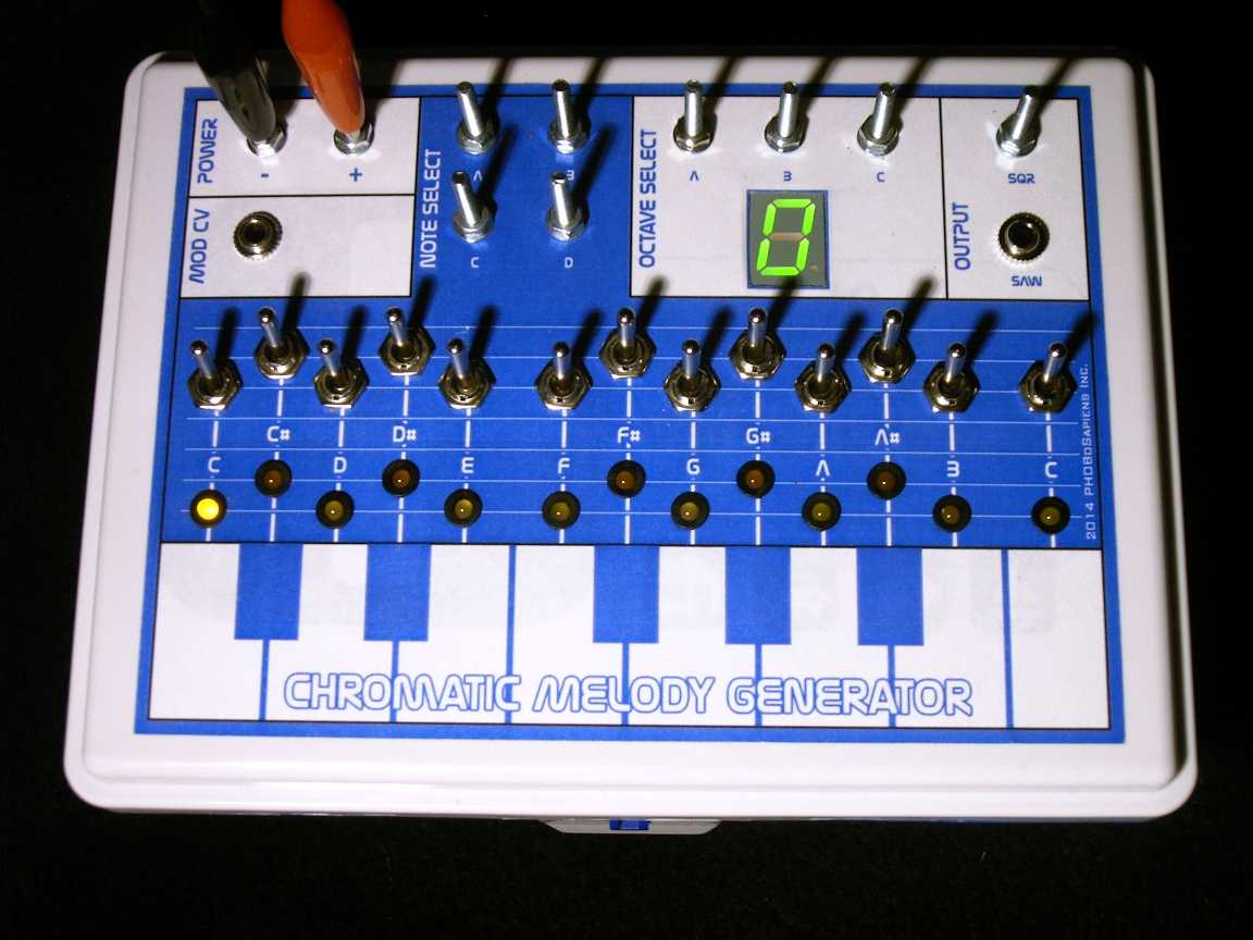

Posts: 5947
PostPosted: Sat Oct 04, 2014 4:42 pm    Post subject: Reply with quote  Mark this post and the followings unread
I finished wiring it up and it works great Very Happy
I connected some resistors to the octave divider for a stepped saw output,
(fixed octave) and added a CV input aswell.
Maybe I'll add an attenuator to that later using the spare opamp.
Here are some photos and an updated schematic.
edit: I noticed some mistakes in the schematic, so uploaded a fixed version.

 Filesize:  137.17 KB
 Viewed:  1067 Time(s)

PostPosted: Wed Oct 15, 2014 2:34 am    Post subject: Reply with quote  Mark this post and the followings unread
This is so cool Phobos, thanks for sharing. Now I want one. Smile
Edit: Spelling mistakes.
Posts: 5947
PostPosted: Wed Oct 15, 2014 5:51 am    Post subject: Reply with quote  Mark this post and the followings unread
Thanks Dr.Offset, I'm having a lot of fun with it Very Happy.
It played a prominent part in Sprut Flup and was used for Chromatoes aswell.
I have some more recordings but need to sort those out first.

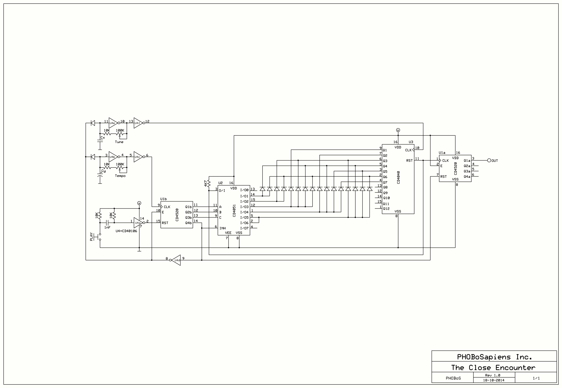

PostPosted: Sun Oct 19, 2014 7:18 am    Post subject: The Close Encounter Reply with quote  Mark this post and the followings unread
I haven't tested this but it should play the 5-note sequence from Close Encounters of the Third Kind.
Add a LM386 and a speaker and you could use it as a doorbell. Wink
"The Close Encounter" schematic (untested)
 Filesize:  57.43 KB
 Viewed:  871 Time(s)

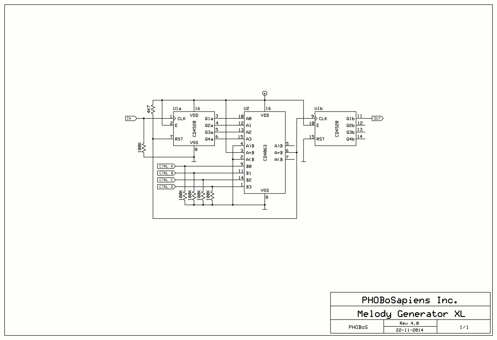

Back to what I started with, a 4 bit Melody Generator. I had ordered some CMOS comparator chips (CD4063), but not tested yet.
Just did that so here's a working version using 2 chips. Cool
Melody Generator XL - V4.0
 Filesize:  43.45 KB
 Viewed:  910 Time(s)

PostPosted: Mon Apr 02, 2018 7:04 am    Post subject: Reply with quote  Mark this post and the followings unread
Was this ever tested?
Also are the pulses that clock the 2nd half of the 4520 really tiny?
Posts: 5947
PostPosted: Mon Apr 02, 2018 1:03 pm    Post subject: Reply with quote  Mark this post and the followings unread
yes it was tested (read the comment again).
And indeed, the pulses are really narrow, so that might not work if you want to use it in a multiplier setup Wink.
The output of the 2nd 4520 has a nice 50/50 dutycyle though, of course at half the frequency.
