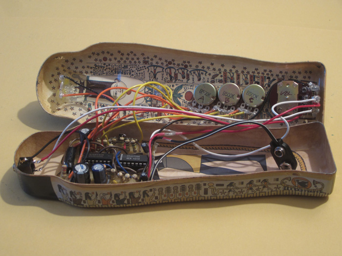

THE PHAROAHDRONE: A simple but pretty cool little stereo drone circuit built into a garage-sale find. With glowing eyes!
The circuit is the XOR Stereo Droner by the amazing PHOBoS. 5 oscillators on a 40106 and an XOR.
I made two minor changes: 1. added a photo resistor in series with one of the oscillators, and 2. removed a switch, making the "vactrol" permanent.
Since the box is quite snug, I had to put the pots very close together, so I needed small-diameter knobs. I didn't have any to hand and neither did the local electronics stores, so I made some with cardboard and hot glue.
There's a funny thing that happens when one turns it off... it keeps running for quite a while... I thought it would take much larger caps to last that long... there's a 200uF on the power, and two of the oscillators have 470uF.

Beautiful....
Posts: 5947
PostPosted: Sat Oct 25, 2014 7:37 am    Post subject: Reply with quote  Mark this post and the followings unread
wonderful box, love the eyes farao
I wouldn't have guessed those are cardboard knobs, nice creative idea.
(beads can be useful as small knobs)
heheh, I used to do magic tricks as a kid albino

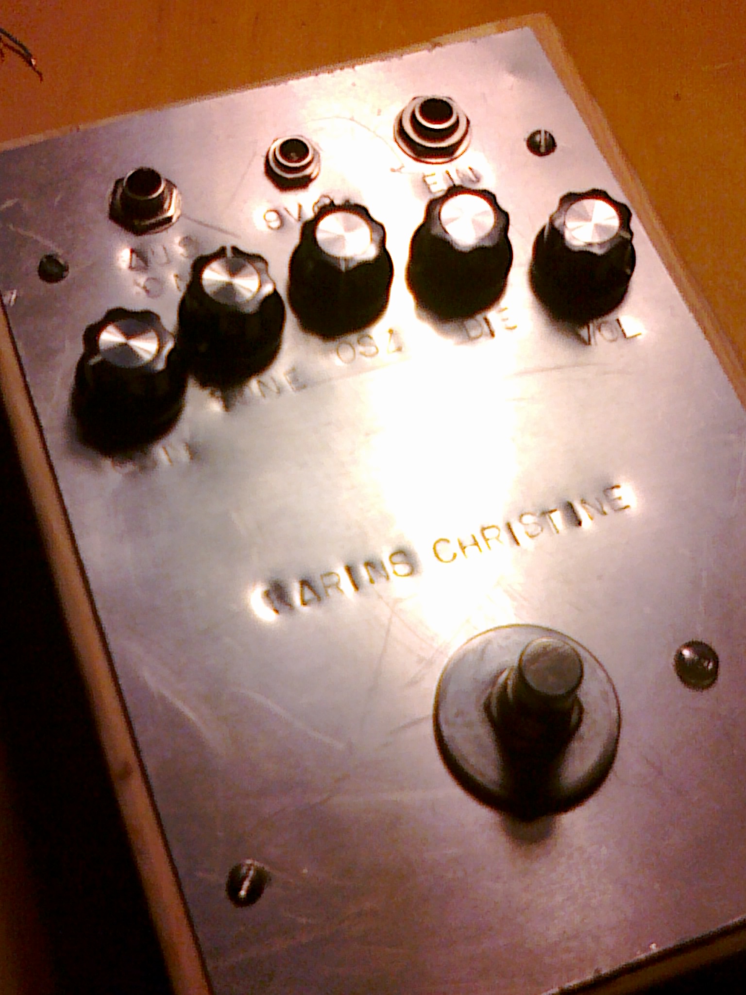

Rather an effect here, but since it squeals on its own, i guess it qualifies as a sound generator, right?
It's a present for my friend Karin and is a Christine fuzz, hence the name…
All stock, just added this blinding white LED that somehow flashes along with the blurps.

I love the stamped metal look! Reminds me of fairfield electronics
