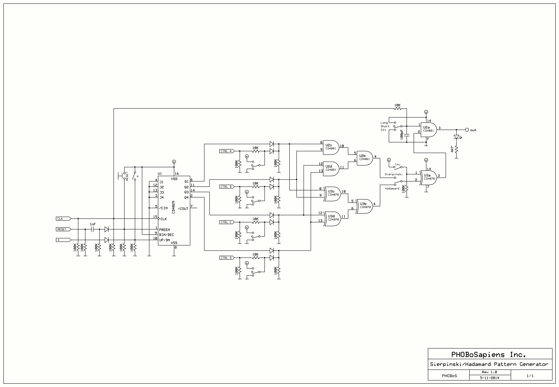

PostPosted: Wed Nov 05, 2014 11:38 am    Post subject: Reply with quote  Mark this post and the followings unread
here' s a version that has most of the different gate options.
Easiest way seems to be to use both AND and XOR gates and just switch between them (or you could use both outputs).
This leaves a spare XOR which can be used as an inverter and a spare AND which is used to create short pulses.
Inverting the outputs of the counter is the same as counting backwards so instead of the CD4520 + CD4070 I used a CD4029.
No XOR's on the CTRL inputs this time but they could be inverted externally.
Sierpinski Hadamard pattern generator
 Filesize:  63.62 KB
 Viewed:  887 Time(s)

Posts: 5916
PostPosted: Wed Nov 05, 2014 1:14 pm    Post subject: Reply with quote  Mark this post and the followings unread
oops I accidentally hit the edit button on your reply, hope it's restored as it was Embarassed
Wow, The Amazing PHOBoS once again pulls a really interesting circuit rabbit out of his electronic hat Smile
Can you do a Koch snowflake or a dragon curve? Smile
Laughing not yet
I really like the golden dragon though:
What about replacing the gates with JingleJoe's "4051 ANY gate"? Although I barely remember how that worked or if it's even appropriate. Probably not, sorry.
I thought about that, hence why I mentioned muxes, but it needs a 4 bit mux and then you don't have the spare gates to create the inversion and short pulses.
Posts: 5916
PostPosted: Thu Nov 06, 2014 3:34 pm    Post subject: Reply with quote  Mark this post and the followings unread
Here's a mux/anygate version anyway.
Sierpinski Hadamard pattern generator (mux version)
 Filesize:  62.75 KB
 Viewed:  877 Time(s)
