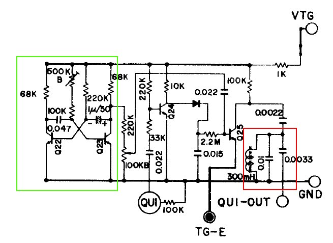

I know this is an old thread, but I have added all the deleted pictures I had posted of my SR-95 -> MP-7 mod as attachments now, as I originally had them linked to my web space and deleted them without thinking about external links to them.
Anyone had any further progress converting theirs or building any voice circuits?
I've learnt a little more about these kinds of circuits recently as I'm currently cloning another old rhythm machine from the schematics. What I see from the schematic of the Quijada sound in the first post is that there is an astable multi-vibrator (hi-lighted in red) which must be to create the repeating of the sound as it decays. Repeat rate set by the 500KB pot.
From what I understand, unlike most of the sounds on this machine where the hard-to-find inductors are used to create the actual sound, the 300mH inductor on the Quijada (hi-lighted in red) appears to be used as a band-pass filter to create the distinctive Quijada tone. Now, I've read on the web that you can simulate an inductor using an op-amp to create a similar sounding filter. That's about my knowledge exhausted on this, but thought maybe someone might want to give it a go.
