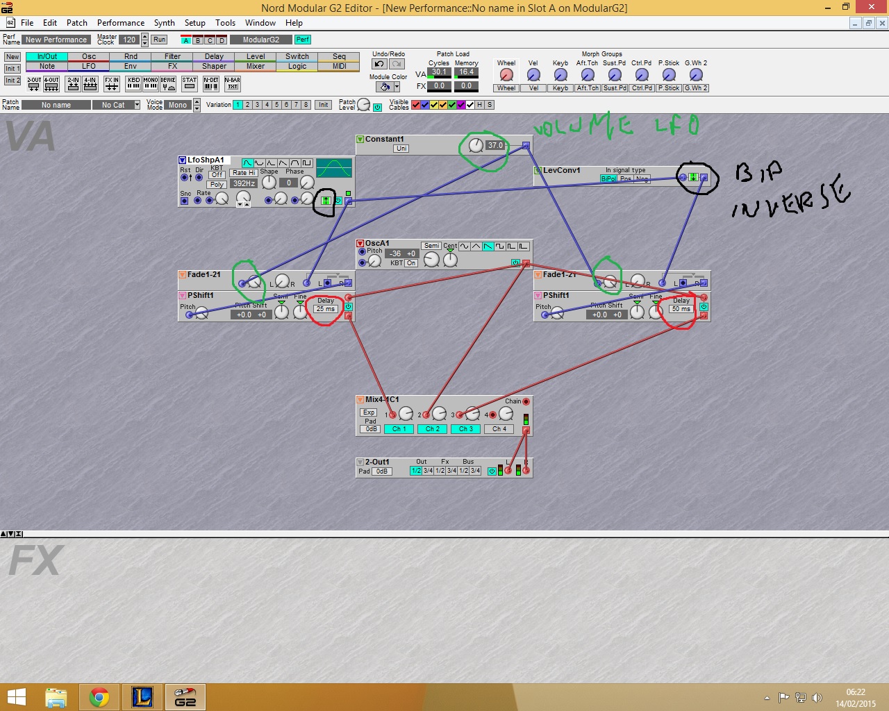

hi there
how all is here ?
i saw some patch about detune
those patchs are made with osc pitch control
i would like to know
if it is possible to build the same thing without osc control
and with an audio in ?
like detune your voice/guitar line in

i dont search a phase modulation but a reel pitch modulation

Hi TruePiano
The pitch shift module does basic pitch shifting of any source including audio in. Connect the pitch input to a keyboard module or sequencer. It will get 'mickey mouse' quite quickly if the shift factor is too big.
Or where you thinking more like granular pitch shifting like with Tim's excellent patches?
