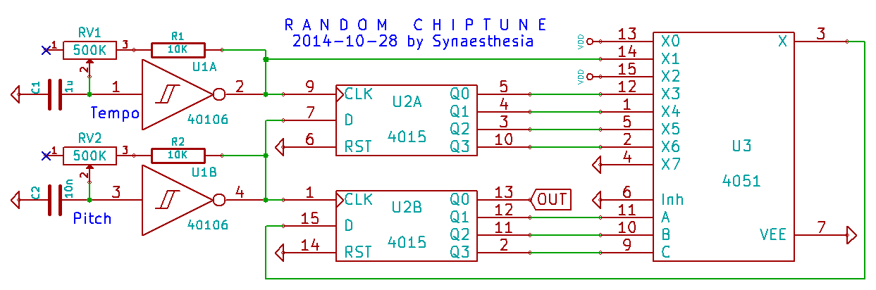

And one more variant, this time playing a random tune. The principle is the same: a shift register with a programmable feedback function implements a divider. Only this time I am using a second shift register to generate a (pseudo) random bit pattern for the feedback function. Plus, I am using the LFO output itself to provide one additional bit for the function synthesis.
The randomization comes from shifting in the output of the oscillator with each LFO clock. This makes it almost random, except that there always will be identical pairs of notes because one of the feedback function bits toggles before the next random bit is shifted in. I dropped the resistor network this time and use just the square wave from one of the divider (shift register) outputs. This circuit creates a nice swing with a minimum number of parts.
I used a spreadsheet to calculate the divider for each feedback function between 10000000 and 11111110. The assignment of the shift register outputs to the 4051 is carefully selected to avoid the divider 2 to occur, because this creates a rather high note that does not sound nice in the melody. The dividers that can occur with this schematic are 3,4,5,6,7,8,9,12 and 13. That makes 16 possible pairs of 9 possible notes.

great stuff! Very Happy
I thought I'd replied already but apprently not Embarassed
nice groove in the SuperChipTune2.
Was thinking of making some kind of bit permutator/shuffler using muxes, funny to see you do the same thing Laughing
I think what could make it more intersting is a 2nd one running at a slower speed.

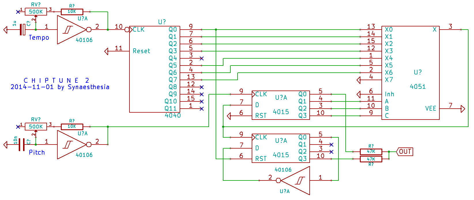

Yeah. I am currently thinking about a second voice as well.. Very Happy
The divider in the second voice better has to be coupled somehow to a short sequence of the first voice, like four notes, so that they play together nicely.
Maybe just copy the bit pattern from the first to the second and hard-wire some of the bits to 0 or 1. Investigating...
By the way, I already spent a lot of time looking at generating bit permutations using switches. Let me draw a circuit of my current idea and share it in another thread. I would be very interested in other ideas.
That's exactly what I had in mind Very Happy (like playing chords and a melody)

Not really chords, but it is a second voice. The output from the 4051 drives a second shift register that is connected as a divider by 2. The shift register is held in reset while input X0 is at 1. This way the second voice is only active if X0 is 0 and if there is no pause. A pause occurs if X0 is 0 and the current feedback function generates a sequence of zeroes. This is how it sounds.

sounds great Very Happy

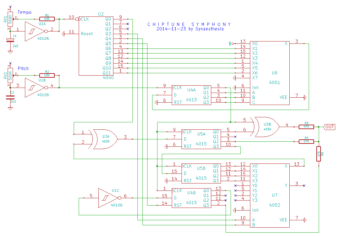

After the WalkingBass circuit idea, what else could I do? Of course, I had to combine the two circuits. The ChipTuneSymphony circuit includes the melody generator from the ChipTune circuit, the second voice, and the walking bass. This makes for about 13 minutes of ChipTune music before the pattern repeats. If you don't have the patience to listen to the recording of the full cycle, skip to 09:30 and listen for a minute to enjoy the best parts. Cool

Ok, if that was a bit too much repetition from the walking bass then change the input for XOR U3A from Q0 of U2 to Q2 and listen to this..
