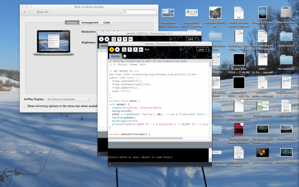

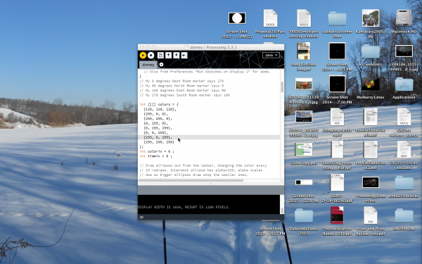

Cool There are a lot of electro-music festival regulars signed up to play, along with some non-EM folks and locals, which is part of the point. Lots of discussion on FB and none here, which makes this great for posting stuff not likely to get lost in the hurly burly over there.
This post is especially for people doing their own visuals, especially real-time graphics. I know the projector takes VGA and HDMI. Phill Reed tells me that for anyone who brings a video in standard format such as MPEG, that he has software that will clip the corners correctly & project.
MANDATORY CLIPPING TO A CIRCLE: Visual artists need to clip their graphics to a circle in the middle of Display 2 on their laptop. This clipping is not necessary for prerecorded videos (see above). Display 2 is 1920 pixels wide and 1200 pixels high. In order to eliminate the risk of hitting people in the back rows in the eyes, please clip your display to a 1200 pixel diameter circle in the middle of display 2.
I am also attaching the Processing sketch (program) that I threw together tonight, between ordering a vegetarian calzone & going to pick it up, so I could look at angles and pixels sizes and such. It reports the 1920 x 1200 on the bottom of the code screen shot, which was taken simultaneously with the screen shot showing the image going to the dome. That image bears out the 1920 x 1200 pixle report. More to follow.
Display 1 at 19:59:48 tonight.
 Filesize:  4.74 MB
 Viewed:  1567 Time(s)
Display 2 at 19:59:48 tonight, from the VGA to the planetarium dome.
 Filesize:  253.83 KB
 Viewed:  1384 Time(s)
domey.txt
My Processing sketch code for these screen shots.
 Filename:  domey.txt
 Filesize:  6.98 KB
 Downloaded:  1303 Time(s)

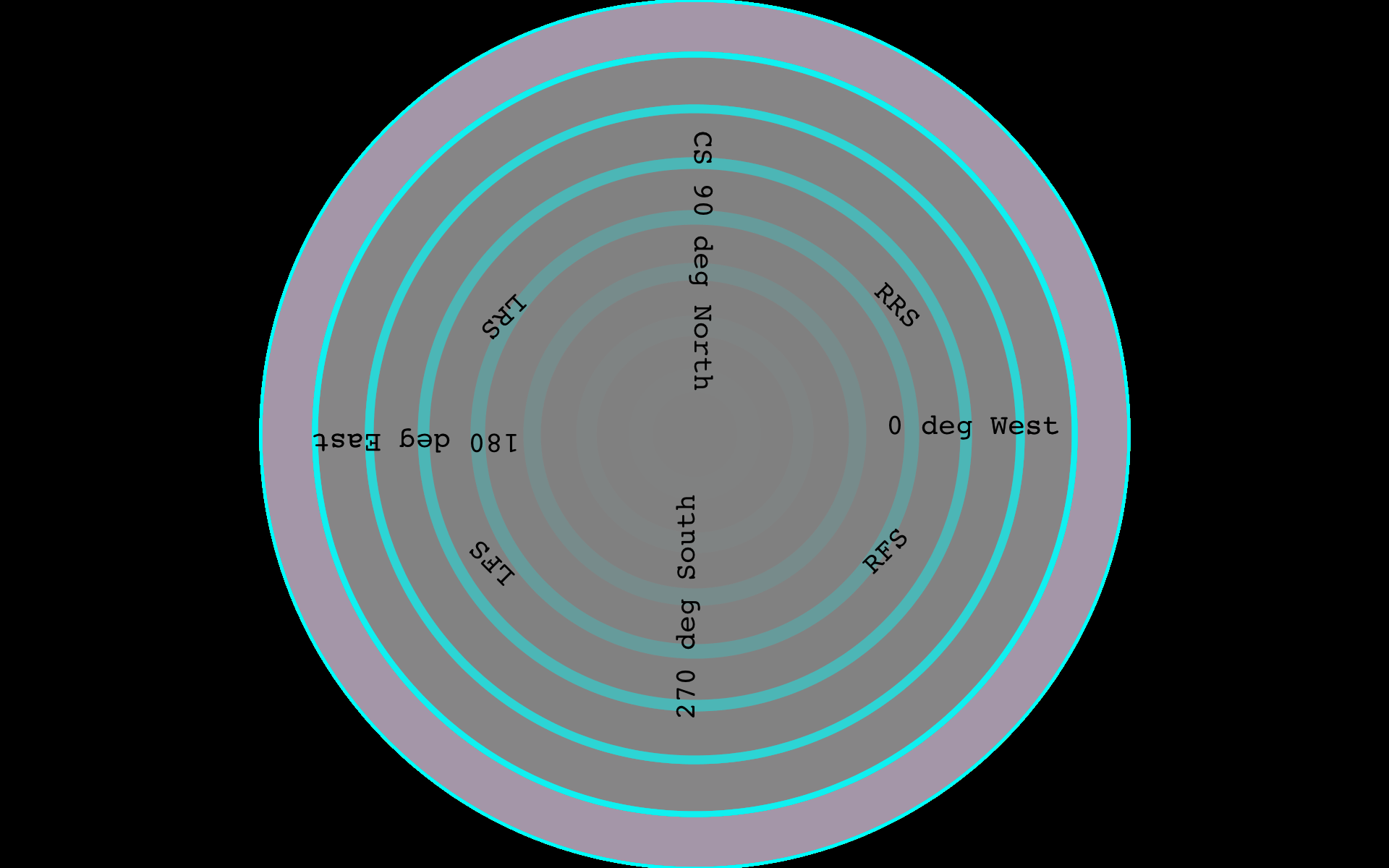

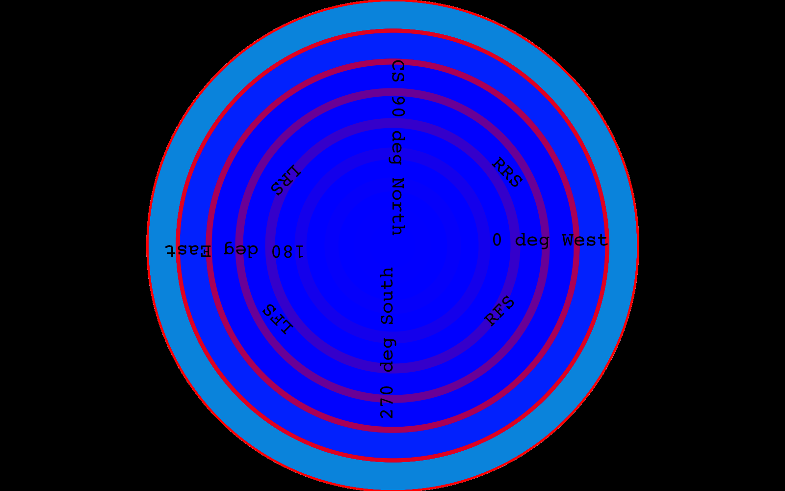

Subject description: spatial

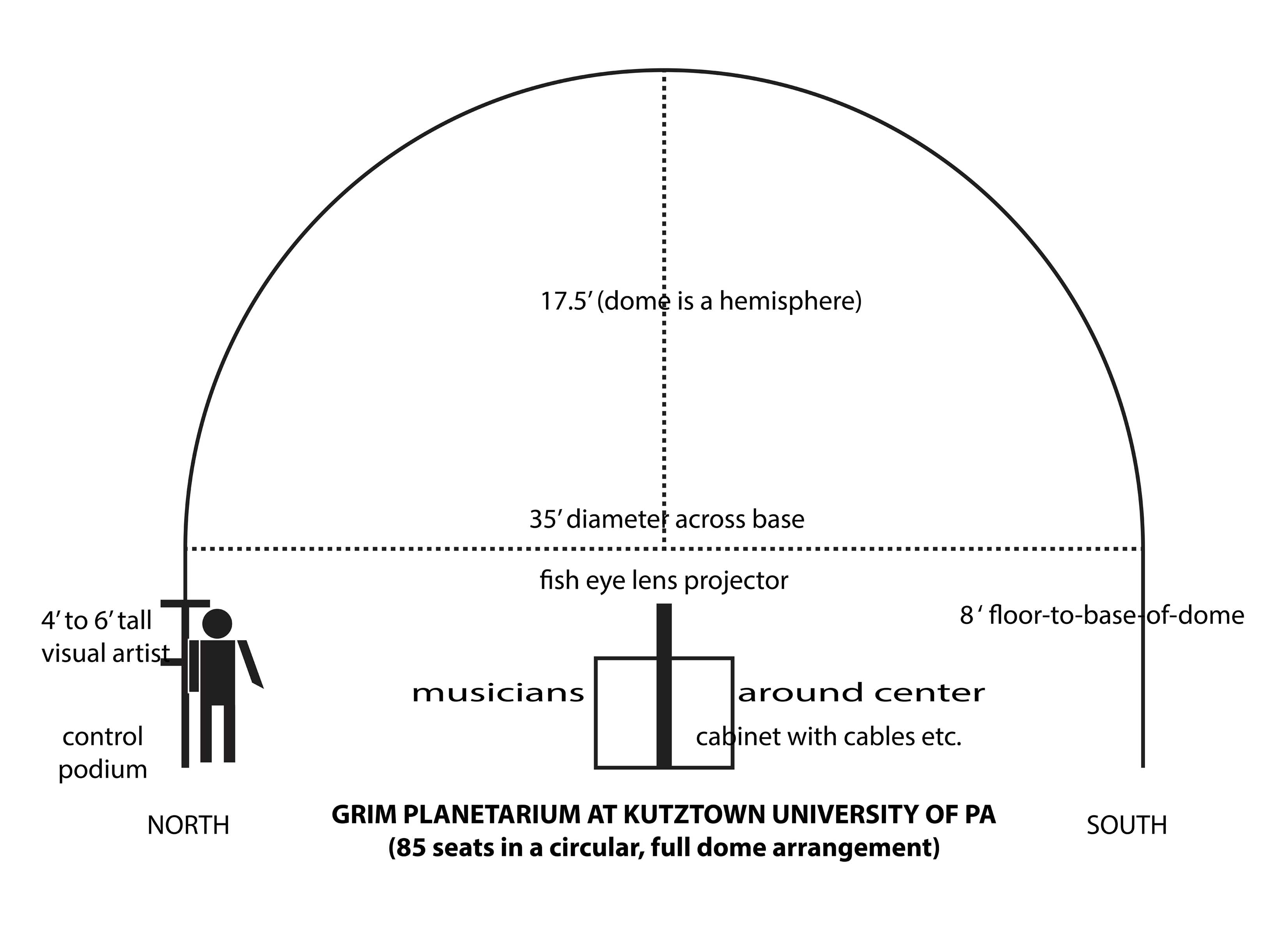

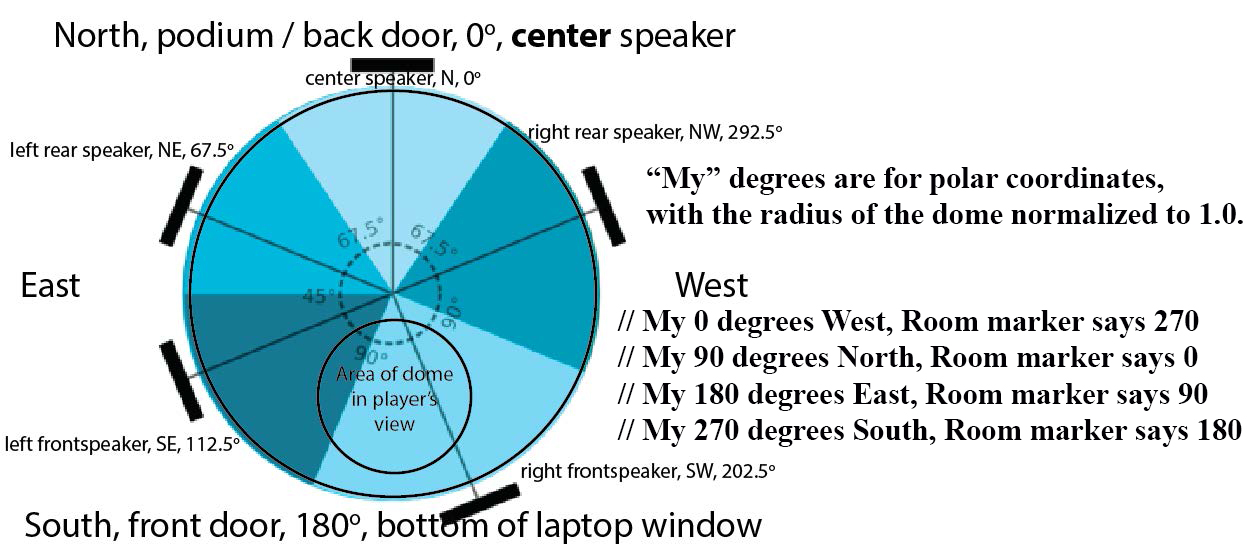

The planetarium markers show 0 degrees at North, but polar geometry conventions place 0 degrees polar -> right along the X axis in Cartesian, which projects to West on the dome. The diagram below showing speaker placement uses the planetarium's markers reference, while my software uses polar geometry. The angle increases in both as you go counterclockwise, they just start 0 at different cardinal directions.
Display 2 on a laptop puts the bottom of the second "screen" to the south and top to the north, with west on the right and east on the left. Just lie on the ground with your head to the north, feet to the south, looking upward, and you will find west is on your right. Go ahead, just try it.
I always look to the south so I can set up my display 2, in case I need to use a mouse and look my cursor on the dome.
The subwoofer is on the floor. Nobody knows quite where. This place is a Tardis.

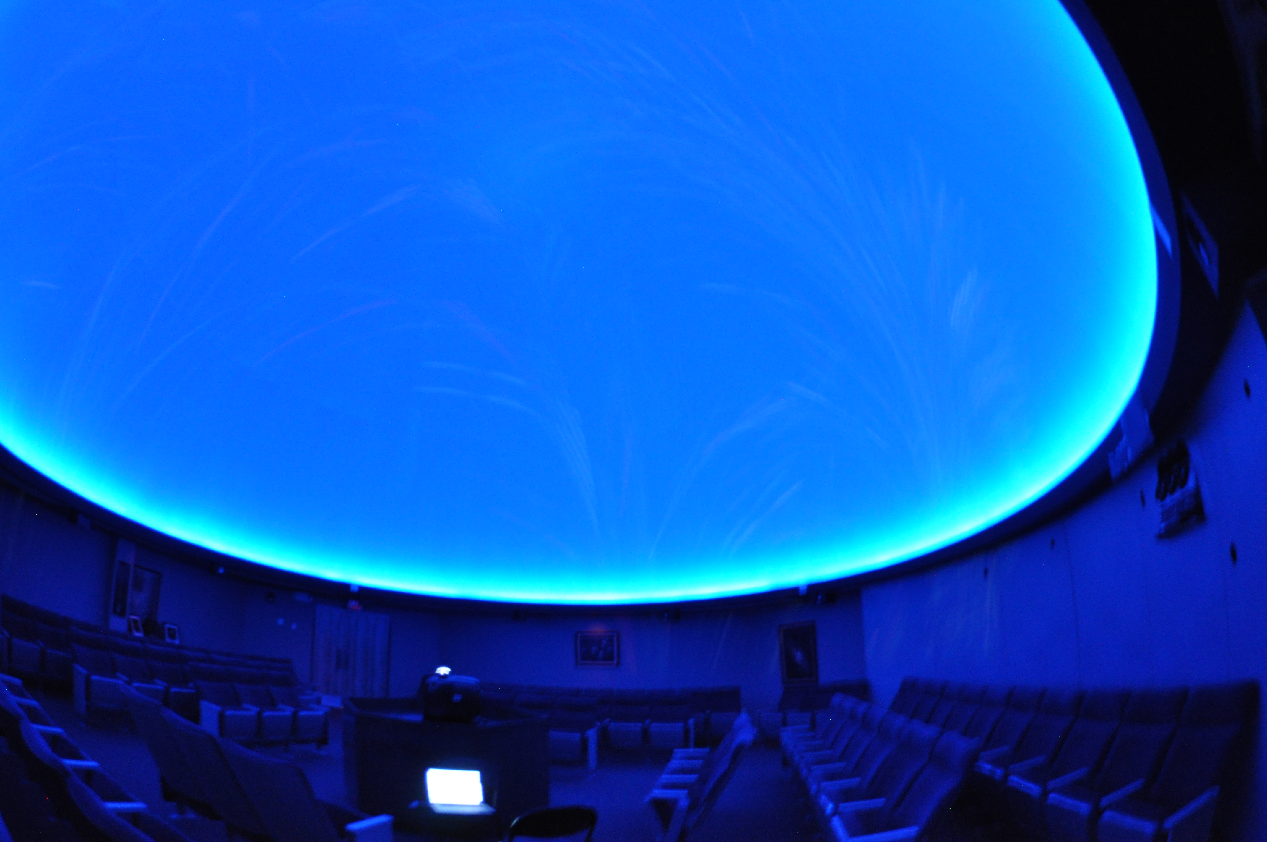

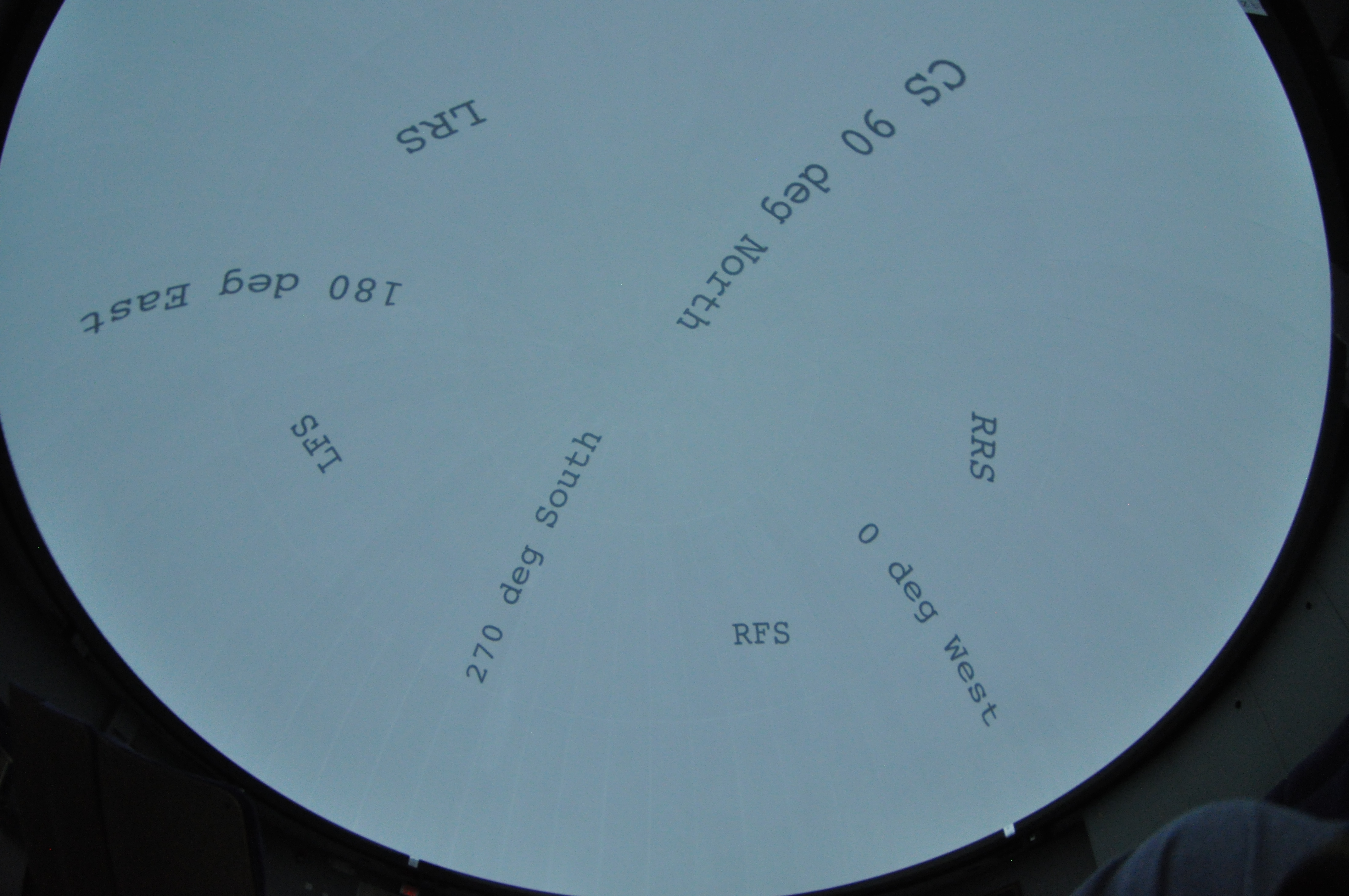

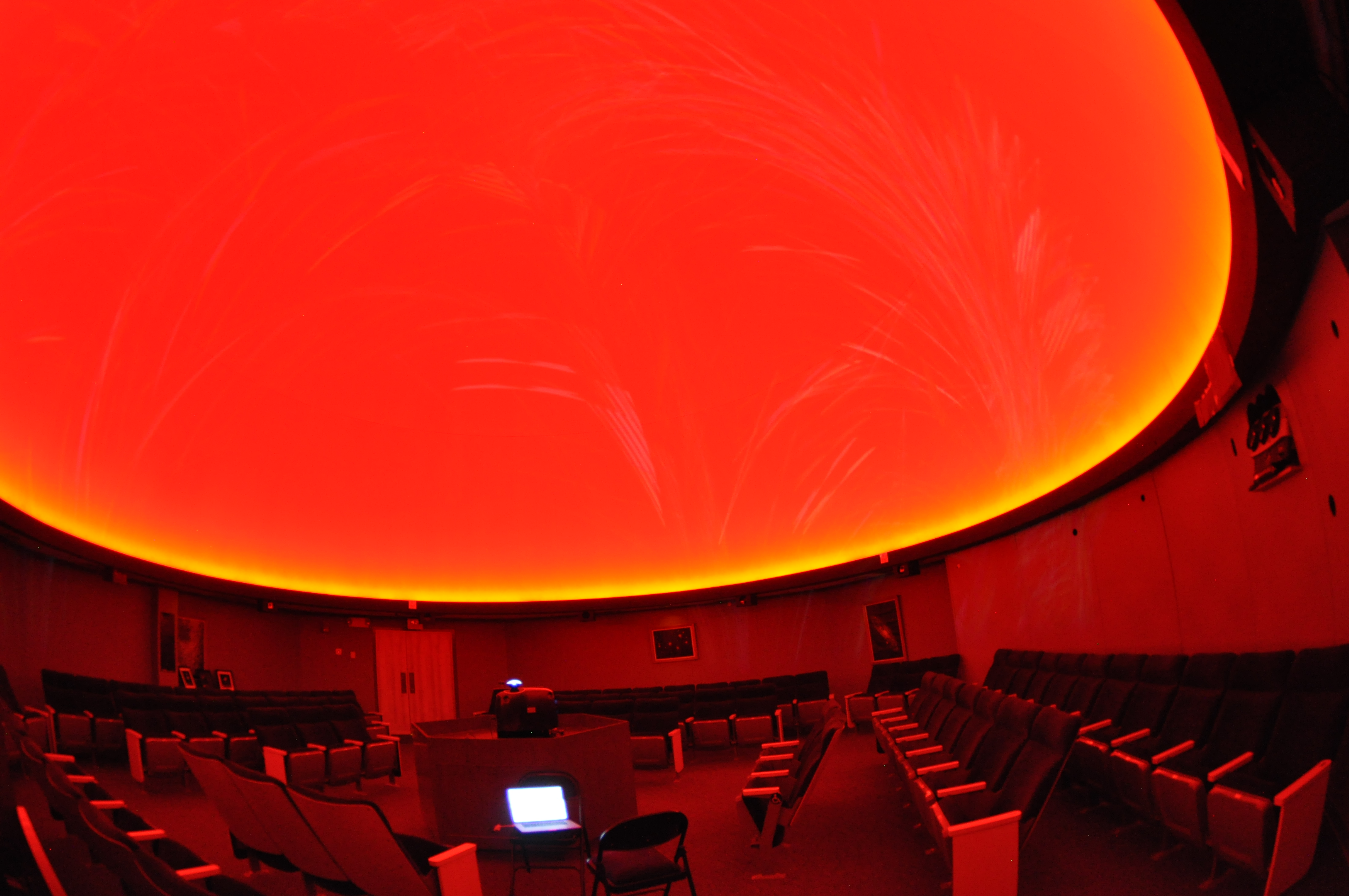

Here are some fish eye photos from the 4 directions
north & east
 Filesize:  4.27 MB
 Viewed:  1326 Time(s)
south & west
 Filesize:  4.39 MB
 Viewed:  1390 Time(s)
we can do a quiet blue light if anyone wants that
 Filesize:  4.23 MB
 Viewed:  1351 Time(s)
or red
 Filesize:  3.42 MB
 Viewed:  1410 Time(s)

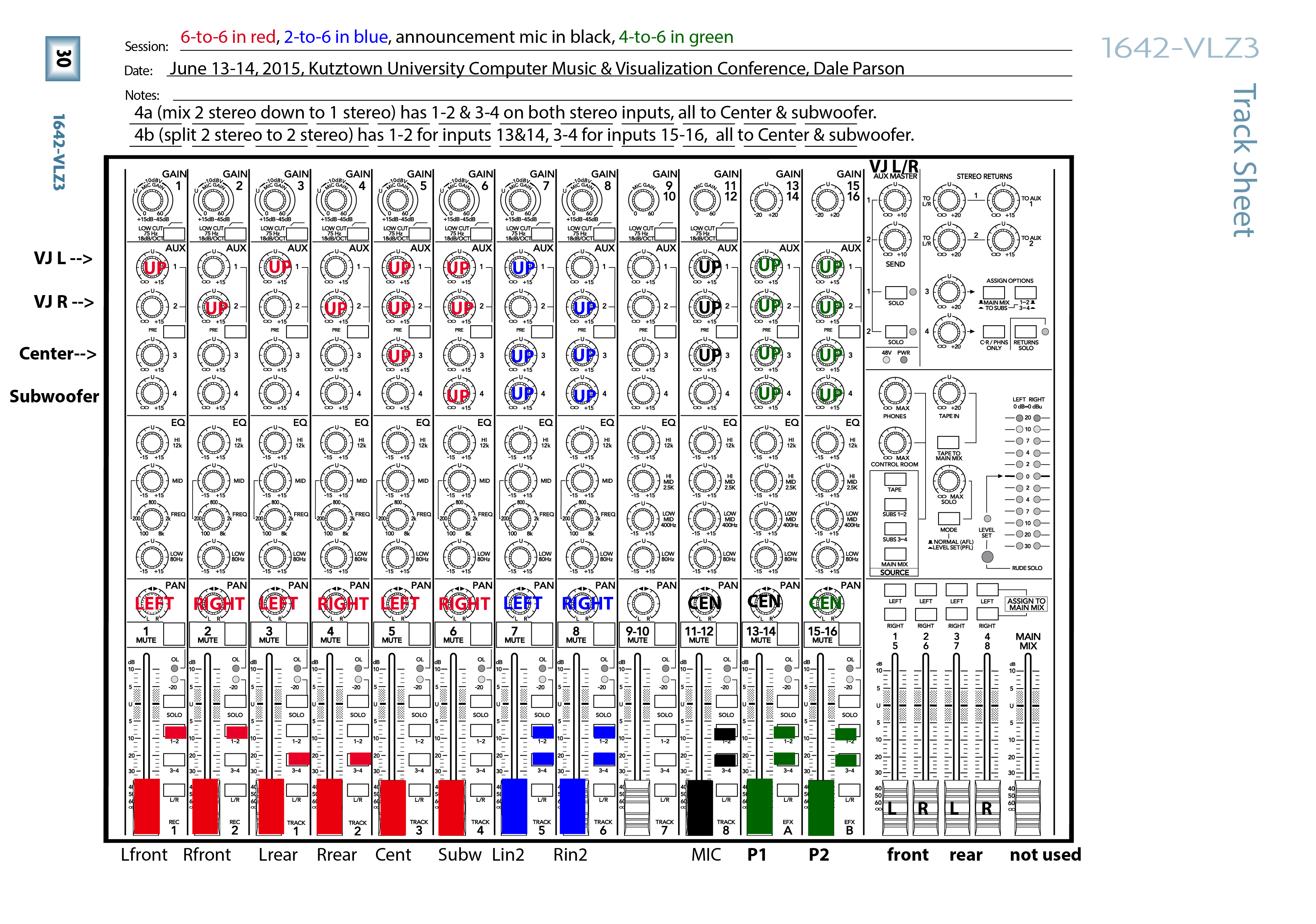

Here are mixer presets. Picking one of these will make switching much easier than using custom mixes. There is little time to switch from one performer to the next in a 3-set.
Config 6 is for performers who want full control of spatial sound. The mixer can adjust levels, but topologically speaking, it is a feed thru.
 Filesize:  361.77 KB
 Viewed:  1248 Time(s)
Config 2 is for performers supplying a single stereo feed. This is the planned speaker routing.
 Filesize:  376.62 KB
 Viewed:  1183 Time(s)
Config 4a is for two performers with two stereo pairs who want to be mixed down to regular stereo as in the previous config.
 Filesize:  390.62 KB
 Viewed:  1213 Time(s)
Config 4b is for two performers with two stereo pairs who want to get distinct speaker pairs as much as possible. Jeremy and I have used this for separate ping-pong delays from each of us to good effect.
 Filesize:  380.13 KB
 Viewed:  1212 Time(s)

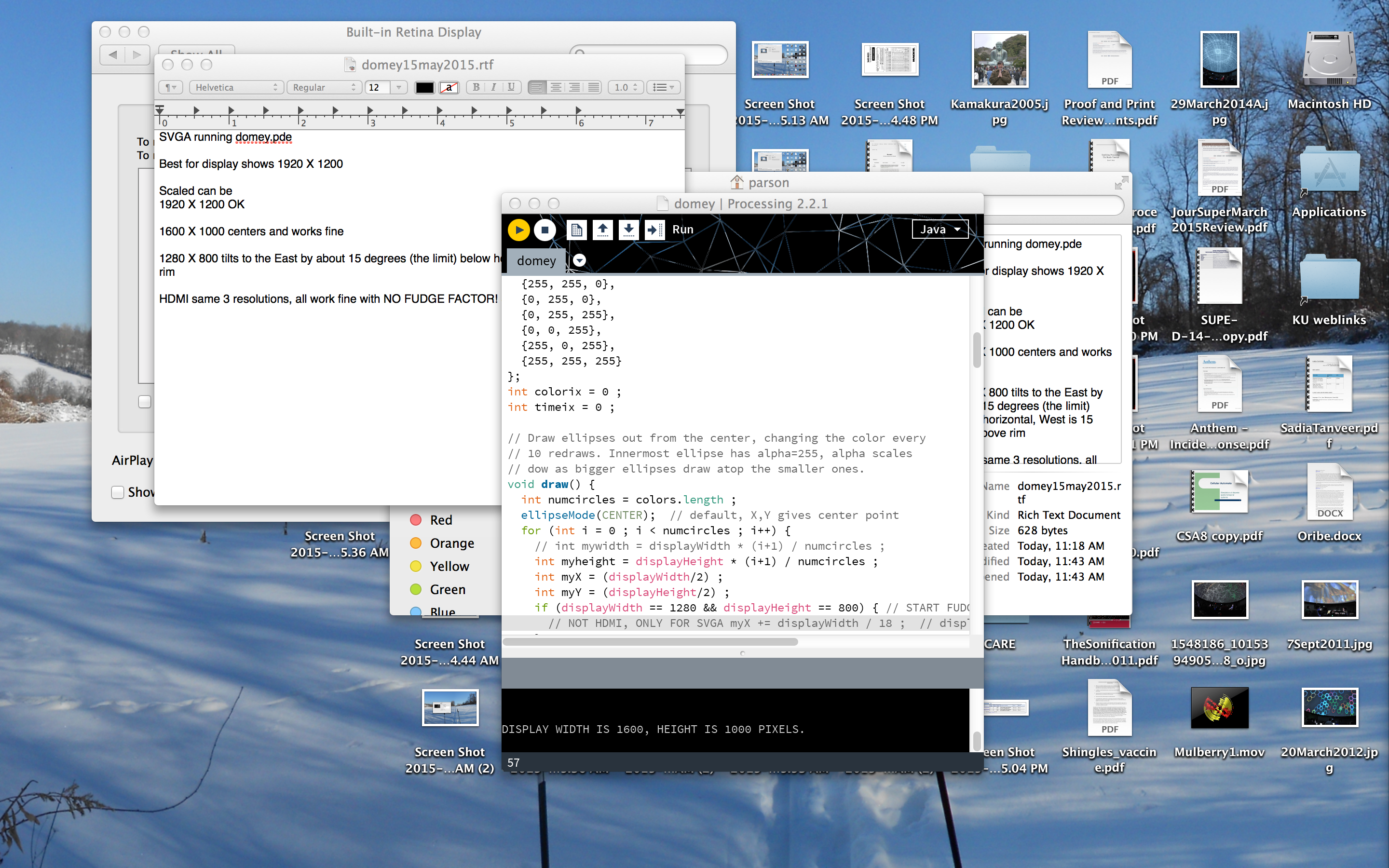

May 16, less than a month to go . . .

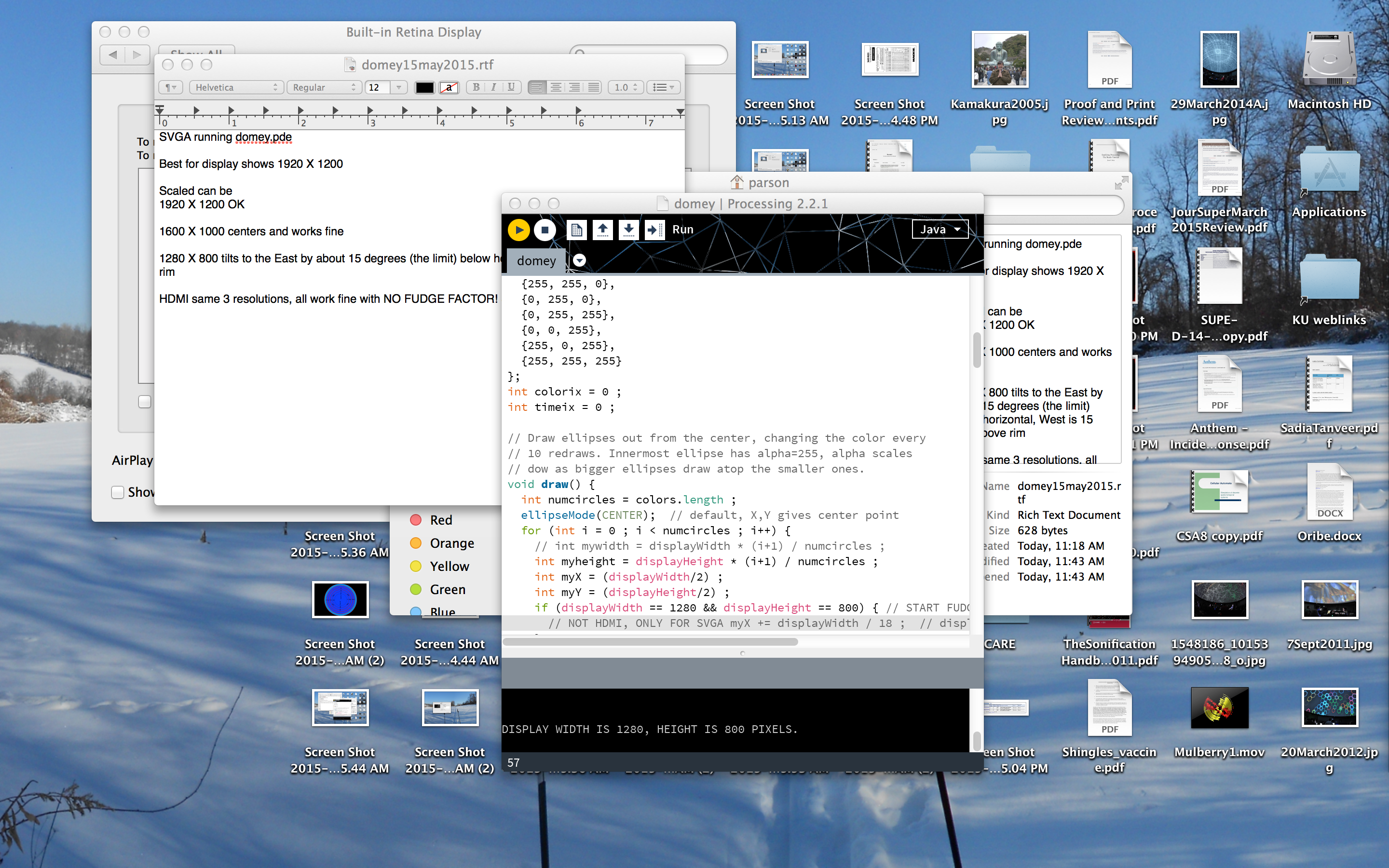

Here are the main results of another study of the projector in the planetarium yesterday, May 15, 2015. Thanks to Michael O'Bannon for asking more questions.
The attached photo shows the three resolution configurations that the planetarium projector presents to my new-ish MacBook Pro (2014) when plugged into the projector using either HDMI or SVGA. These settings come from the projector.
1920 X 1200 (same as what you get with "Best for Display")
1600 X 1000
1280 X 800
Some specs for the projector are here. Look at the Full Dome column (not the Truncated column) of the specs. Our planetarium is full dome with circular seating.
RULE 1 (CLIP TO A CENTERED CIRCLE): In fulldome mode the projector has a max resolution of 1920 X 1200, which you need to clip to a 1200 X 1200 circle that is centered in the display. If you plan on setting up at 1600 X 1000, then clip to a 1000 X 1000 circle centered in the display, and if at 1280 X 800 then clip to a 800 X 800 circle in the center if the display. Of course, 1920 X 1200 clipped to a 1200-pixel diameter circle gives the best resolution, as long as your laptop & software can drive it without stuttering using at least 30 frames per second.
IF YOU DO NOT CLIP TO A CENTERED CIRCLE, YOUR PROJECTION WILL GO OFF DOME & BLAST PEOPLE IN THE BACK ROW IN THE EYES. The projector can project 15 degrees below horizontal.
RULE 2: If at all possible, use HDMI instead of SVGA. Sometimes the 1600 X 1000 setting under SVGA shifted about 10 degrees to the west, and the 1280 X 800 setting always did so when plugged using SVGA. HDMI never had a problem on any of the three settings. Use HDMI.
There are two graphics chips in my MacBook, one for driving the built-in display, and the other for the outbound display #2. Here is what "About This Mac -> More Info -> System report -> Graphics Displays" shows for display #2 when resolution is set to 1900 X 1200; the GPU itself can apparently drive up to 2880 x 1800 pixels:

At 1600 X 1000 the setup shows this:

At 1280 X 800 it shows this:

  Rotation:   Supported
  Television:   Yes
There are two additional photos attached to this post showing screenshots for both display from a Processing script that sizes itself to the display size of the dome projector, in this case for 1920 X 1200. Another post further down in this thread shows the other two settings. Assuming that electro-music does not resize images, the screenshot from the dome projector should weigh in at 1920 X 1200. Note that it is my responsibility to clip to a 1200 X 1200 circle in the center. Here is the Processing script I used to study the dome.
Code:
// Getting Processing to work on the planetarium dome.
// D. Parson, Summer 2014
/* NOT NEEDED IN 2.X
See http://wiki.processing.org/w/Window_Size_and_Full_Screen
public void init() {
  frame.removeNotify();
  frame.setUndecorated(true);
  frame.addNotify();
  super.init();
private PFont pfont ;
void setup() {
  size(displayWidth, displayHeight);
  background(0);
  pfont = createFont( "Courier", 40);  // use a fixed-width font!!!
  textFont(pfont);
  textAlign(CENTER);
  println("DISPLAY WIDTH IS " + displayWidth + ", HEIGHT IS " + displayHeight + " PIXELS.");
boolean sketchFullScreen() {
  return true;
1920 X 1200 screenshot of the dome projector. It is your responsibility to clip to a centered circle. HDMI and SVGA both work OK at this resolution.
 Filesize:  255.68 KB
 Viewed:  998 Time(s)
Here is what my Processing script shows for the 1920 X 1200 screenshot.
 Filesize:  3.89 MB
 Viewed:  1032 Time(s)

Here are screenshots related to previous post for 1600 X 1000 and 1280 X 800 projector settings. SVGA sometimes has offset problems for 1600 X 1000, and always does for 1280 X 800, so plan to use HDMI if you plan to down-scale to either of these two resolutions.
This program does not scale the text point size to match the display. That accounts for the differing text offsets in these 3 screenshots of the dome (2 here, 1 above).
1600 X 1000 screenshot of the dome projector. It is your responsibility to clip to a centered circle. HDMI always works OK; SVGA sometimes offsets to the west.
 Filesize:  205.34 KB
 Viewed:  1007 Time(s)
Processing source window for the attached 1600 X 1000 dome plot.
 Filesize:  3.66 MB
 Viewed:  1068 Time(s)
1280 X 800 screenshot of the dome projector. It is your responsibility to clip to a centered circle. HDMI always works OK; SVGA always offsets to the west.
 Filesize:  182.23 KB
 Viewed:  1141 Time(s)
Associated 1280 X 800 Processing source screen.
 Filesize:  3.68 MB
 Viewed:  1043 Time(s)

A lot of diagrams on this thread, no? Less than 2 weeks to go!
EDIT, FORGOT THIS: Michael O'Bannon wrote, "On the projector diagrams (electro-music forum), at what degree is the workspace for the VJ's?" I replied as follows.
I don't know whether the VJs will use the podium at the north, or whether I will set up a table nearby. I will configure tables for both options. In any event you will be somewhere near that north side of the circular wall, with eyes somewhere between 4' and 6' above the floor, depending on sitting versus standing. We have high stools at the podium, although I think lower is a little better. Clearly, the only way to see everything would be to be in the center of the room, lying on your back, except then the central podium would block the view. For sitting or standing, the edge is better. The VJs will be near the north wall, and the musicians will typically be near the center. For my 11 PM Sunday set in which I will do both visuals & music, I will be in VJ position.
The projector is not 8 ' high. 6' is approximate -- I haven't measured it, but I have reached out to remove the lens cap often enough. It is adjusted so that the height of its rectangular display just covers the dome N-to-S with 1200 pixels; the bottom of the computer display is south; width overshoots the dome unless you clip to a circle with a radius = display height. The podium under the projector is somewhere between 4' and 5' across. Again, I haven't measured it, but I was curled up inside of it the other week, looking for the HDMI jack. It was pretty cramped in there.
EDIT 2: Updated mixer diagrams after testing & debugging.
the room
 Filesize:  160.66 KB
 Viewed:  965 Time(s)
the mixer cabling to speakers
 Filesize:  1.73 MB
 Viewed:  1022 Time(s)
the mixer, front side
 Filesize:  739.69 KB
 Viewed:  1115 Time(s)

Do you have any recommendations on what I should do about that, or about improvements to the sound system in general?
Dale, the use of the consumer grade multichannel AV receiver was probably the weakest link in the audio chain. As time passed I, and I believe yourself and Phil, became convinced that the amplifier was entering shutdown possibly due to heat build up but more probably because of levels greater than what the amplifier could sustain. With that being said, we will need Phil to assist in providing the specifications for the passive speakers that we need to drive in terms of their power & impedance ratings. From there, I recommend suitably rated class "D" amplifiers to drive these speakers. Class D amplifiers are light weight, withstand "Pro" audio levels, very efficient, and run cooler than other amplifier topologies. A good amplifier example would be the CROWN XLS series. Only two (2) channel units for Front L/R and Rear L/R and one more mono amplifier for the Center Channel. A 200 - 300 watt powered SUB can be used in place of the passive unit mitigating the necessity for another outboard amplifier. Most amplifiers have built in signal limiting also thus no external units are required.
Other things to consider:
Cable Tester with Signal Injector (Behringer makes one for $29.00)
Spare 10 to 20 foot TRS Cables
Spare light source for "Digitarium" projector
Spare FOH mixer with EQ/DSP FX
These are a couple suggestions for improving the sound system
Bill

While we are reviewing, let me know what you think of the high color saturation of the linked color photos, relative to how colors appeared to eyeballs at the event. Do you think it's because of CCD color sensitivity, or exposure time relative to eyeball time, or something else? There has been some discussion of that since I posted the photos.
The existing projector is color-disc DLP, right? (I remember seeing rainbows as I flicked my eyes across the room.) Over time the gels in the spinning color disc may fade (from saturated to transparent), resulting in lower saturation, so one relatively-inexpensive option might be to check the color disc and replace it if it's out-of-spec.
Another option would be to replace that projector with a 3-chip / non-color-disc projector. In my experience those tend to produce more vivid colors.
