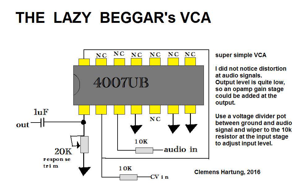

kybernetika
Joined: Mar 30, 2016
Posts: 6
Location: NL
PostPosted: Mon Oct 31, 2016 11:01 am    Post subject: Reply with quote  Mark this post and the followings unread
this is another variation on the 4007 vca Idea
 Filesize:  56.7 KB
 Viewed:  1106 Time(s)
