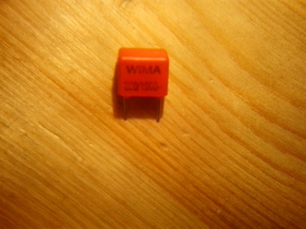

PostPosted: Tue Aug 25, 2015 10:48 pm    Post subject: Capacitor that I used to Reply with quote  Mark this post and the followings unread
Hey Gdavis, thanks for answer so soon, ok I check that, but I think that this is not the problem, I have a lot of synths and I know how to sound a Square or a Sine in my ears, you know what I mean, you don't need to see it, Smile
I am checking now voltages, resistor values and all components, I made the three VCOs at the same time and I think that the mistake is the same in the three VCOs, I'll tell you later the progress.
This is the Cap that I have in my Pcbs,
220/1000 and in the other side 2.5
I don't know if this the reason. Other question is checking the schematics I saw in the Capacitor C7, in the layout of appears like 47p, but in the schematics and in the colored layout of components is 100p, I put 100p, is this correct?. Remember my VCO is BC547B version.
