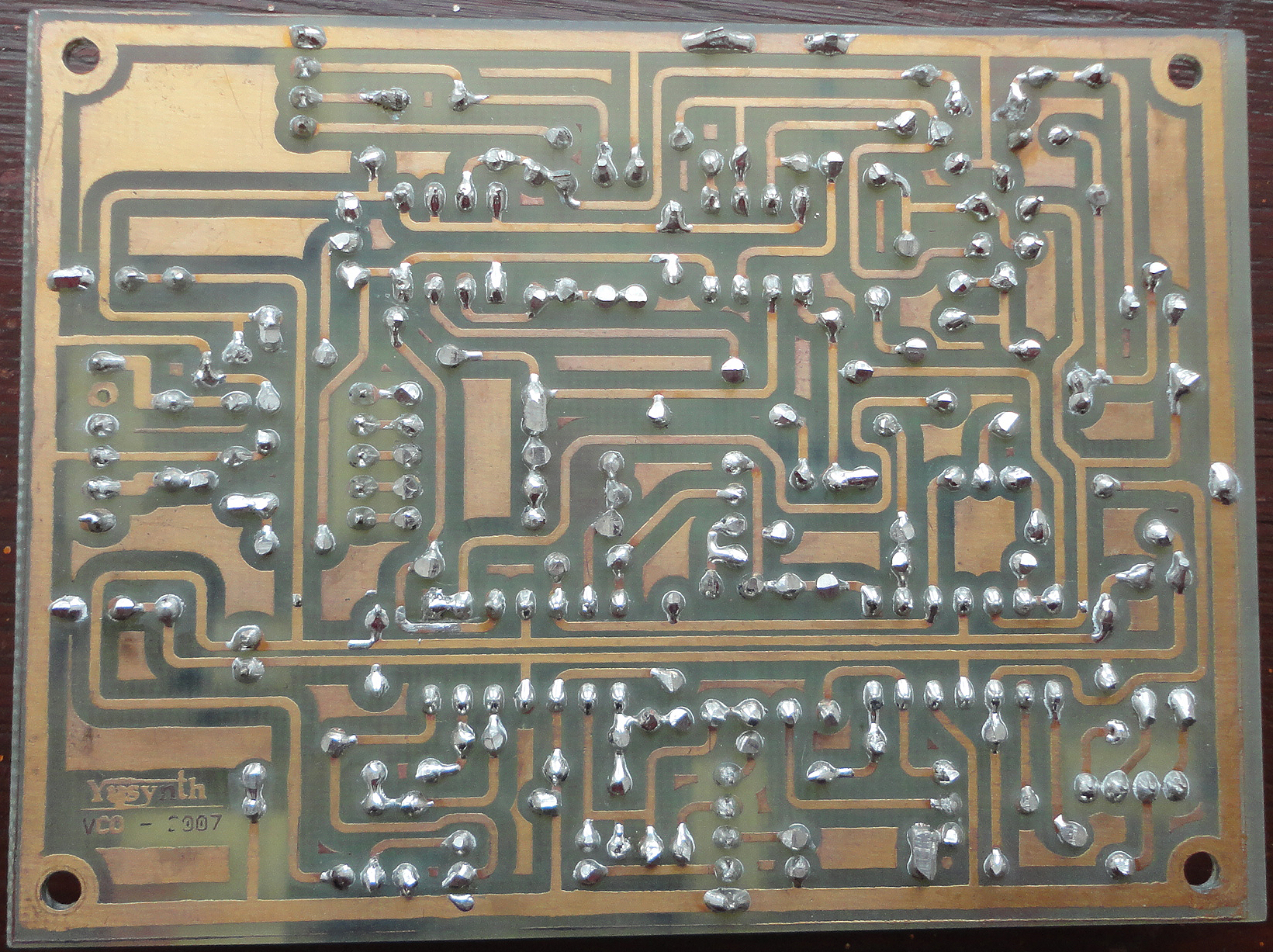

What I already did was checking the whole PCB for cold solder, bridges and I followed with the multimeter the track from the IC6 (TL074CN) checking all the solder points and components up to the PULSE jack and everything seems to be ok.
I used all decoupling caps ceramic, and 10pf silver mica, the rest of them styroflex 1% and 5%.

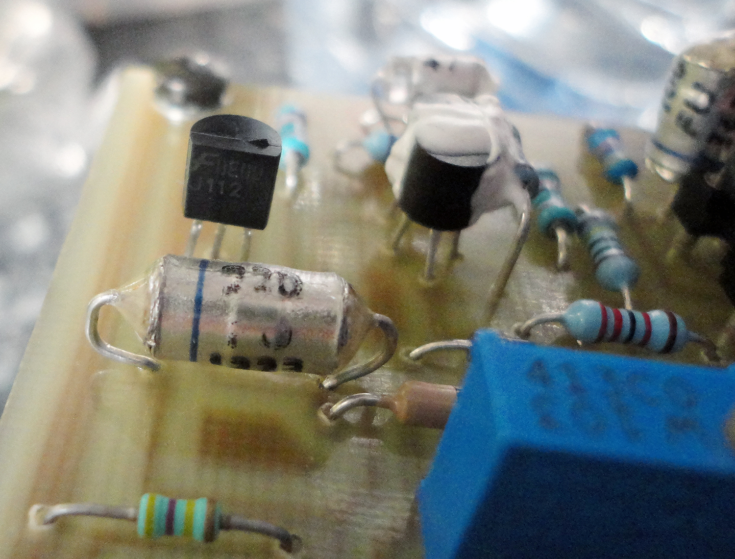

Before soldering I measured every component and selected the closest values. Transistors (Fairchild BC550C) were matched using Atlas DCA55.
I already replace the TL074CN twice, but that didn't make any difference.

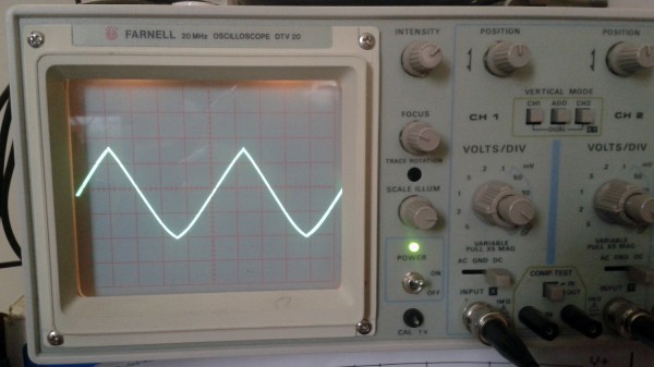

I did the calibration to see if that was the problem, watching the scope I noticed that SIN is not that nice, more close to a narrowed triangle and sounding a bit like that, TRI is fine and SAW is fine.
I should mention that it tracks pitch perfect across the 5 octaves of my MIDI controller, I am using ACX MIDI2CV, however the CV of this VCO is still uncalibrated, the trimpot is as it and works like that!. Smile

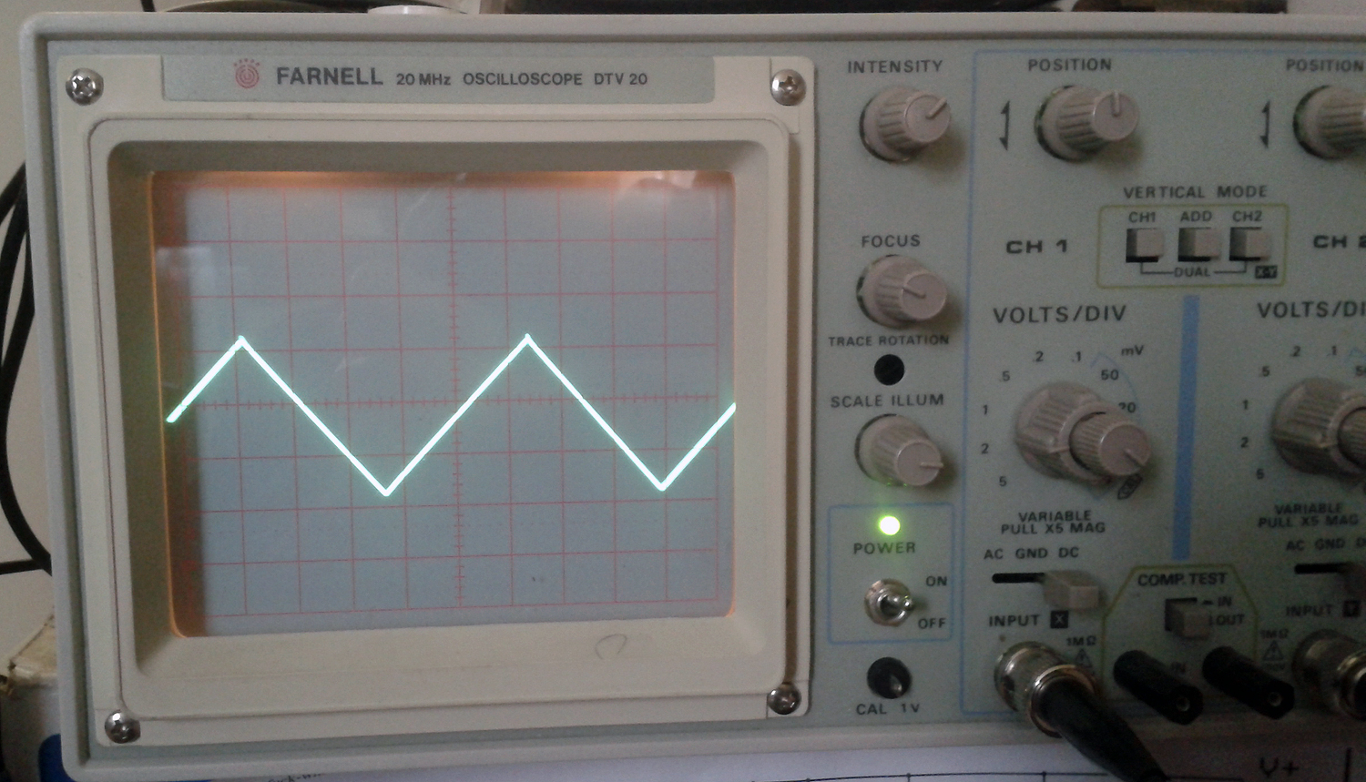

I recalibrated it and I discovered that something is wrong, SIN is almost like TRI in the scope no round peak at all and voltages are too low:
(Scope set 2volt/Div)
SIN:+3.8v -3.8v
TRI: +3v -3v
SAW:+3v -3v
PULSE: +5v -4v

OK, so now it looks like there's a problem with the SAW amplitude out of the core.
Low SAW amplitude leads to low TRI amplitude. Low TRI amplitude leads to incorrect SIN shape. So we need to focus on the SAW.
I'm also concerned about the pulse not being symmetric, maybe a power supply issue.

Did you use a J112 for Q1? Did you check the pinout?

I cleaned up that trace however I already check that with a 10x magnifier lens and despite there is some flux stain in the picture multimeter shows no resistance at all, just in case I cleaned it up with isopropyl alcohol.
I checked on the PCB unplugged and all connector out and there is no short between rails +-15 and no shorts between 7815 and 7915 outputs...
I'm gonna clean the whole PCB with isopopyl now to be 100% free of flux.

After an isopropyl cleaning, it looks a lot better and as you can see on above readings are now much better (specially after replacing the faulty power cable , I guess I ruined it after pulling it so many times from the PCB). Recalibration din't make any improvement so far.
Still something is wrong.
Could it be the high Hfe on matched pair that are BC550C intead of BC547B ?
JRC

PostPosted: Tue Oct 13, 2015 3:34 am    Post subject: Readings and pics Reply with quote  Mark this post and the followings unread
Hi Gary,
Thanks a lot man, I can't believe is so hard to trace this fault.
Yes, C8 reads in one leg 4.58V in the other one 0.99V.
With the VCO turned off, across C8 I have like 40 ohms, almost a short but I guess that is because of the FET transistor (J112).
Yes, R20 is a metal film 5% 33K, however, which is even more annoying, I've hand picked every single component and (except for the IC) I have each of them measured to be sure they are the closest value to the circuit.
I am including some pics, Q1 (which I belive is in th right place), also with COARSE set in 4.5 ( almost centre) I put all of the output in the scope and took some pics of (SIN, TRI, SAW and PULSE), SIN looks pretty odd to me, maybe that could help? dunno.
Still if I move Pulse Width knob far from -3 or +3 in the panel scale, PULSE goes up or down in the scope as a flat line I guess around -15v +15v.
Off topic: is that synth you are bulding 16 VCOs? looks like a headache to me Confused trying to make right just one VCO Embarassed
Cheers mate,
JRC

JRC4558D wrote:
Hi Gary,
Ha! Well everything we've done would have taken a few minutes if I was sitting there with ya. Long distance debug is tricky. And in fact, I'm starting to think there isn't an actual fault....
You can read in detail below, but the short answer is I think you need to change R23 to the 82k option mentioned in the schematic and parts list.
OK. The problems with the sine and pulse are are explained by the low amplitude out of the saw core. Other than that everything is looking OK. Once we get the core amplitude fixed everything else should fall into place.
FYI, the sine looks like that because of the way the shaper works. It takes the triangle and uses the diodes to round off the peaks. But with the low amplitude, it doesn't reach the point where the diodes turn on enough to really round off the peaks like they should. When we get the amplitude up, the diodes will turn on more and the peaks will be more rounded.
Similar is happening with the pulse. The Pulse Width knob is setting the threshold where the pulse output switches between high and low. But with the small amplitude out of the core, the threshold set by the knob exceeds the amplitude of the saw early, causing the output to flat-line.
Back to your issue, I've been thinking about it and I think I might have run into something similar with the boards I laid out. I was getting a low amplitude as well. I thought it was because of my layout but maybe it's something else. I'll have to go back and look at my schematics but I think I solved it by increasing the value of C10 to extend the reset pulse.
And now that I think about it some more, you could also fix it by adjusting R23. If you look at the schematic and parts list, there's a note stating that you may need to use 82k instead of 100k. This will increase the amplitude out of the core, and I wonder if this is the reason why Yves included this.
82k may not get you all the way there, but it will get you closer. You might need closer to 66k to get a full +/-5V output.
If you want to have a look at the reset, try hooking your scope up with channel 1 on the gate of Q1 and channel 2 on the saw output. Trigger on channel 1 and zoom the time scale way in so you can see the short pulse. Compare this pulse to the saw resetting. When you view the full saw wave, the reset looks instantaneous, but when you zoom in this close, you should see a slope during the reset pulse. Increasing the duration of the reset pulse should let this slope continue further giving you a larger amplitude in the saw.
