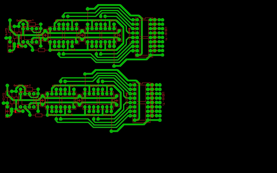

PostPosted: Thu Nov 05, 2015 2:53 am    Post subject: Reply with quote  Mark this post and the followings unread
Hello there
Well here's a look at the 2 PCB's. I believe, subject to checking, that everything is correct. Both are 98mm X 80mm One is the Logic Board which also has the 4017 and drum trigger circuits on. The other is the Pulse driver board and LED display.
14 Chips in total to drive either one drum module, in 1 x 16 mode or 2 drum modules in 2 x 8 mode. I hope this is going to be worth it! Especially as the intention is to build multiple units.
Here's the pics.
Fen

Hello there
Well stuff has been ordered to get on with the build. Sadly I realised a little late I'd neglected to order the 3.5mm stereo sockets needed to interface I/O. but there ya go Very Happy
In the mean time I keep fettling the PCB layouts slightly. I'm pretty happy with the result. Both boards have a good power route to all parts now and I'm pretty sure everything is correct....... Subjct to further checking Smile
Also been playing in GIMP with panel layouts. One for the wiring and one for the front view. These are done as if there are the full 5 sequencer circuits, as planned, rather than just the one that there will be for now.
In the throes of all this it looks like the way this is being done may change. I was aiming at an all in one unit. Sequencer, Drum circuits, Clocks and Clock variants. As it stands this unit may change to 'Sequencer and Clock/Clock Variants'. We shall see how it goes.
Also nearly finished my mini amplifier Very Happy Outstanding is a pair of small brackets to tie the heat sink to the metal back panel for stability and something to 'fill the access hole' with. I was going to make a wood tray for my MP3 player to lay in. But I think a better solution is to enlarge the hole and line it with an ABS form keeping a more low profile finish. The first blue LED died! Checking the 12V DC PSU it is actually putting out just short of 16V DC! So new LED and a 1.5K resistor and it's all good.
The extra volts also mean I am getting around 7W output Very Happy So all that and a bit of paint and the jobs a good'un.
Fen
