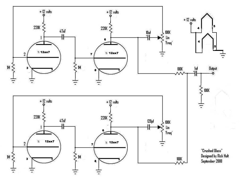

hey Im going to try this out with a set of 12ax7
Does this look right for the pins>?

PostPosted: Fri Nov 06, 2015 3:16 am    Post subject: Reply with quote  Mark this post and the followings unread
Connection to the plate-grid-cathodes are ok, but heater is off.
Connect 12v between pin 4 and 5, leave pin 9 open. If you connect the heater supply according to your drawing, you'll short it.

PostPosted: Fri Nov 06, 2015 11:18 am    Post subject: Reply with quote  Mark this post and the followings unread
There are 2 tubes, two heaters in series?
Am i missing something?

PostPosted: Fri Nov 06, 2015 1:40 pm    Post subject: Reply with quote  Mark this post and the followings unread
The problem as I see it is that the 12ax7 needs twice the heater voltage of the 6111. Connect the two tubes in parallel instead of series so they both get 12V (pin 4 of both tubes to 12V and pin 5 of both tubes to ground).

PostPosted: Sat Nov 07, 2015 12:53 am    Post subject: Reply with quote  Mark this post and the followings unread
I am sorry, yes there are two tubes, each of the tubes need 12v across their heaters.
12ax7 can use either 6or 12v heaters by using the centre tap (or not).

PostPosted: Tue Nov 10, 2015 1:04 pm    Post subject: Reply with quote  Mark this post and the followings unread
Updated
Crushed Glass schematic, for 12ax7 tubes

PostPosted: Wed Nov 11, 2015 6:57 am    Post subject: Reply with quote  Mark this post and the followings unread
Looks good
