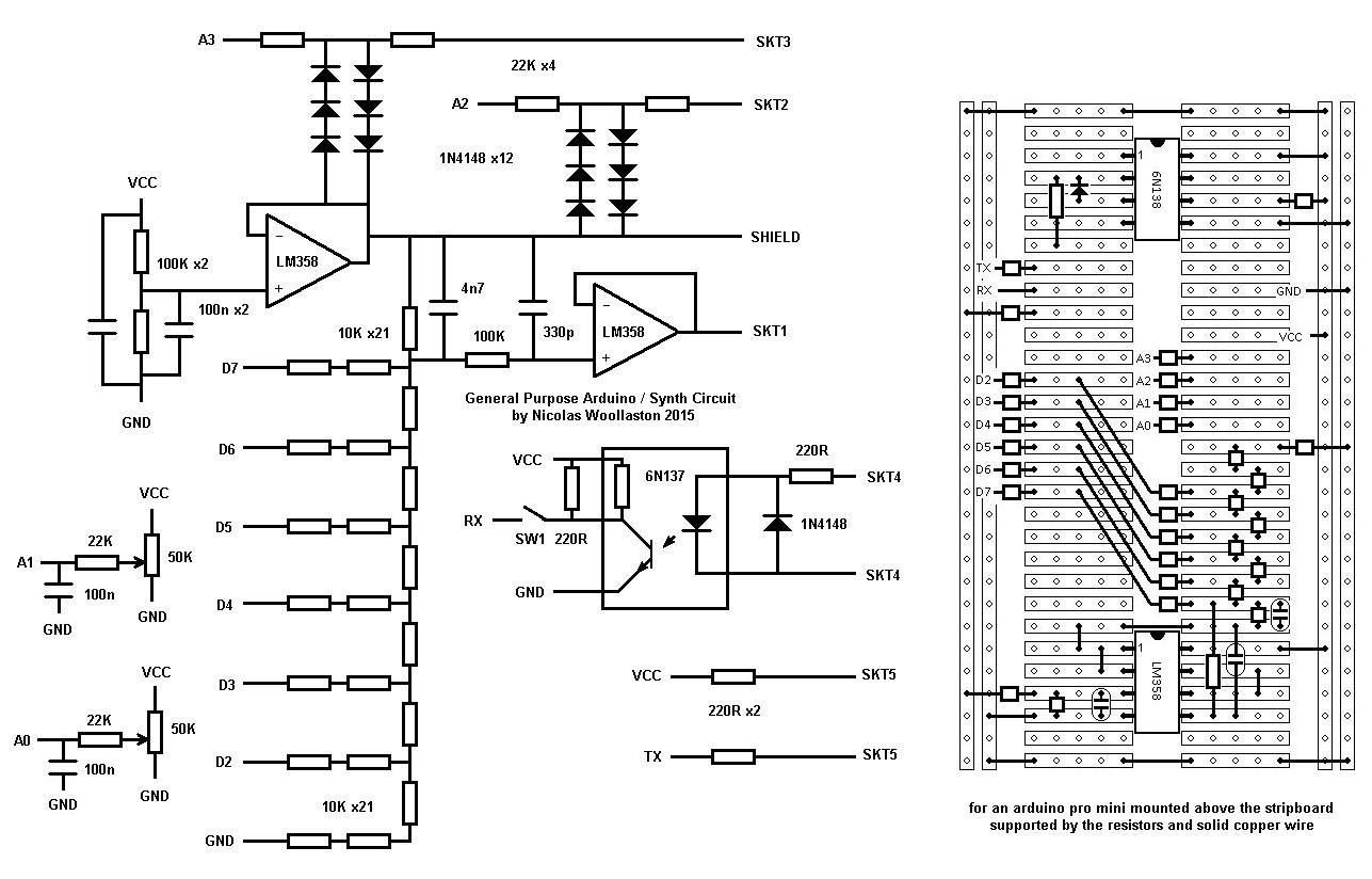

I have just built a basic arduino circuit with these goals:
- using components I had to hand (arduino pro mini 5V, LM358, 6N137).
- midi in.
- midi out.
- CV in.
- CV out.
- audio in.
- audio out.
- plus a couple of knobs.
Which means with suitable software I can have a go at:
- midi processing, midi -> CV and CV -> midi.
- simple midi synth and simple audio effects.
I am hoping a few other people will build something similar and then we can swap coding ideas.
The midi in/out is the standard circuit using the UART on pins D0/D1.
The analogue in is to A0-A3. For A2/A3 I have biased the input to VCC/2 and used diodes to limit the voltage to +/-1.8V which I think makes it better suited to hooking up to analogue gear.
The analogue out is a 6 bit R-2R ladder, but attenuated by half and biased to VCC/2 to give an output of +/-1.25V. The 6 bits are on D2-D7, so if you use 8 bit PWM on D3 you can get an overall accuracy of 12 bits which is good enough for most purposes in the analogue synth world. The analogue output has a 2 pole filter and an opamp buffer.
I built it on stripboard with the arduino pro mini sitting up above the stripboard supported by resistors and a few solid copper wires between the two boards.
Nicolas

Schematic and layout - slight correction in the layout (22 Nov 2015).
 Filesize:  255.35 KB
 Viewed:  700 Time(s)

PostPosted: Sun Nov 22, 2015 2:11 am    Post subject: Reply with quote  Mark this post and the followings unread
A few other people are in the process of building this and while helping them I noticed a minor error in the layout - now corrected in the diagram above. The resistors to ground at the bottom of the ladder was missing one in the layout. Corrected as of 22 Nov 2015.
Apologies,
Nicolas

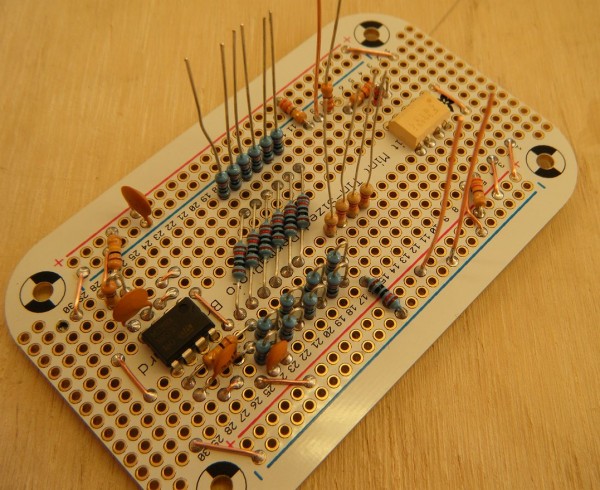

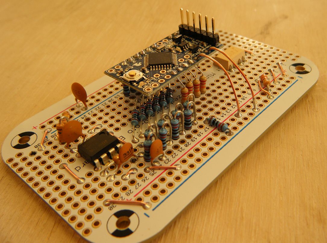

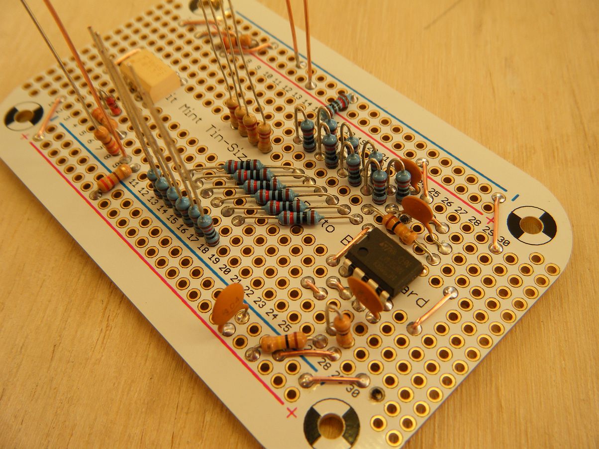

PostPosted: Sun Nov 22, 2015 2:28 am    Post subject: Reply with quote  Mark this post and the followings unread
Some build pictures to show you how I suggest to mount the arduino off the stripboard with the resistors between.
 Filesize:  204.35 KB
 Viewed:  397 Time(s)
 Filesize:  214.03 KB
 Viewed:  387 Time(s)
 Filesize:  165.56 KB
 Viewed:  397 Time(s)
