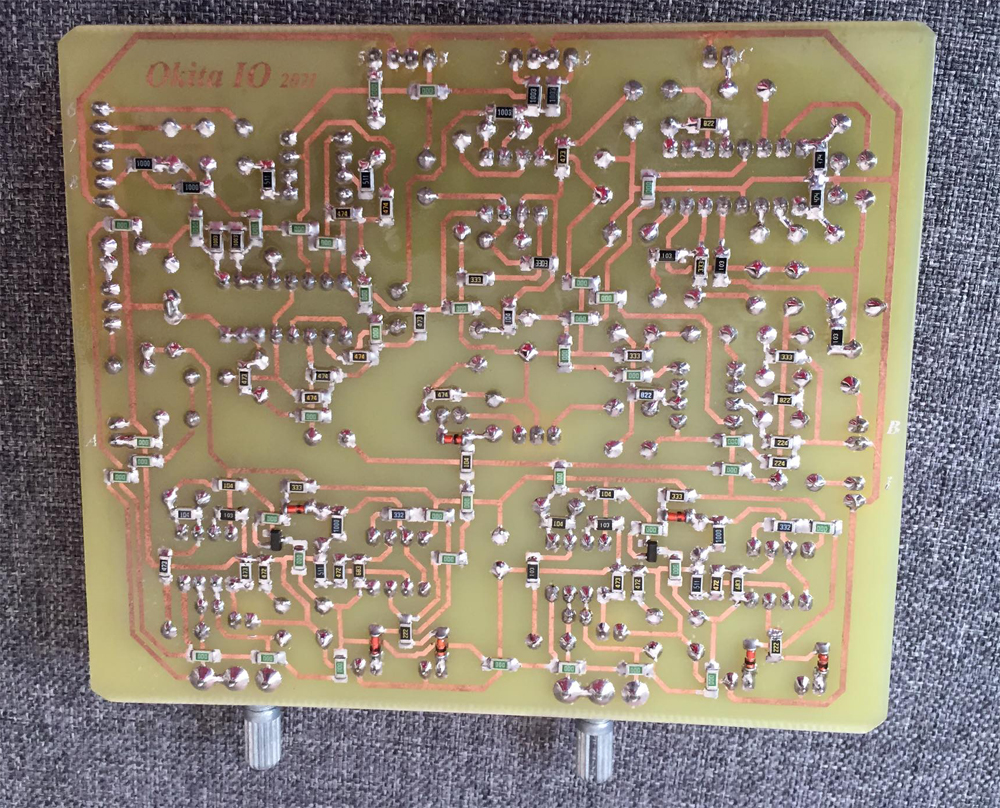

PostPosted: Sun Feb 07, 2021 6:47 am    Post subject: Reply with quote  Mark this post and the followings unread

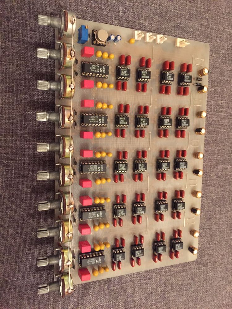

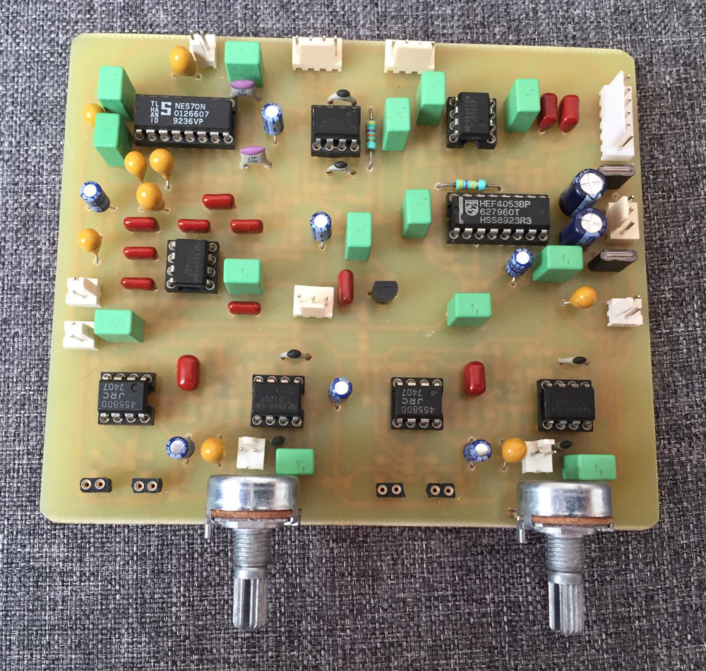

Just to wake up this sleepy topic.
I removed everything unnecessary from the pcb ... Laughing Laughing Laughing
... to the other side.
 Filesize:  742.6 KB
 Viewed:  503 Time(s)
 Filesize:  712.89 KB
 Viewed:  493 Time(s)
best regards, Shenda

the rest of the story... Cool
I want to preserve the "Japanese sound" so I use JRC opamps...
 Filesize:  168.09 KB
 Viewed:  476 Time(s)

Wow! That's very impressive to make it so compact.

Hello all. Where can I find the wiring diagram?
shenda
Joined: Jan 01, 2014
Posts: 10
Location: Rovinj, Croatia
PostPosted: Sun Jan 23, 2022 2:22 am    Post subject: Reply with quote  Mark this post and the followings unread
If you mean Okita vocoder here, at the bottom:
http://experimentalistsanonymous.com/diy/forums.html?dir=Schematics/OOP%20Japanese%20Electronics%20Book
In any case, study the whole tread well.

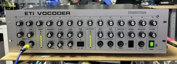

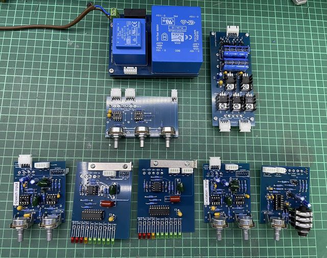

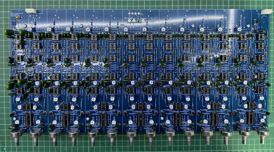

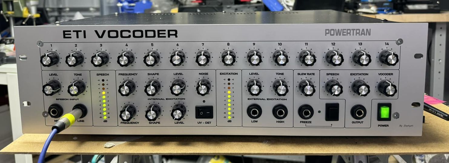

If you are interested in building the ETI Vocoder, I made PCBs like the original
I offer a kit made up of 14 cards, you can contact me by PM if you want one
More information here
https://www.modwiggler.com/forum/topic-278468.html
Like the original
1 Analysis/ Synthesis Board ( the big PCB originally in 2 parts)
1 Internal Excitation Board
2 Input Amplifier Board
2 Led PPM display Board
1 Slew Rate Control
1 Output Amplifier
1 Power Supply Board
1 Test Oscillator Board (Red PCB)
in addition to the original PCBs
2 PCB for jack mounting (for input section Mic/external excitation)
1 Dual Transformer Board
1 Safety cover for Transformer PCB.
