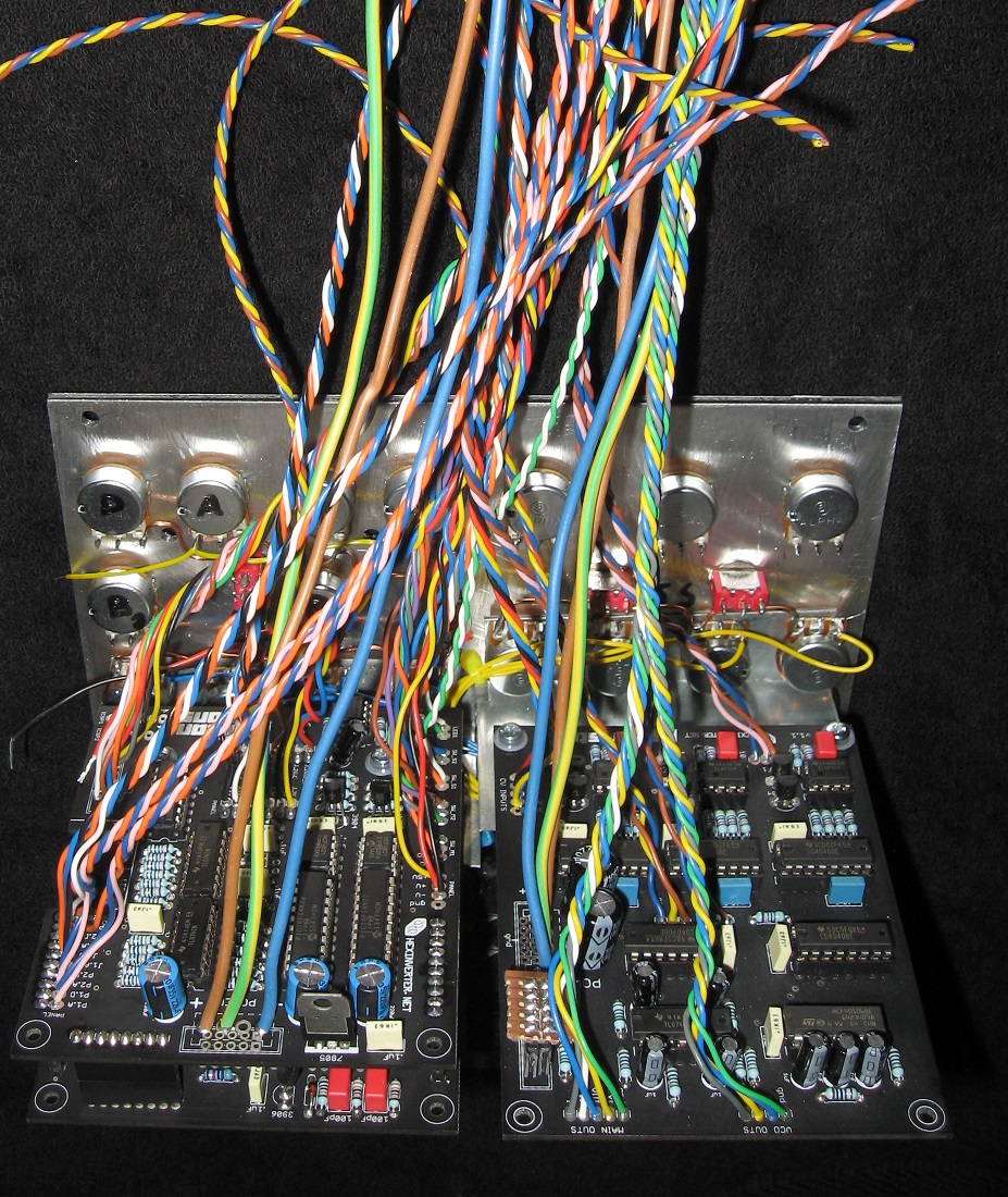

Hi there.
I have been working on the panel layout for these 2 diy pcbs, that I ordered from Hex a while ago. Rather than have two separate single modules I have decided on a double size panel (200m wide by 250mm high).
When I finished the controls layout on corel draw, there was a space free under the Jupiter Storm sockets, I have wanted to use the midi to 8 triggers Elby pcb that came out the old version 1 yellow drum synth (new drum synth has a midi to 24 triggers pcb) and it fitted the space perfect Smile .
Some build pics of the project so far ......
Dave.

PostPosted: Sat Dec 12, 2015 5:14 am    Post subject: Reply with quote  Mark this post and the followings unread
Moons Vca's ....
I wanted an extra cv input for each vca amplitude control, there is 1 input on the pcb for each Vca, so I got the multimeter out , set to continuity beep and I traced vca numbers 1 and 2 cv inputs through inter connects & via holes back to a respective 100K resistor for each input , then simply hook n solder another 100K on the opposite leg from the traced continuity path leg.
Soon be ready to test / calibrate the Jp Storm & moons section , the elby midi to 8 triggers is still to transplant onto the panel after I have the main two going.
Dave Smile
