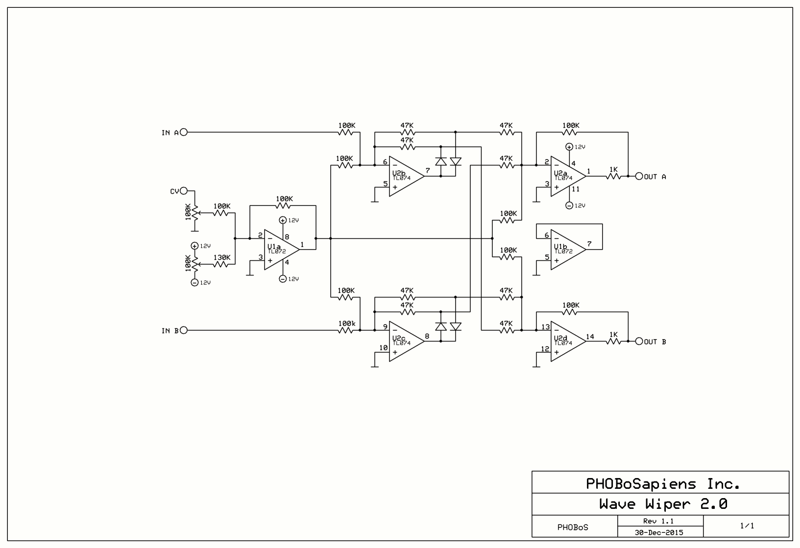

I solved this by changing some of the resistors so that in the first (splitting) stage the signal gets amplified by 0.5 and at the output
stage (merger) it gets amplified by 2. Now the signal doesn't get cut off anymore, although that could be considered a feature,
it did produce some interesting sounds.
I added a attenuator to the CV input, put the 1K current limiting resistors (on the outputs) in the feedback loop to prevent a
voltage drop and replaced the LM324 with a TL074. I also reversed the diodes again as I had them originally. So with a -5V CV
the outputs follow the inputs and with +5V they are swapped. So now it goes from pass through to swapped by turning the wipe
pot clockwise.

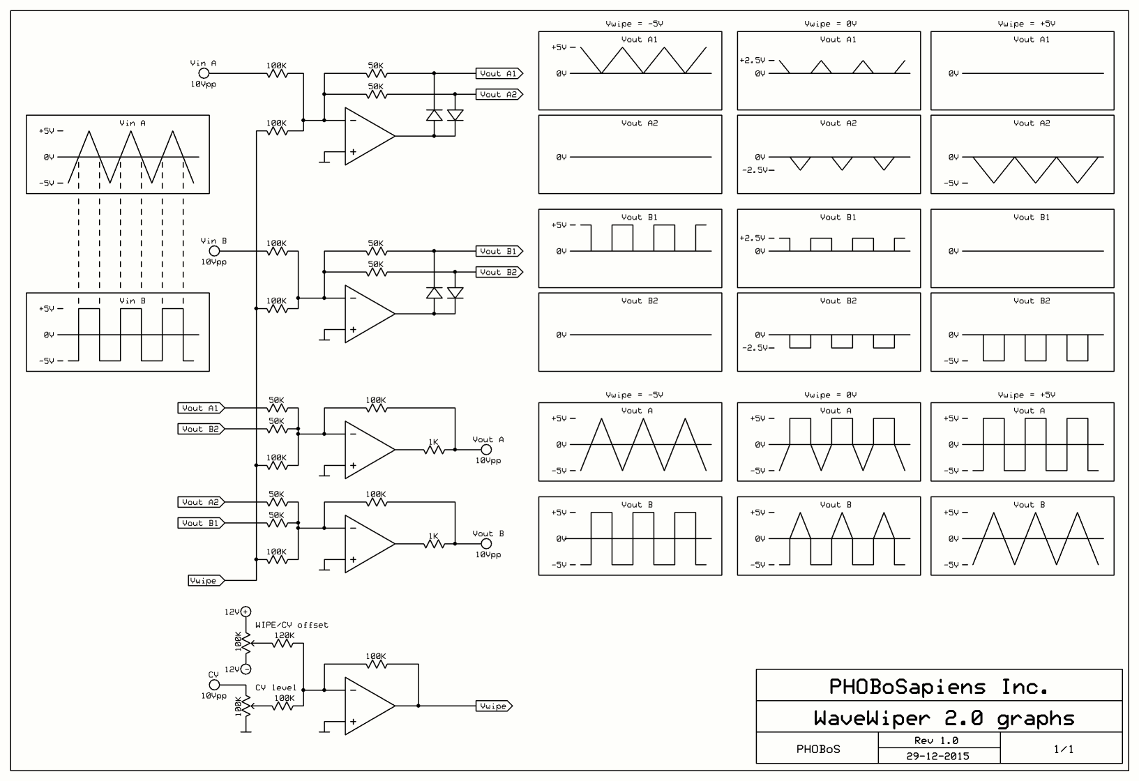

As I was experimenting with it I wanted to understand the circuit completely, see if the math adds up. I pretty much knew how it
operates but not what the actual voltage levels are throughout the circuit. So I did some tests with parts of the circuit mainly
focusing on the voltage splitter section and drew some graphs. I still had the last opamp removed from the circuit (U1b in the
original schematic) which adds an offset voltage and shifts the levels after splitting. I did some calculation and as it turns out the
offset voltage it needs was actually the same as what is coming out of the first CV mixing stage. So instead of attenuating + inverting
that signal and adding it to the non-inverting inputs of the merge opamps I hooked it up directly to the inverting inputs and that
works perfect. Razz

here's the schematic of WaveWiper 2.0 and some more graphs to show how it works. I used 50K resistors as an example to get
nice round voltage levels. The actual circuit uses 47K ones but because I used 100K/47K pairs the end result is the same. Cool
WaveWiper 2.0 schematic

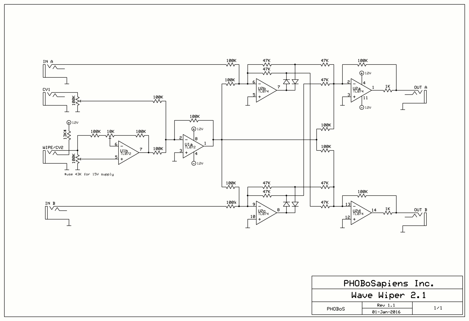

Exemplary stuff!
You could use the other half of the '72 as an attenuverter on the CV input either as replacement or complement to the 100k attenuator.
R
Posts: 5911
PostPosted: Thu Dec 31, 2015 3:28 pm    Post subject: Reply with quote  Mark this post and the followings unread
good idea. Very Happy And I will be able to fit that on the board, which I am going to make a little bit larger anyway.
I do have a bit of mixed feeling about attenuverters though. It's great to attenuate and invert a signal with one knob,
but it's not as easy to set to 0 as a simple attenuater. I've only tried a very simple version though, don't know
if the one with the trimpot makes any difference. So let me try that one too Cool

Posts: 5911
PostPosted: Thu Dec 31, 2015 6:08 pm    Post subject: Reply with quote  Mark this post and the followings unread
so that would look like this Cool

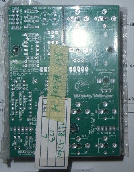

PostPosted: Sat Jan 09, 2016 7:33 am    Post subject: Reply with quote  Mark this post and the followings unread
I just received an order update: boards are ready and being shipped.
banana banana banana banana banana
They also included a photo of the PCBs and it looks good, but it seems that all the holes are filled with solder.
Maybe it's just glare from the plastic since they seem to be vacuum packed, it would be a rather odd thing
to do and I didn't select any extra options. So we'll see how that turns out.

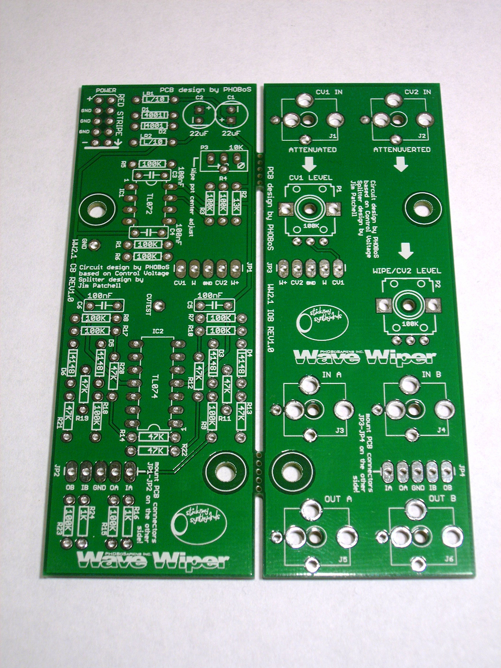

Posts: 5911
PostPosted: Tue Jan 12, 2016 10:49 am    Post subject: Reply with quote  Mark this post and the followings unread
One board has the actual WaveWiper circuit, the other board is for pots and connectors for a euro-rack module
(the boards are sandwiched together with some printheaders in between). And yeah if I look at the 3,5mm connectors at
the top I can see that they are indeed not filled with solder, but it does look like it. I hope they arrive this week Razz .

Posts: 363
Location: Null and void
PostPosted: Thu Jan 14, 2016 9:37 am    Post subject: Reply with quote  Mark this post and the followings unread
ha
looking at the picture a bit more makes it painfully obvious what youve done. doh! Laughing
Shame theres no MOTM power connector, if youre doing a second run it might be worth adding one maybe? (4 pin 0.156 molex).
You can cleverly incorporate the two with very little extra board space -

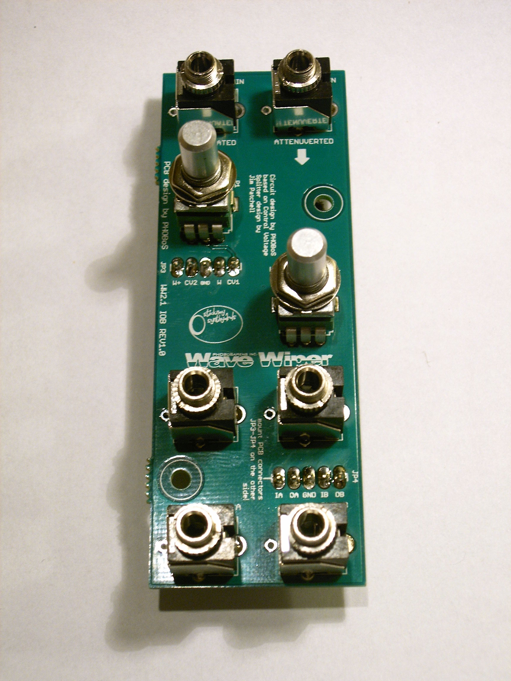

Posts: 5911
PostPosted: Wed Jan 20, 2016 8:03 am    Post subject: I haz WaveWiper PCBs! Reply with quote  Mark this post and the followings unread
party! banana jackson dancing banana party!
 Filesize:  881.32 KB
 Viewed:  706 Time(s)

Posts: 5911
PostPosted: Wed Jan 20, 2016 9:04 am    Post subject: Reply with quote  Mark this post and the followings unread
Laughing
They are beautiful and everything looks purrrrfect. And seperating the boards
by snapping works great! That was a bit scary to try though.
Of course I don't know yet if they will actual work.
here's another photo Cool
(color corrected the photos a bit so they looks closer to the actual color)
 Filesize:  2.27 MB
 Viewed:  749 Time(s)
piedwagtail
Joined: Apr 15, 2006
Posts: 297
Location: shoreditch
PostPosted: Wed Jan 20, 2016 9:51 am    Post subject: Reply with quote  Mark this post and the followings unread
I can see from your neat parts placements how this is an extension of your enjoyment of drawing schematics.
Did you use auto-routing? I never do puzzles, but I really enjoy the 'puzzle' of routing a pcb.
R
Posts: 5911
PostPosted: Wed Jan 20, 2016 3:41 pm    Post subject: Reply with quote  Mark this post and the followings unread
Dave breadboarded the WaveWiper v2.1 to do some tests but he had some problems with the attenuverter part.
I breadboarded it too and got the same results he did while I knew it should work. As it turns out I made an error
in the schematic, so I just uploaded the corrected version. Luckily the Eagle schematic I used to design the PCB is correct.
auto-routing ?! Rape, pillage, kill
And yes I do enjoy those puzzles a lot too Very Happy. And I am used to it, I always design a PCB when building to perf.
But good thing it isn' t my job else would have probably been fired for spending so much time on 1 small PCB.

it works! Very Happy
here is some more pr0n
 Filesize:  381.36 KB
 Viewed:  703 Time(s)
 Filesize:  498.27 KB
 Viewed:  706 Time(s)
 Filesize:  1.42 MB
 Viewed:  721 Time(s)
PostPosted: Thu Jan 21, 2016 9:36 pm    Post subject: Reply with quote  Mark this post and the followings unread
I'm still not sure what these do, but could I buy a set off you? Any panel plans? Smile
