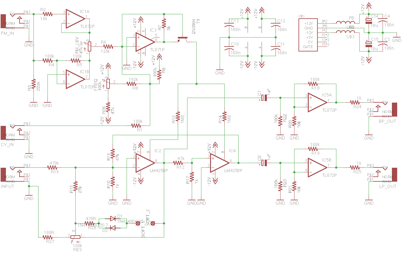

I'm planning to make a no-wire layout for this filter.
How does this schematic look, @isak?

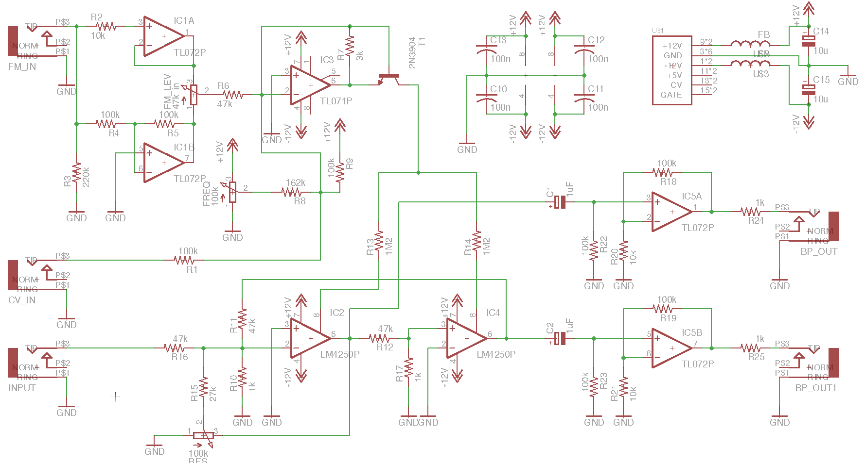

I reversed the resonance pot, but this works well on 12V.
Happy New Year!

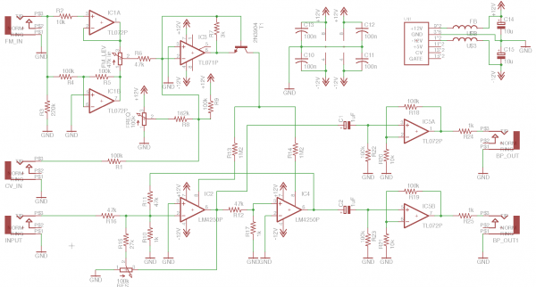

I see you didnt do the layout with the known mods, as i understand they are very good to add.
Maybe you can add them?
I think it would be easy for you.
The mods are listed here:
http://modularsynthesis.com/kuzmin/polivoks/polivoks_vcf.htm

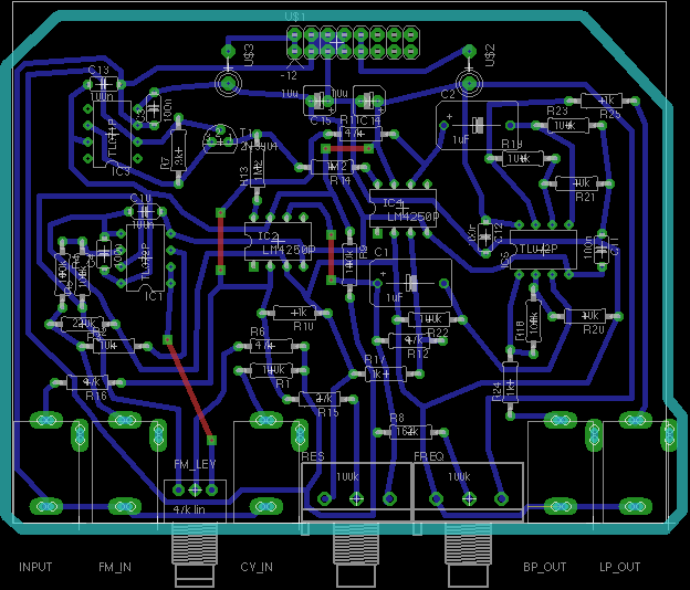

I built and verified that first layout. The github files have the resonance pot corrected and a few tweaks: https://github.com/jbeuckm/Polivoks-VCF
Yes - should be pretty easy to add in the mods.

Here is a working layout with the mods from above. I have not tried the FM input on either layout but the LP and BP are working with Freq/Res controls as expected. I am still figuring out what the "soft" switch does, but it does something.
schematic updated with mods
