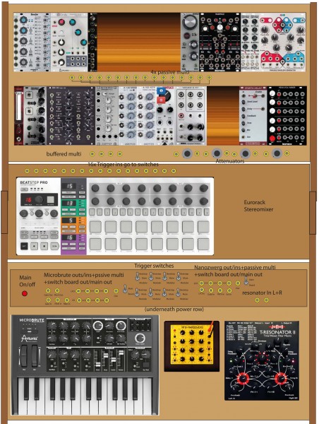

hello all!
after viewing many high prieced cases i chose the hard and cheap way of DIY.
i had tons of thoughts and designs but i ended up with an sturdy allrounder. based on the ever genius buchla portable case design. i improved it by adding a stand/handle solution and outputs for triggers and the mainmixer on the back.
in this thread i will post my steps towards completion and will explain my design. many thanks to felix from the tuesday nigth machines and his post on which i based my work on https://www.muffwiggler.com/forum/post-1626201.html
allthough my design is for eurorack everything except electronics can be converted to other formats. later on i will post the sideparts as a pdf so you can scale them as you wish. the rest is "unimportant"
first of all i will start with the specs of my desired end product.
-must be easy cause i´m a noob to electronics
-It must be portable therefor heavy-duty build
-I dont want to disconnect the cables on the module for transport
-also for studio use
-Microbrute, MFB Nanozwerg, Beatstep PRo and Jomox T-resonator must fit in
-2x3U Frames of 126 HP
-it needs XLR Stereo out for my Mainmixer
-Trigger outs for my Vermona DRM1 Mk3
-Switches that mute the trigger outs and can select a second channel of triggers from the modular
-buffered multis for VCO Pitch
-one row of spread out passive multis make-noise-style
-some attenuators
-make it cheeaaaaaaaap!!!! i`m so '*"§= poor Smile

and first just one frame (cause i only can equip one for the start) from click clocks:
http://clicksclocks.de/category/modular-synth/parts-for-eurorack-cases
with the frame i can later on cut my wood to the precise length and dont have to fiddle around with .03 mm stuff.
next will be a papermodel to check all my thougths for faults and gather the parts.
first Edit:
i forgot to mention that the microbrut, BSP, T-Resonator and the Nanozwerg will be attached with velcro to the case floor.
i am also thinking about adding a protectiv skin to the wood. but i cant make out which one it should be... perhaps i just drop the idea.
also added the dintree stereomixer layout from me. all panels i have to add will be wooden so coloring will be added.
overall i will use intelijel-style knobs because they are rather cheap but still look nice... and i can see them in a dark club.
rubber feets will be added to the "bottoms" of the case (in the end it will have two. one standing and one while transport)
hope this finds your interest and you perhaps find some other thougths for this case idea.
greets ansgar
first design is in zip file attachment

Update:
After some checking i am convinced that the cheapest solution is to use gravity and wingnuts (for the beginning)
as long i dont us super cheap and thin wood it will do.
Here is a picture of the forces at work. i think a few degrees of the top part tiping to the back will stabilize it even more.
also i thougth about adding a ligth to the otherwise useless top lid... and some cable holders to the upper sidepieces Smile every inch must have a purpous!
also i had another look at my older cheap 19" rack i had build for my vermona drm1, the current modular setup and my mb33. i had no rails or anything to hold my gear in place. just screws washers and wood. so i just pre drilled smaller holes and entered a screw one number bigger.
i still carry it around for live and it holds like a tank. only thing is... i cant replace stuff :/ which is pretty bad for modular but i wound come to the point off replacing until next year june sooo... i just skip the rails and rack ears (my modules are mostly secondhand and all have rackrash... cause people sell modules cheaper when they have rackrash. so i just dont need to bother about that...) thus saving money... 100 euros Smile yes!!!
So it will be just the wood i need to buy... ofcourse i will construct it so i still can insert the frames later on. i will just scrwe some thicker wood to the inner side of the upper column and use it as a rail Smile as long as i keep the backside of the modules in mind... lets do some testind on the wood...
UPDATE:
I attached the solution i came up with.
As long as the screw with the wingnuts is on the corner over which the whole thing turnes everything is fine. there are other solutions but they all mean some extra parts or bolds i can fix through holes to hold it in place but one migth lose them and thats not what i want.
so onwards to the paper model!

PostPosted: Mon Jan 11, 2016 3:11 am    Post subject: Reply with quote  Mark this post and the followings unread
This is what I was planning to do. As you can see the fully opened position is determined by the shape of the cheeks.
It will need something of a support, to prevent it from rolling backward, and I am working on a carrying handle.
Ray_Ketamu
Joined: Nov 03, 2014
Posts: 48
PostPosted: Mon Jan 11, 2016 3:28 am    Post subject: Reply with quote  Mark this post and the followings unread
yes in the end it is just implementing what has been done by humanity the last 1000 years. guess some dozen more of same principaly the same solution out there Smile
as you can see in the first post i used the handle as the resting support. perhaps that will do the trick for you too?
it would just mean your middle side part have to be redesigned a bit.
