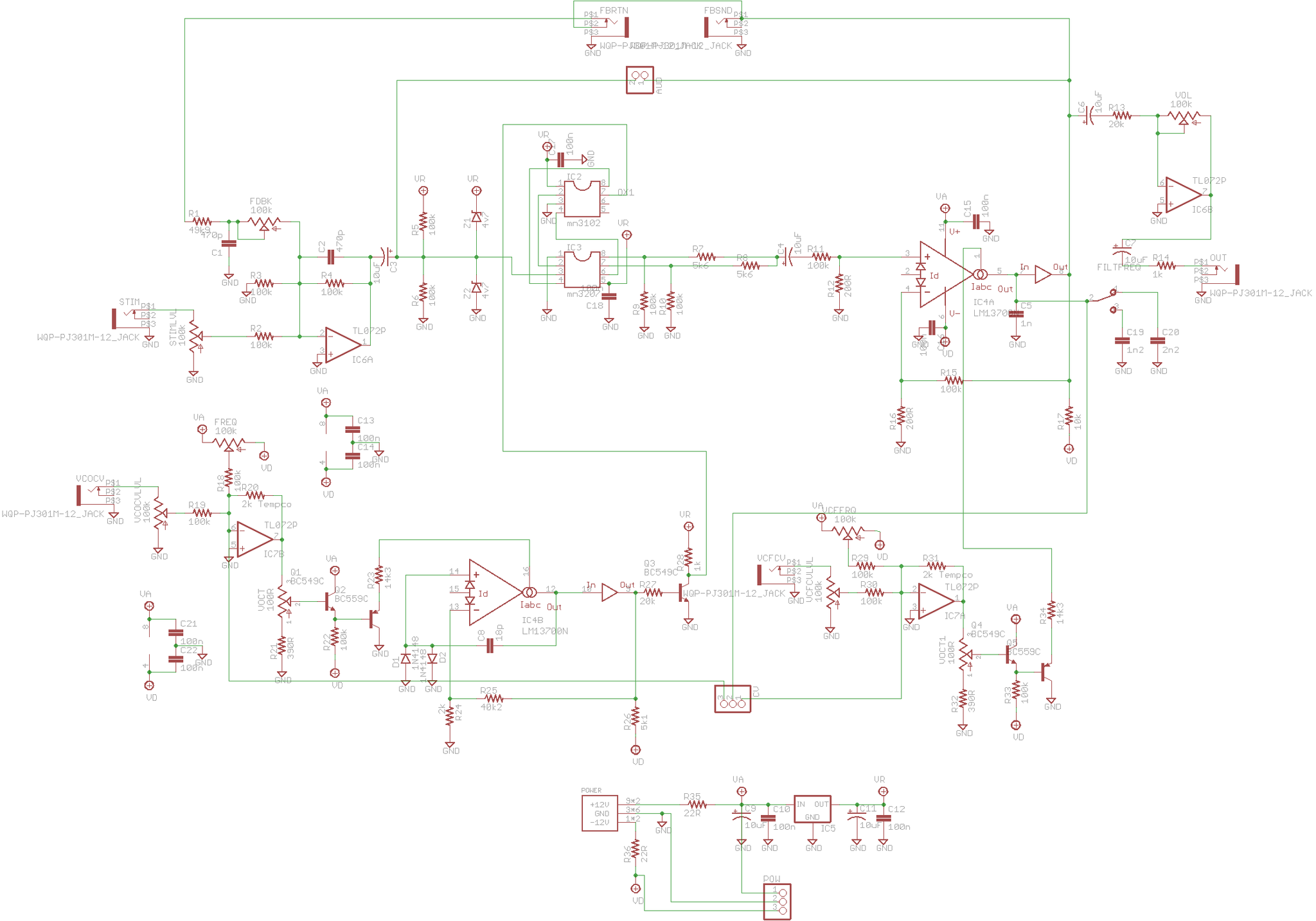

alright built one of these up. any one have any idea what the correct values of r27 and r32 are for 12v power supply? any other necessary changes?
my FBk knob and VCF knob both dont seem to do all that much.
I replaced both r11- 40.2k and r18 49.9k with 47k. and C7 with 2.7n
only 2 2k tempcos for the tranny pairs? I also flipped both of the 2n3906's backwards as mentioned earlier in the thread.
Should I bring all the labelled points on the board to jacks? sum, vol,jls etc...
should feedback send be normalled to fdbk jack? i.e. connected to its switch lug? with attenuator?
different styles of triggers seem to drastically change the tone which is neat!
anyone have any switching ideas for the different kinds of chips?
any other switching ideas. like infinite feedback, or changing out the tone caps in the loops etc...
Lots of questions. I know. really keen on this circuit!@ my first vco so my knowledge is lacking.

Les's Karplus-Strong circuit sounds really, really good!
I had a good fiddle with it today, and the Stim input is vital to getting good sounds out of this circuit. I tried a saw wave into the Stim input, and was getting rather insane sounds, so I googled "karplus-strong synthesis".
Noise is what needs stimulating. Modulated noise. The longer the envelope, the more "breathy" and panpipe-y it sounds.
This is what I worked up from Les's excellent schematic. Didn't have to do any patches due to stupidity on my own part, so that's always a plus. Hopefully Les doesn't mind my putting his name on the front, or E-M!
Thanks for making this circuit public, Les.

I'm getting really close to finishing a build but I'm not able to adjust VCO frequency and the filter isn't having any effect.
I'm building it into a eurorack module so I'm using +- 12 volts on the supply, what resistor are people using for r27 and r32? I think the original 14.3k is for 9 volts if I'm not mistaken. I installed trimmers but haven't had any luck experimenting.
What am I looking for in terms of observable behavior when I have r27 and r32set right? (I have an O scope if that's helpful)
One big hint is that the TL074 is getting pretty warm so I'm looking around that for clues how to proceed.
Thanks all!
PostPosted: Wed Jun 19, 2019 8:41 pm    Post subject: Reply with quote  Mark this post and the followings unread
If an opamp is warming up like that, then you've got a short somewhere, or a wrong value component.
If you have an o'scope, then put a continuous waveform into the Stim input, and trace through the circuit until you find where it stops being passed on. My guess would be that it will be somewhere in the opamp that is heating up. (The bias for the BBD in this circuit is ultra-simple, so it should be fine.)
I just used the stock resistor values for my 12V build.

I've decided to start a new build on a fresh pcb so I can verify it at every step, I also am now using a variable power supply so I can give it +-9. I just re-read the whole thread and flipped my Q2 transistor around, now trying to nail down resistor values.
I have a scope on the TP5 test point (OCV) which is the output of the op amp that feeds to the transistors. The range I'm seeing adjusting the frequency knob is -0.15 to 0.2 volts. From someone earlier in the thread their range was 0.167V to -0.163V which sounds similar enough, might be able to figure out how to make it symmetrical around 0 volts.
At test point 16 (OCC) which is the point right after the transistor stage I'm seeing a range of about -7.9 to 0 by adjusting the freq knob. The trimmer has a minor effect around the middle of the range but minimum and maximum are unaffected. Someone else posted that they had -4.32V to -8.13V. At about 6 oclock way the voltage is near 0 and the rest of the rotation of the freq pot doesn't have any effect.
I had a wrong resistor value messing up my level shifter but I fixed that and I have a decent clock coming out of the level shifter, it could be a more even pulse width but it seems fine.
I'm going to build the rest of board #2 and see if my op amp overheating happens again, this time I'm more prepared to diagnose.
I have learned a lot so far it's been fun!

I got my second build working and I'm super excited! Works well at +-9V and +-12, calibration is the last thing I need to do. I have another couple PCBs and I'm planning on building them eventually. Maybe I'll do 3 to make a power chord polyphonic set someone mentioned in the thread.
Now that I have a known working board I can retest the voltages on my first one. I'm finding a mysterious voltage of VDD on two of my op amp pins (1 and 2) which should be near zero, which must explain the overheating I am encountering. I have the op amp unplugged from the board so it should have any significant voltage. It is somehow related a current path through the 100 ohm pot so I'll be investigating all those paths to VDD.
I have basically memorized the schematic at this point. I feel like I have learned a lot about CV input and 13700 Oscillators which has really given me confidence in planning some of my own designs in the future!

This is what I have
 Filesize:  421.5 KB
 Viewed:  305 Time(s)
ks jack.pdf
 Filename:  ks jack.pdf
 Filesize:  26.31 KB
 Downloaded:  282 Time(s)
ks v0.2 eng.pdf
 Filename:  ks v0.2 eng.pdf
 Filesize:  27.57 KB
 Downloaded:  727 Time(s)
