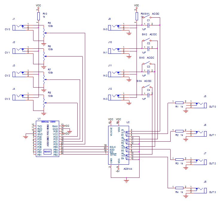

I have been struggling with building a VCA.
Recently I have tried this (with two opto fet's), but that didn't work.
So I thought, what is the easiest control available? Well a potmeter ofcourse!
Why don't I use digital controlled potmeters as a VCA?
This afternoon I have been breadboarding with an arduino and an AD5144 which is a quad 256 position potmeter, available in 10k and 100k.
I just read an (8 bit) analog input and put that value in the register of the digital controlled pot, and it works great!
I knw that there are only 256 possible values, but hey... midi has 128 and nobody is complaining....

This is how I'm going to make it.

This evening I have been digging in the datasheet of the AD5144 and it appeared to me that I have made a mistake: The datasheet says that the max voltage for VDD is 7 volts and the VSS is max -7 volts.
So I thought thats ok, because I'm using just +5 to -5 volts.
But then a little lower the datasheet states that Vdd to Vss is 7 volt max!
Bummer! Because now I have to make sure all voltages are at DC levell...
A little confusing to say the least...

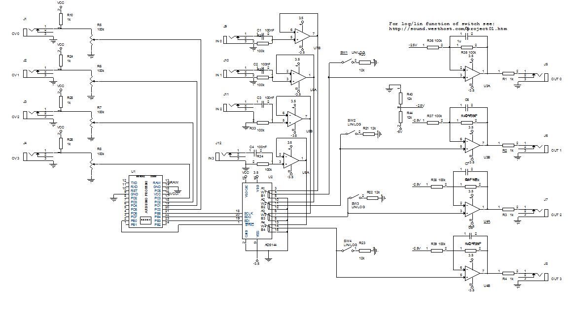

you will get linear steps, that means eg a 6dB step between control value 1 and 2 and almost no change between 254 and 255.
I would use a load resistor of 12k from wiper to GND to get a pseudo log response and then buffer with an opamp. See

The difference between step 1 and 2 is the same as between step 254 and 255, you will only hear it differently Wink
These digital controlled potmeters may be programmed to make 6dB steps, but then there are only 16 possible steps.
The EEPROM is used to store a value to which the potmeters will go after power up (or reset), but I don't use the EEPROM. Besides that the potmeter will function just the sane without the EEPROM.
Good idea about the pseudo log resistor thinghy. Maybe I'll add a switch to choose between lin and (pseudo) log, since I have to use an opamp anyways.
Posts: 1320
PostPosted: Wed Mar 23, 2016 12:55 am    Post subject: Reply with quote  Mark this post and the followings unread
The board is finished (see THIS LINK for pictures).
So now I only need two more "regular" devices, a VCF and a MIXER (mono or stereo with pan, and how many inputs?) to start working on more exotic modules Rolling Eyes
I have lots on nice ideas Idea Idea Idea
Oh...and multiples, and a connection for the scope... Oh... and there is already a half built sequencer.... Shocked
This evening I will try to make some recordings with this 4VCAt.

Posts: 1320
PostPosted: Thu Mar 24, 2016 2:35 am    Post subject: Reply with quote  Mark this post and the followings unread
FAIL
Works fine for control voltages and the lin/log switch works just fine (so not all is lost), but since my musical signals are all around +2.5volt you can hear the speakers pumping with the ADSR voltage.
What I have to do is first have the signals at the input feed thru a capacitor to have the signals around gnd level and after attenuation add 2.5 volt.
Also the input connectors are crappy chinese types, and the switch inside the connector is just lame, so have to work around that too.
So, back to the drawing board....
to be continued...
Posts: 1320
PostPosted: Thu Apr 07, 2016 1:24 am    Post subject: Reply with quote  Mark this post and the followings unread
I have changed the schematics, added some opamps, and now it works great!

Posts: 1320
PostPosted: Tue Apr 12, 2016 7:49 am    Post subject: Reply with quote  Mark this post and the followings unread
It got a lot more complicated....
But it works like a charm Very Happy

Posts: 1320
PostPosted: Tue Apr 12, 2016 9:54 pm    Post subject: Reply with quote  Mark this post and the followings unread
The signals are now AC (around 0volt) so this module is now dedicated to audio signals only for now, but I could change that by adding a voltage to the output and maybe I will...
