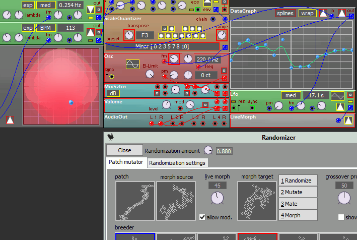

here's a little feature request, one of my favorite things digital modular has to offer is presets and randomize functions. I know making something like the G2's patch mutator would require a decent amount of time, but just wondering if it would be possible to implement a function to randomize params on selected modules, like the nomad G1 editor does. simply select a few modules and hit ctrl - R and boom you find all the sounds you missed while trying to make "that one sound" : )

I don't think it to be too hard to implement, will have a look at it - and will add it to the feature request list. Thanks for your suggestion :-)

Heh .. that was easy indeed.
But now I end up with all automatable knobs / sliders and selectors to be randomized. This means that mute buttons will be randomized as well, which may not be a good idea.
Now I could easily exclude everything that has 'mute' in it's name .. but it raises a question or two ... should there be an exclustion mechanism, and if so .. what would be handy.
Let me have a look at the NMG2 editor ... IIRC tuning stuff can be excluded there ... which means knobs should be categorized .. which in a way they already are, but there is a large amount of categories currently. Hmm .. the Mac needs a reboot for that - it lost the Nords it seems.

I think I can make something decent out of this.
What I did for now is that I excluded the mute controls from randomization by default.
I've made it possible for the 60 or so different kind of control types to enable or disable randomization - but have no user interface for that yet. I may want to add some categories for this to group stuff a bit.
I've made it possible for individual controls to enable or disable randomization, and these settings will be saved with the patch. There is no user interface for this yet.
Old patches will be read OK, applying default settings for randomization allowance.
New patches will be read OK by old Wren versions as well, but the patches will loose all randomization allowance settings when saved.
This would give reasonable patch compatibility between old and new versions I think.
I'm planning on adding a randomization allowance option for modules, which by default will be on for most modules but for a couple of types it better is disabled by default probably (like the Volume module).
I will implement some user interface elements where they are currently missing, but not quite sure how yet - I would like categories for control types maybe. This user interface should allow for enabling randomization on mute controls too.
Currently the action menu has a randomize entry which will randomize controls on all selected modules (Shift + Ctrl + R, Ctrl + R was in use already). Also I made an entry on the module popup menu. When the module the menu is called from is selected it will do the same as randomization from the action menu. When that module is not currently selected it will be selected uniquely (deselecting all other modules) and then do the same as the action menu entry.

I've made it possible to exclude certain modules from randomization too - this unfortunately needed the patch format to be changed a bit, sot that's upped to version 5 now. There will be backwards compatibility still, but no longer forward compatibility - as in new Wrens can read old patches, Old Wrens can not read new patches.
Implemented some popup menu items to control all of it, and exclusion settings will be saved in the patch.
Decided to exclude all I/O modules from randomization by default.
A control can be randomized when :
- it is on a randomizable module (this is under user control).
- it is automatable (this is not under user control).
- it is not locked (this is under user control).
- it allows for randomization (this is under user control).
- it is not of a type for which randomization currently is disabled (this is not currently under user control, but will work on that).
- it has more than one possible value (this excludes the momentary buttons, this is not under user control).
I've made a randomize menu item for knob and selector popup menus to allow for a single control to be randomized (instead of all controls on the module).

Ok, it basically all works .. ended up with:
Where excluded stuff is marked in red in the patch - click on the image to see a larger version.
Some details to fix still, like I would like to be able to set the amount of random to be applied maybe.

Well ... this is it for now :

To clarify a bit ...
The randomizer window holds the defaults for any new modules added to the patch, and it can change the random settings in a patch for categories.
The Module categories only act to control the Randomizable module types - these settings are not saved, and they should probably be buttons instead if checkmarks (except that there is a somewhat nice standard component in Delphi to automagically build a set of checkboxes and not one to do the same for buttons - or so it seems).
Apart from that, at design time some controls that can not be randomized will be excluded from randomization.
Apart from all that, it is always possible to override settings on a module by module and on a control by control basis from the patch itself.
When a patch is saved the actually excluded stuff is saved with the patch, and this will be used again when the patch is loaded (regardless of what may be set in the randomizer window at that time).
The randomizer window settings are not saved with the patch, they are saved with other Wren settings in the main Wren ini file.
The Randomization amount is saved with the Wren settings as well, the default value will be 0.5. Lower values make the randomization less jumpy, but it will also cause controls that do not have many positions to not change anymore.

Made the randomizer work on the XY type controls and on the DataGraph thingie too.
Also the mutator seems to be working OK now, it works on XY thingies and data graphs even when inserting or deleting data points and it seems to survive module insertions and deletions as well.
Some more testing is needed, but it will be in the next release I guess.
it now looks more like :

Had another idea agai. Added a morph source and target and a knob to fade between those, calling it 'Live Morph' .. now it would be nice to have a module in the patch to control that knob Shocked

The mutator implements a primitive genetics tool. The idea is that the parameters of the patch form a genome. This genome can be altered by the mutator in a sexual and in some asexual ways.
The graphic images are a visual interpretation of the parameters present in the patch. Every parameter is represented by an angle, and then a line is drawn under that angle to the next parameter - which forms the worms. Worms are then scaled to fit the cage they are in.
Asexual reproduction can be plain random .. which does not really reproduce anything (as all information is lost), or a mutation (which does keep some information and looses some as well). Mutations can be controlled with a probability and a range. The probability sets the chance that a a change occurs, and the range determines how much of a change can occur.
Sexual reproduction picks parts of one genome and parts of another and makes a mix of that. The crossover probability determines how often a parameter pick switch is made from the first to the second 'parent'. Also in sexual reproduction there is some mutation involved.
In the randomizer window the parents are in the breeder bit, the leftmost one being one parent and the rightmost one the other.
The mutate button just mutates the existing worms between the left and the right parent. The randomize button sets random genomes for the same six and the mate button performs the sexual thing with both parents leading to a a sixling .. erm .. if that is a word.
And then you can drag around stuff, like drag a worm onto the patch worm to make the patch have the dropped params. Or drop something on the left morph and something else on the right one, and then you can do a live morph between those.
The scratch area is just that - drag stuff there for later use in one of the active squares.
Clicking on a worm will copy it to the patch, this happens for the morph and scratch things in the same way ... but you can also drag worms to the patch square.
Then when you have a left and a right morph the live morph control can fade between the two. This can also be automated by using a LiveMorph module in the patch, with a checkbox to enable or disable the function.
