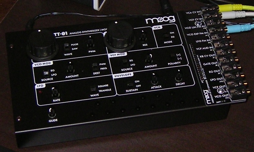

PostPosted: Sat Aug 20, 2016 9:23 am    Post subject: Modification 1 Reply with quote  Mark this post and the followings unread
From an electronics perspective this mod is not impressive.
But from a practical perspective, it rocks.
Problem: the tiny "knobs" (actually just the shafts of the pots) make fine adjustments difficult.
Solution: put some proper knobs on the sonovabitch.
It's hard to do a slow and even filter sweep with the cutoff control because its "knob" diameter is only 6 mm and I have caveman hands. Worse, trying to tune this bastidge with a 6 mm pitch control is frustrating enough to make me invent new cuss words.
Communications receivers (short wave broadcast receivers) have notoriousy large tuning knobs because transmitting frequencies are narrow and cramped and it's much easier to make tiny adjustments with a large knob than with a tiny one.
So I measured my shaft and went in search of a knob, which sounds absolutely pornographic. Radio shack only had knobs for 1/4" shafts but I figured I'd just shim. I bought a two-pack of 1.5" knobs, stock number 274-0402.
On the way home I tried to think of a good way to shim the shaft. That sounds kinda funny, too. Anyway, I thought I'd start with a piece of plastic straw. I knew I'd put several straws in the back of the tableware drawer but when I got there the cupboard was almost bare. There was but one green straw in a green and white paper wrapper that said "Not recommended For Use In Hot Beverages." Wife says it's a Starbucks straw. I measured the depth of the knob with the tip of the jeweler's driver I got out to tighten the knob's setscrew and cut a piece of straw that same length. Then things got wierd; good weird. The straw was exactly the right inside and outside diameter to adapt the 6 mm shaft to the 1/4" knob!
I put one knob on the frequency and one on the cutoff. They work beautifully; and look just fine, which wasn't an important consideration but I'll take it. The knobs do obscure the VCO, FREQ, VCF and CUTOFF labels but I know what the knobs are for without those labels. Duh.
 Filesize:  130.96 KB
 Viewed:  598 Time(s)
