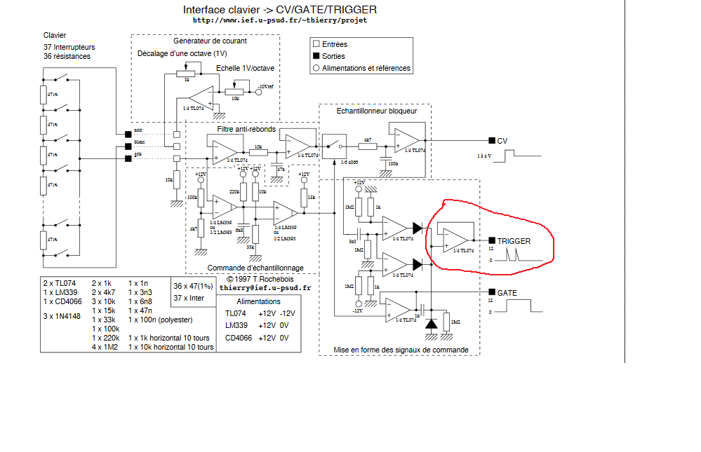

hello Yves,
the keyboard circuit is apparently misbehaving.
I have it breadboarded and i am making the contact between resistor chain and the buss with a simple wire to test it out.
some times i get a constantly on TRIGGER 12 v output signal ,with no key pressed.Other times, instead, it stays off until i press a key, as expected. The GATE works perfectly at least.
The major issue boils down to the keyboard buss contact.though. At times, the contact between the resistor chain and the buss makes random notes or a slightly fluctuating frequency. Other times,rarer, is perfect.
I wonder what's going on. Any ideas ?
i made everything by the book, except subbing the CD4066 with a CD4016.
many thanks !

I am not sure I understood. You are not using a real keybed but actually use a simple wire that you make contact with resistor chain handling the wire in your hand ? If this so then it is prone to capture main supply hum (holding the wire between finger) which may trigger randomly things.
Have you tried with a shielded wire (with shield grounded) ?

The note shift on the end is probably switch bounce from the rough test method you are using ( wire doing a, make break, make break as you pull it away.) that will mess with the sample and hold. Will almost always produce a pitch fall off. Had that problem with one set of bass pedals that had really long open reed switches.
If the gate staying on coincides with the pitch issue, I would look at everything around the 2 opamps on the lower left. They are responsible fore the gate prior to the sample and hold. Loose ground would do it.
Sorry I can't help more, but I didn't use the LM339. I adjusted the bias to use TL072 in that location. I couldn't see a reason why not to.

The random sample and hold issue may clear up when you are using an actual keyboard.
If the trigger is on, but the gate is working correctly. That is on the right hand side of the schematic.
Bottom right opamp is gate buffer. The 3 opamps over it in the same section are the trigger opamps.
I have not built that section yet, so I can't give you good advice there, except to check everything around those 3 opamps
It pretty much has to be there.
Edit. Took another look. Actually if you have voltage out all the time on the trigger, you probably need to look at the trigger output buffer opamp.
Check what trigger voltage looks like on its input. If it is a proper trigger puls there, the problem is at the output trigger opamp.

PostPosted: Sat Dec 03, 2016 4:50 pm    Post subject: Reply with quote  Mark this post and the followings unread
And yes, i measured the voltage on the non inverting input of the trigger buffer, still reading 8 V

I'm trying to grasp how the 2 comparators before the buffer produce an output puls.
gdavis
Joined: Feb 27, 2013
Posts: 359
Location: San Diego
PostPosted: Sat Dec 03, 2016 6:44 pm    Post subject: Reply with quote  Mark this post and the followings unread
The 3n3 cap and 1M2 resistor create a small negative or positive pulse whenever the CV changes suddenly. One comparator senses a negative going pulse and the other senses a positive going pulse. Together the comparators create a trigger pulse whenever the CV changes either up or down.

thanks Gdavis, i am starting to make sense of it.still the frigging trigger always on output is driving me nuts.

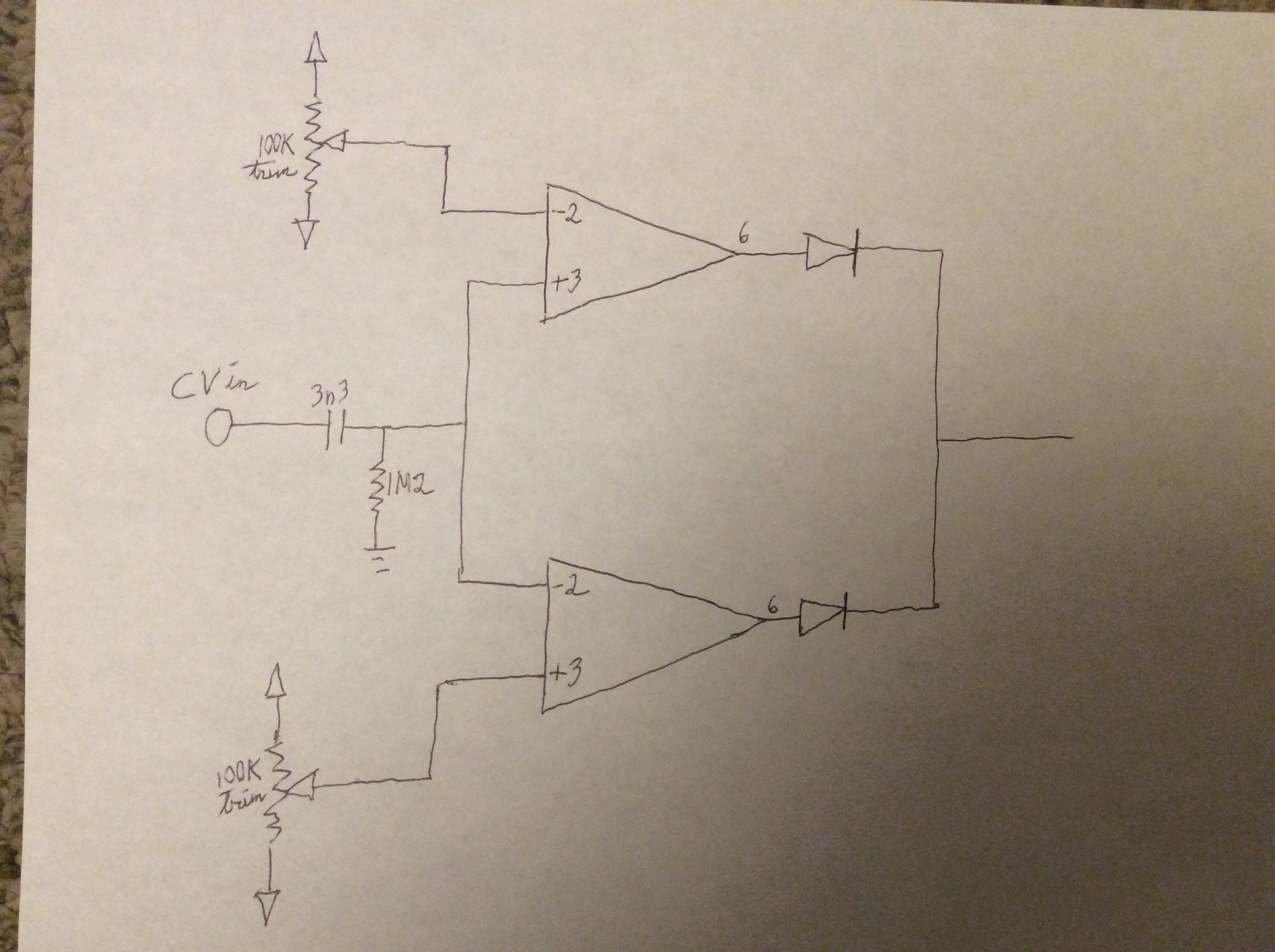

My real point of confusion is the reference voltages being supplied to the comparators. Couldn't they have just been referenced to ground???
gdavis
Posts: 359
Location: San Diego
PostPosted: Sun Dec 04, 2016 1:21 pm    Post subject: Reply with quote  Mark this post and the followings unread
Cfish wrote:
Thanks gdavis
Oh! No, because the input pulses are referenced to ground so any small amount of noise would trigger it. They're referenced to slightly above ground and slightly below ground to create a threshold that the input pulses have to reach in order to create a trigger.

Hay alanwilder81
I built the trigger section of this today.
I had a random problem with one of the comparators staying on. I raised the value of the 1k resistor on the input of the one that was staying on and it cleared it up. Think I added an extra 500 ohm in series.
Edit, sorry was 50 ohm
Started building a permanent version, going to try it like this.
Will make the comparators reference voltage adjustable.
I like doing comparators this way.

PostPosted: Wed Dec 07, 2016 11:57 am    Post subject: Reply with quote  Mark this post and the followings unread
Hi alanwilder81
It's pretty much complete with a few changes.
All you need to do to see which comparator is on, is check for voltage at the output of each comparator opamp, between the opamp and diode. Should be -v except for output puls. If one is on, the reference voltage to that comparator is not far enough off ground to consistently shut it off after a puls.
That's assuming there isn't just a small build error on the breadboard.
Also there is a line between the comparators and the output buffer going down to the gate. I would unhook that untill you get the problem ironed out. I left it out on mine all together at the moment. It is there to cause a retrigger when you play a patern on the same key. I will add it in. I just haven't yet.
If your still having problems I could try to do a quick private reference video on YouTube and list you to view it, if you have a YouTube account.
Once I got my head wrapped around how the comparators were working, this is a really easy circuit to diognose trouble with. Really not sure why I was having trouble seeing it to begin with.
