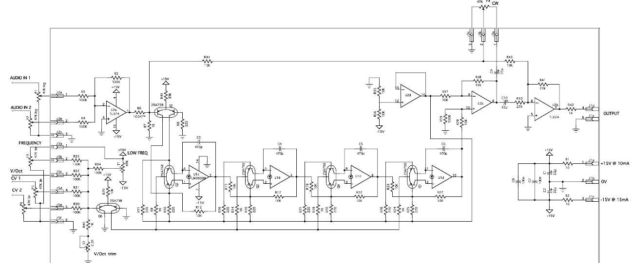

hello folks.
First and foremost, a warm thanks to Yves Usson for designing and sharing with us an excellent sounding ARP 4072 filter clone !
I've recently built myself one, and despite it needing some tweaking and fine tuning here and there, i must admit it already sounds damn good !
I would like to share with you chaps,your experiences,feelings,measurements and possibily sound samples of the 4072 filter module you built.
Feel free to add any material regarding this awesome reissue, and also some opininons on the resonance bleed through i've read about, but not sure what it really is.
thanks ! Smile

PostPosted: Thu Dec 29, 2016 1:58 pm    Post subject: Reply with quote  Mark this post and the followings unread
heres the schematic

my 4072 filter , however, doesnt self oscillate, nor does that of other chaps who built the same project.
Some people talk about bleed through signal .What is that? i am trying to figure it out, especially if it has something to do with the filter not self oscillating !
they say there are some discrepancies between this clone and the original ARP filter resonance wise. Smile

The bleedthrough thing has nothing to do with the self-oscillation of the filter.
It's an inherent issue of this circuit: at mid-high resonance levels and low frequency you can hear a faint ghost of the original signal bleeding through. It's easily corrected with a dual gang resonance pot, as clearly explained in this thread:
http://electro-music.com/forum/topic-47802.html
I really don't know why your filter doesn't self oscillate. Both mine oscillate nicely from 2-3 o'clock and with a careful trimming they track with reasonable precision over 4 octaves. Unfortunately I don't have a real ARP filter to compare but read what Yves says in his webpage :
"If you wish to change the range of the resonance potentiometer change the value of R44, increasing its resistance will reduce the resonance range, reducing the resistance will increase the auto-oscillating behaviour at maximum resonance. If you wish to keep the original ARP resonance behaviour suppress R43"
Hope this helps!

so, back to the ARP filter. You helped me demistify a bit the signal bleedthrough thing. is that ,in a nutshell, an unfiltered signal that find his way through and sums to the already filtered signal?
i find this technical things very fascinating in all fairness. And there's a lot of talking around the net over tips to fix this wonderful filter.
Mine doesnt produce a clean sine wave at max resonance,assuming it's expected to do so.
Rather, it makes a sort of gritty whistle , very much like on this YouTube video demo at 1:15
https://www.youtube.com/watch?v=B9T9ocrqeIE
I am not quite sure whether or not the ARP self oscillating filter is supposed to sound like, say, that of the minimoog, that sound a lot like a flute. In both my filter and in that of the YouTube demo, the self oscillation is far from smooth and clean.

Also, what are the symptoms of signal bleedthrough by the way?

As I said, the bleedthrough symptoms are obvious: at low cutoff AND high resonance the unfiltered signal can be faintly heard. This annoying behavior is the side effect of the feedback path (R44) used to compensate the typical loss of volume at high resonance that ladder filters exhibit (ARP and Moog likewise).
As Yves said, if you wish to revert to the original all you have to do is remove R44: no bleedthrough but the notorious volume loss is back. The dual gang pot mod gives you the best of both worlds (come diremmo noi salva capra e cavoli).
You have definitely to match the trannies. They cost peanuts and the matching is an easy task, especially with those chinese components testers they sell by the pound on ebay. Otherwise there are plenty of instructions here on electro-music or elsewhere.
The filter, judging by ear, DOES sound like the ARP. There are several comparisons on youtube, you can judge it by yourself (you can search even for STG Post-Lawsuit Filter, which is exactly the same circuit as Yusynth's).
Have fun! It's an amazing filter.
