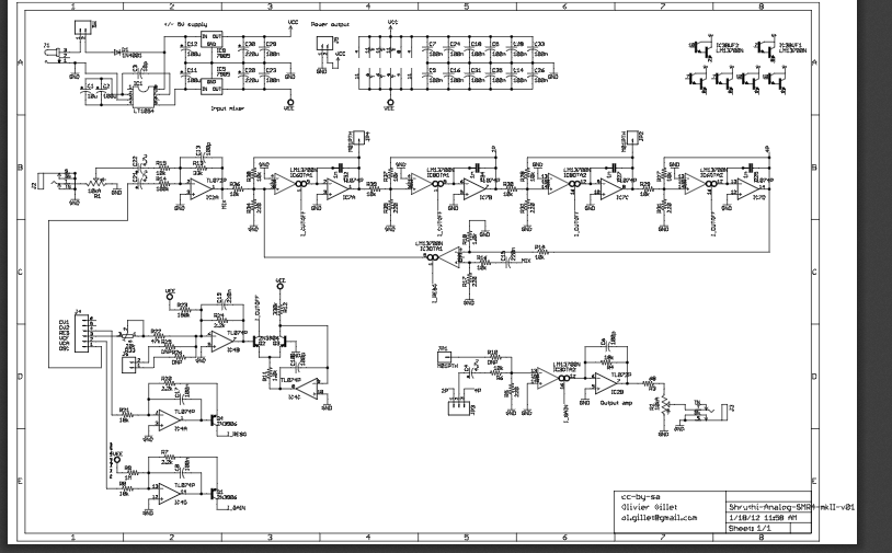

Cynosure,

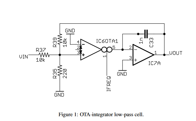

I got this picture from the Mutable Instruments SMR-4 mkII filter board.
I do believe you were referring to this when mentioned a row of 4 OTA integrators
 Filesize:  21.56 KB
 Viewed:  869 Time(s)
alanwilder81
Joined: Sep 03, 2016
Posts: 310
Location: italy
PostPosted: Tue Nov 22, 2016 3:56 am    Post subject: Reply with quote  Mark this post and the followings unread
and this is the complete schemos

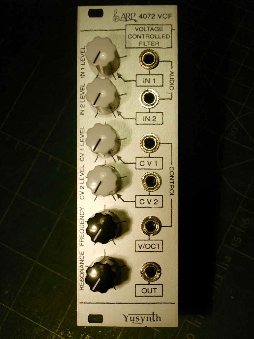

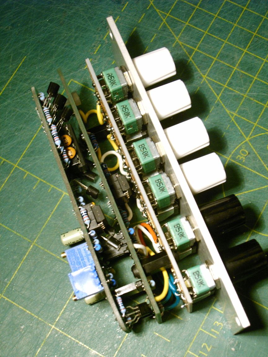

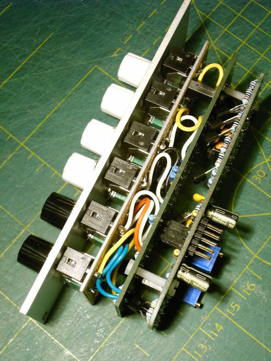

Finished an ARP 4072 VCF (Yusynth design) with the PCB's I got for christmas from AlanP, Thanks Alan! Very Happy
I did add an extra PCB for pots and jacks to change the spacing and to have the controls on the left and connectors on the right, which
gives me a bit more finger room when placing it besides other modules that also have the knobs and connectors in the same position.
I did a quick test, mostly to calibrate it, and it sounds nice. I might replace the knobs later whenever I order some.

excellent as usual, phobos Smile
i've built one too, and it sounds freaking amazing.I am currently running the Thomas Henry 555 VCO through the ARP filter.
The PWM on that VCO in particular amazes me. Dark, metallic, brassy if you like, very early 80's tone.
I wonder what's the major contribute to the tone i got.
The VCO itself or the ARP filter?
a winning combination, anyway Smile

PostPosted: Mon Jan 23, 2017 9:17 pm    Post subject: Reply with quote  Mark this post and the followings unread
Heh, it always makes me laugh when I see this. I go to all this effort to avoid doing wiring, and what do people do? Wink Smile Laughing
Very nice job, Phobos!
Posts: 5929
PostPosted: Thu Oct 05, 2017 10:29 am    Post subject: Reply with quote  Mark this post and the followings unread
it is nice to not have to any wiring but the spacing just didn't really work for me. Thanks again for the PCB for it, It's a really nice filter.

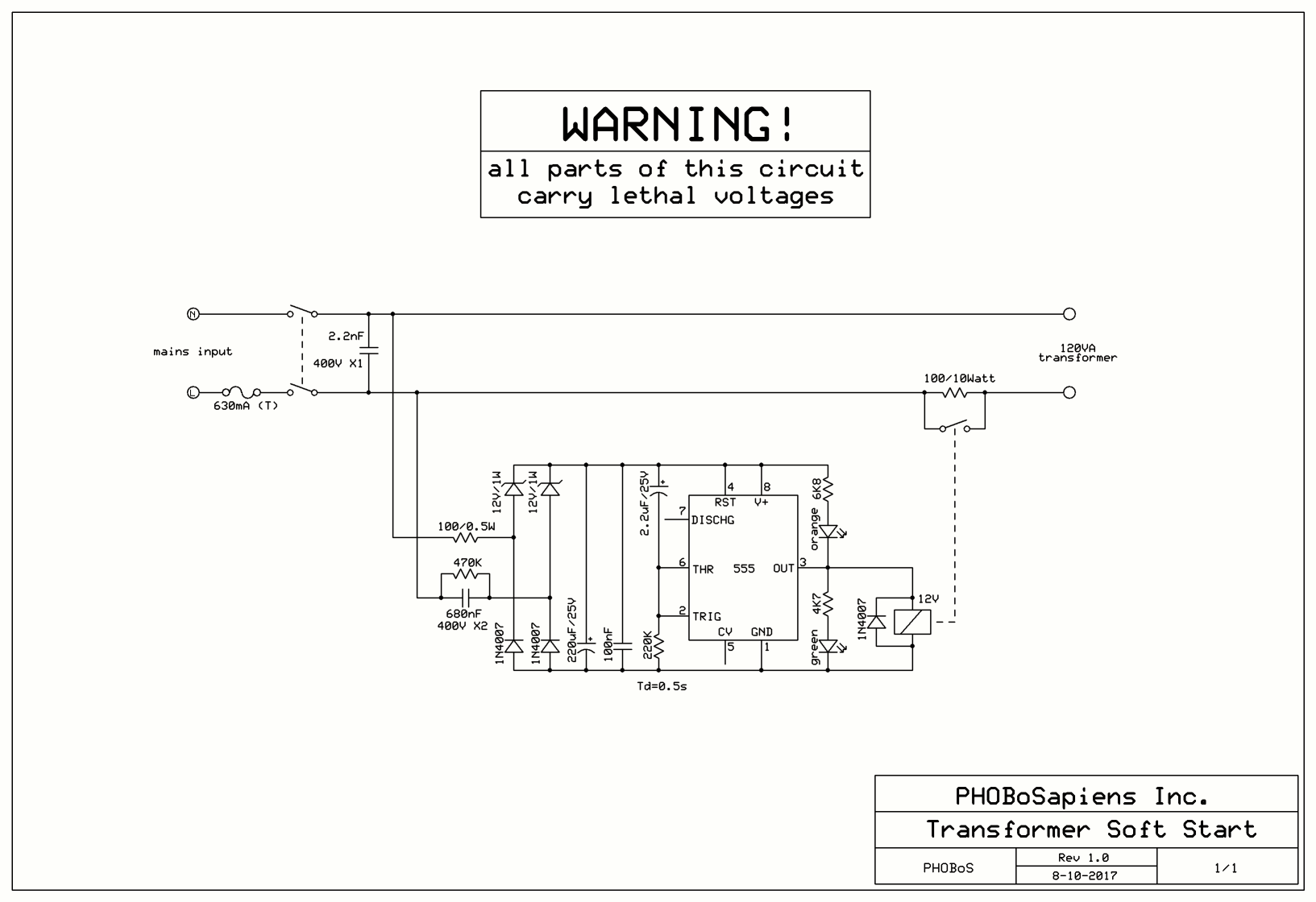

For the powersupply I have been looking at some cheap switched mode power supplies on ebay. Because they would need
some extra regulation the output voltage has to be at least 15V which is too bad as the 12V is much more common and also
cheaper. I did find a 15V 3.5A version but I was curious how much a toroidal transformer would set me back. I couldn't
find many at first besides Conrad and it wasn't even that expensive. After doing some more searching I finally located a 50VA
for a lower price than the switched mode supplies, the current is lower too of course. Eventually I settled on a 120VA, not that
I need that much current at the moment but I'd rather get something with a bit more juice now than having to built yet another
supply at a later stage.
Of course I'd need some regulators that can handle the power for which a standard LM317/LM337 isn't sufficient. After looking around
a bit I found the LT1083 which can handle 7.5A. However the negative counterpart (LT1033 with only 3A) is obsolete. But as I know
now you can make a bipolar supply with 2 positive regulators for which I started a thread here.
So ideally with 120VA I could get 2x5A which is way more than I need but let's design the PSU for it anyway to be on the safe side.
Usually I just add some caps that I think should be sufficient but this time I am calculating the minimum values. I found some equations
and used the example from here.
The key point is that C1 must be big enough so that its voltage doesn't sag below the sum of the supply's output voltage plus the regulator's dropout voltage. C1 gets a pulse of current from the rectifier twice per 50Hz cycle, i.e. every 10msec. It charges to a peak determined by the transformer secondary voltage minus some IR drop and the forward drop of either one or two rectifier diodes. For the next 9msec or so, it is discharged by the load current on the supply. Charge is Q=C×ΔV= i×Δt. Rearranging gives C=i×Δt/ΔV.
You know I (supply load current) and Δt (about 9msec at 50Hz), so if you know ΔV (how much C1 can sag) you can solve for C. Very Happy
Guessing that the dropout voltage of your reg is about 2V, and you want 7.5V out, that means that the minimum input voltage to the reg is 9.5V. If you start with a 12Vrms tranny, the capacitor will charge to 1.4*12-2V (peak is 1.414×rms, 2V drop in two diodes)= 15V. ΔV=15-9.5=5.5
Finally, C=2×0.009/5.5 = 0.0033 FARADs!!! = 3300uF
The supply voltage is already the same although the voltage drop over the diodes (SB560) is lower but let's use the 2V anyway.
To calculate ΔV I need the dropout voltage and according to the datasheet for the LT1083 it is about 1.4V @5A. The mimimum
input voltage to the regulator is 12V + 1.4V = 13.4V, so ΔV is 15V - 13.4V = 1.6V.
C = 5×0.009/1.6 = 28125uF. So for <5A 6 capacitors of 4700uF (28200uF) should be sufficient.

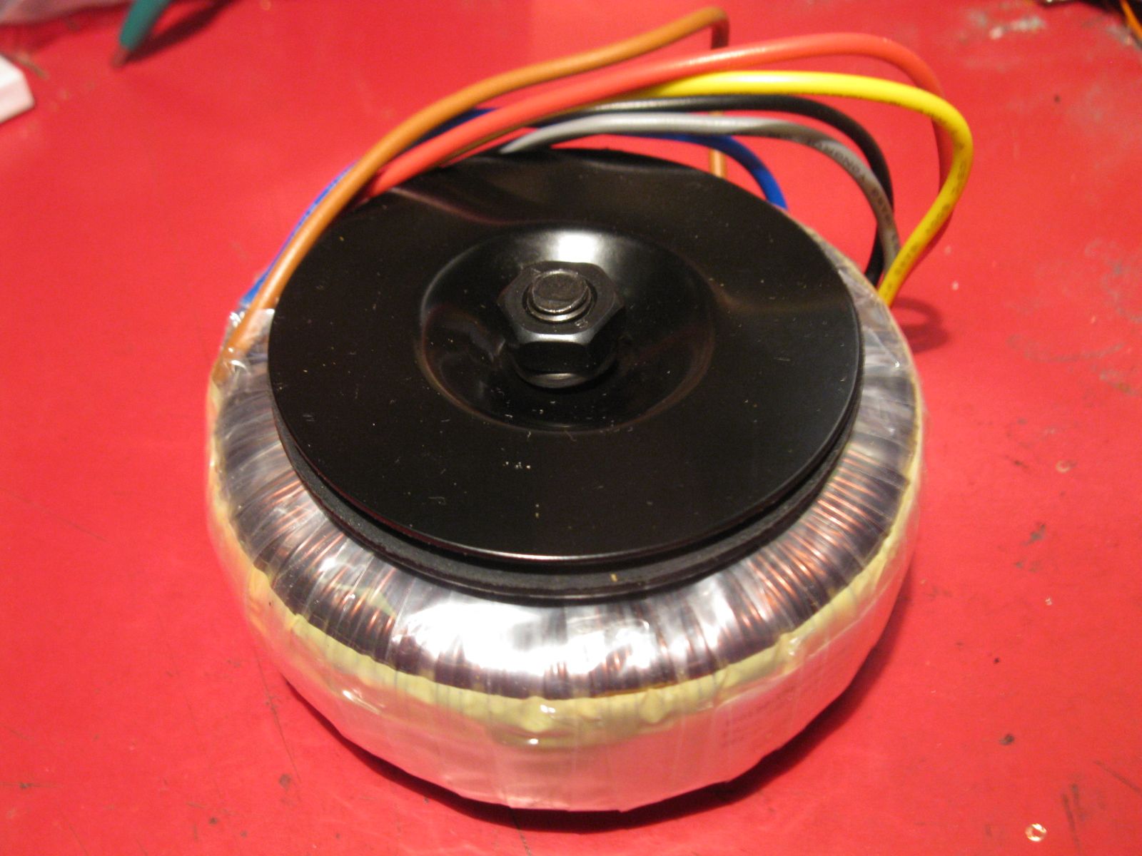

I received the toroidal transformer yesterday and she is a beauty Razz

Where did you get the transformer? Mine wasnt cheap Sad
For the bipolar supply I used a LM723 based design, opamp for the negative part and a bunch of power transistors to handle the current. For the capacitors I used Panasonic 105 degC, 35V. Not sure where I got them from, maybe eoo-bv.nl? Otherwise probably Farnell or TME.
Weblog!
Posts: 5929
PostPosted: Sat Oct 07, 2017 8:24 am    Post subject: Reply with quote  Mark this post and the followings unread
Toroidal transformer from here.
Personally delivered as the guy from the store happened to be in the neighbourhood Razz They also send me a photo of it beforehand when I
asked about any mounting hardware.

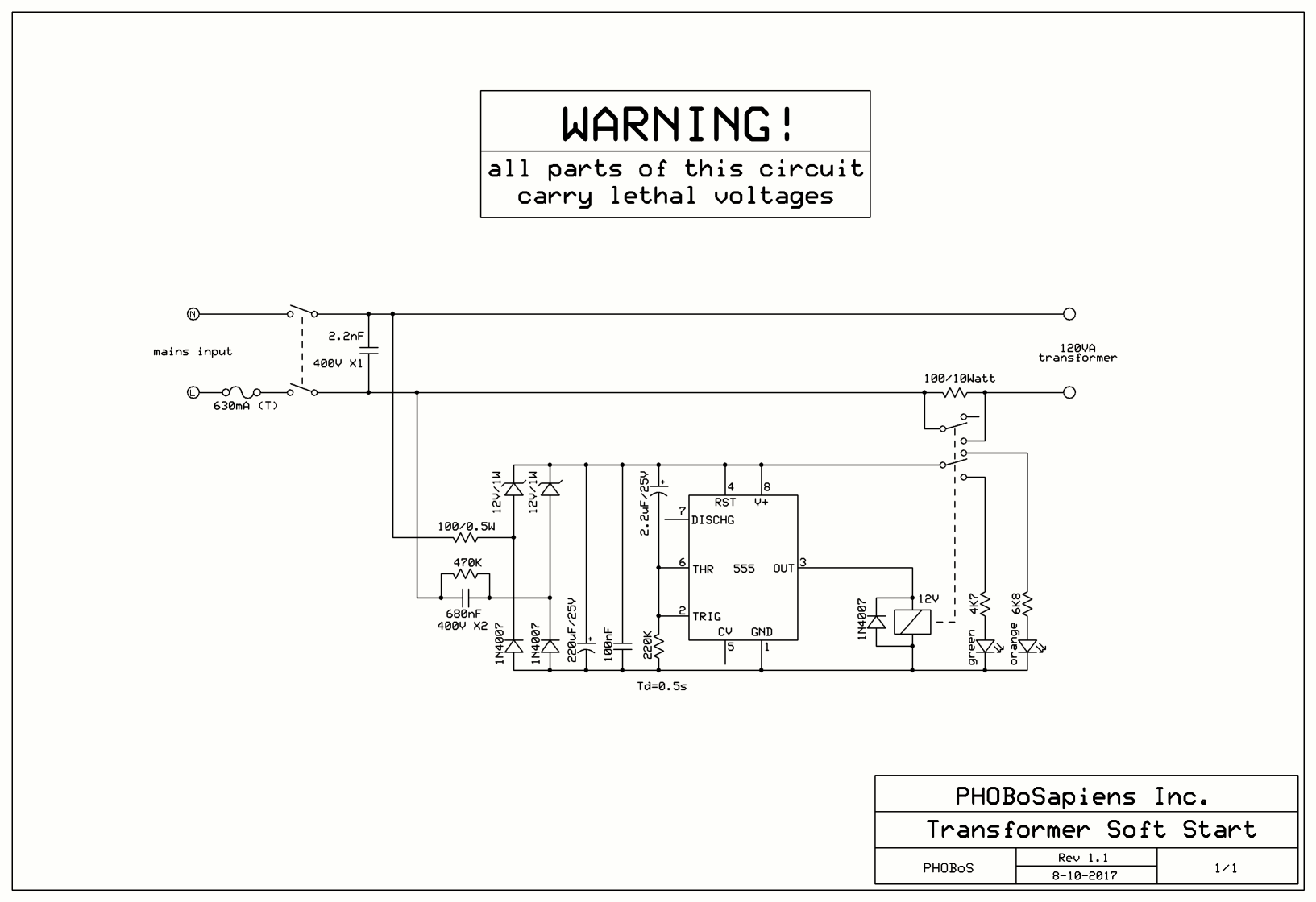

Big toroidals have a nasty in rush current; that could be an issue.
When a transformer is first energized, a transient current up to 10 to 15 times larger than the rated transformer current can flow for several cycles. Toroidal transformers, using less copper for the same power handling, can have up to 60 times inrush to running current. Worst case inrush happens when the primary winding is connected at an instant around the zero-crossing of the primary voltage, (which for a pure inductance would be the current maximum in the AC cycle) and if the polarity of the voltage half cycle has the same polarity as the remanence in the iron core has.
R
Posts: 5929
PostPosted: Sun Oct 08, 2017 4:04 am    Post subject: Reply with quote  Mark this post and the followings unread
Yes, you are correct about the inrush current although I expect it won't be too bad with this supply but I could add a softstart circuit.
I am thinking a simple transformerless supply which powers a 555 timer that turns on a relay after a short time. The relay will
short out a low value (high power) resistor in series with the mains input of the transformer. Maybe powering it from the secondary
of the transformer would work too as it is pretty low current. But the advantage of a seperate (transformerless) supply would be that
it could be built on a small board which can simply be put in series with the transformer.
A simple thermistor might be enough too though.
Posts: 5929
PostPosted: Thu Oct 12, 2017 1:36 pm    Post subject: Reply with quote  Mark this post and the followings unread
After reading up a bit more about it I am pretty sure I wouldn't need to limit the inrush current. It wouldn't hurt though and
I do switch it on together with some other gear so it might not be a bad idea to do it anyway. While searching on how to
calculate the correct capacitor I came across this design which happened to be designed for the voltage and current I need.
I also really like how the zenerdiodes are incorporated into the bridge rectifier, something I would have never thought of.
The way the 555 is setup is something I came across when looking for some softstart example ciruits, I might have done it
different otherwise.
I drew up 2 versions:
The first one uses a relay with an SPST switch which is what I currently have in my possesion.
The second version uses a relay with an DPDT switch whch would be better since it indicates
if the relay itself is actually working, instead of just showing the output state of the 555.
I did test the circuit and it works fine.
I found some nice Nichicon caps at TME that I will probably order. They're a bit more expensive than the Samxon KM
caps but the specs are much better. I also might have underestimated the current through the diodes/bridge rectifier a bit.
Using this circuit simulation it seems that the peak current for a 5A output with 22800uF in caps can go up to about 45A.
If I understand the datasheets correct this isn't really a problem though as the peak current rating is much higher than
the average current rating. I did a bit of a mock-up to test how I am going to actually built and position everything and
from that decided that I will go for some big square bridge rectifiers. Since there is hardly any difference in price
between different ratings (and I couldn't find any other major differences between them) I will probably get some
that are suitable for 35A/100V.
