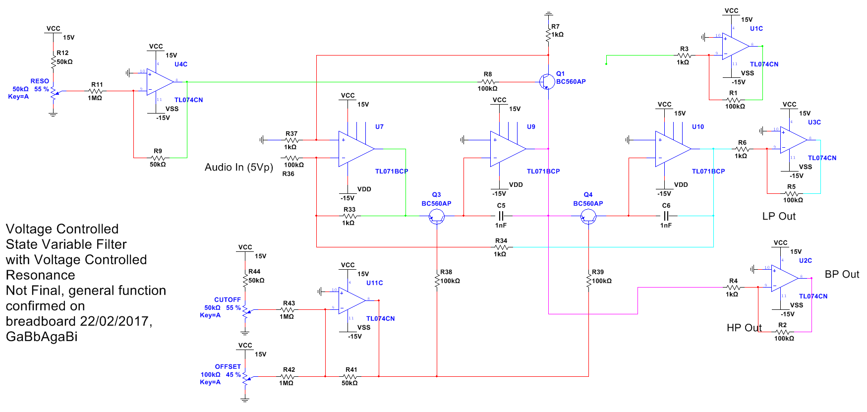

I had this on the Breadboard yesterday.
Normally i would do more testing before posting, but there is a other thread talking about this. May it can be usefull.
Cheers BB,

Nice! I love the simplicity there. I wonder if you can do voltage controlled resonance using a transistor as well.

thx J3RK,
simplicity is what iam searching for,
for me this is where all the beauty and joy in the world is coming from Let us pray
i have tried this on the breadboard today, with some success.

Nice circuit, i will try it.
I think that the HP Out is missing in the second circuit...

thx,
i guess u have to apply a offset to the resonace-part also, and play with the resistor values that are on top of the cv pots (R12 & R44)
and u can try to ommit R7 or R37
the hp output was meant symbolic like: connect the green "wires", now i see that there are two green, what a shame Smile

Very nice g.gabba!
This configuration is very nice, because I´m in the back of my head thinking about a synth which can be built with garden variety components exclusivly. I think the Monotribe filter does this vc with bjts also in a SallenKey topology.
I would be very interested in a sound sample Wink
