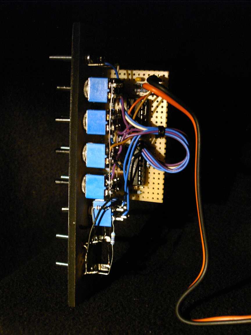

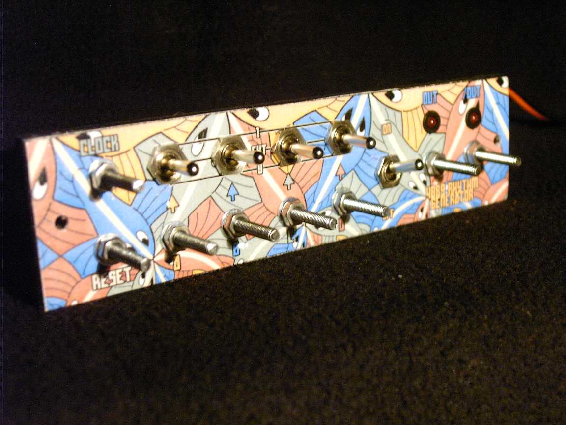

A rhythm generator using the CD4089, very similar to the one I used for the bandersnatch except this time I'm using the clear input as a reset.
For this to work the D input needs to be low when the Clear is made high. So I used an AND gate (made up of U2a + U2b) to
be able to make the D input low. Because this has to happen when the Clear input is high there is an extra inverter (U2c) on
the input of this AND gate. The reset signal is turned into a very narrow pulse and used as a sync input. The Clock needs to
be inverted (since the CD4089 triggers on a high to low transistion) so I used a transistor for that.
The 3 position (toggle) switches make it possible to select between a high, low, or external signal for the ABCD control inputs.

mike page
Joined: Sep 26, 2016
Posts: 134
Location: norwich, uk
PostPosted: Sun Jan 21, 2018 6:12 am    Post subject: Reply with quote  Mark this post and the followings unread
I turned it into a PCB Smile
Im developing a surface mount lunetta modular format where the modules are horizontal as that seems to suit my designs best. They will latch straight onto power rails, maybe with magnets. Here we are looking at the back of a panel.
bolts and switches go through the larger pads. It should be very flat, I might build it into the shell of an old macbook Smile
At the larger blue 'O' a pin on the 4089 needs to be bodged to ground.
