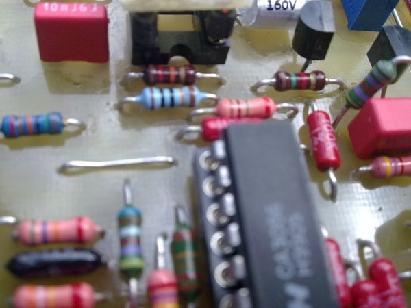

My new HiFi version sounds amazing.

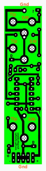

Is the switching lug used for something else? If not, you could add a ground connection to it, was my point. Then you don't have to worry about the position of the attenuator, input will be always grounded unless there's a jack inserted.
furio
Joined: Dec 25, 2009
Posts: 125
Location: Austria
PostPosted: Sun Aug 25, 2013 8:16 pm    Post subject: Reply with quote  Mark this post and the followings unread
OK, thanks for the advice! I was inspired by the Andy's PCB and he had not used the switch.
P.S. Gnd is on the vertical and the switch is not used.

I noticed that with certain metal film resistors least 10-50ppm and 0,1-1% improves stability and decreases the tracking error... at the moment I have a stability of +/-1% and a scale error of +/-3%... this vco module out of the rack, needs 45 minutes of heating and the window must be closed. I have not yet tried to put on Tempco thermally conductive materials. To reach these performance due I install a silver mica 680pf and it still sounds even better than styroflex.
for better stability: R53 (Roederstein Resista 50ppm / 150K) & R60 (Beyschlag 50ppm / 100K)... for better sound: carbon film R61(12K) & R62(1K2)

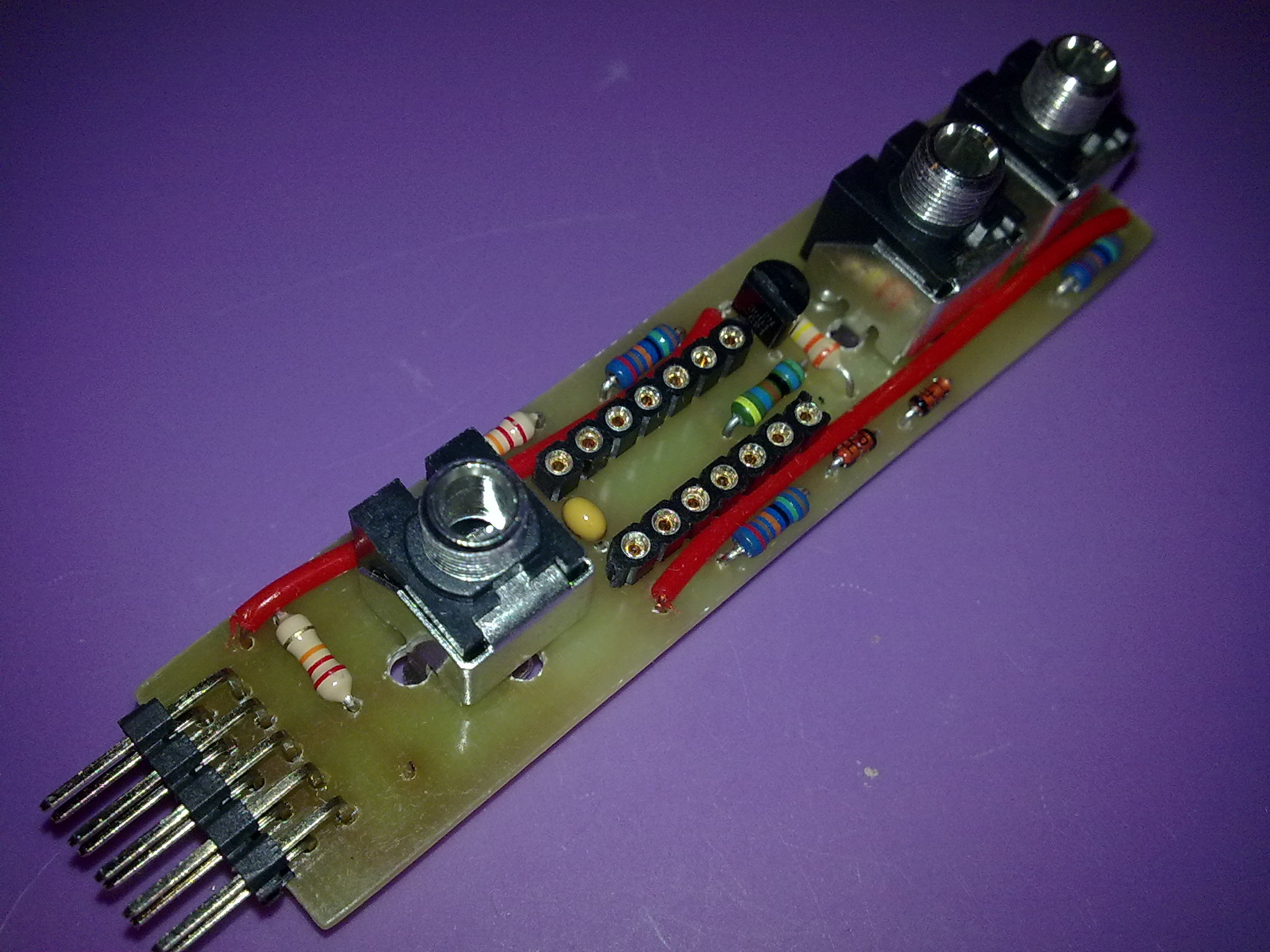

Odyssey's Ring Modulator: 22K, 22K, 100n, 150K, 150K, 5K6, 2N3904, 1N4148, 330K, 1N4148, 150K (back), 150K.

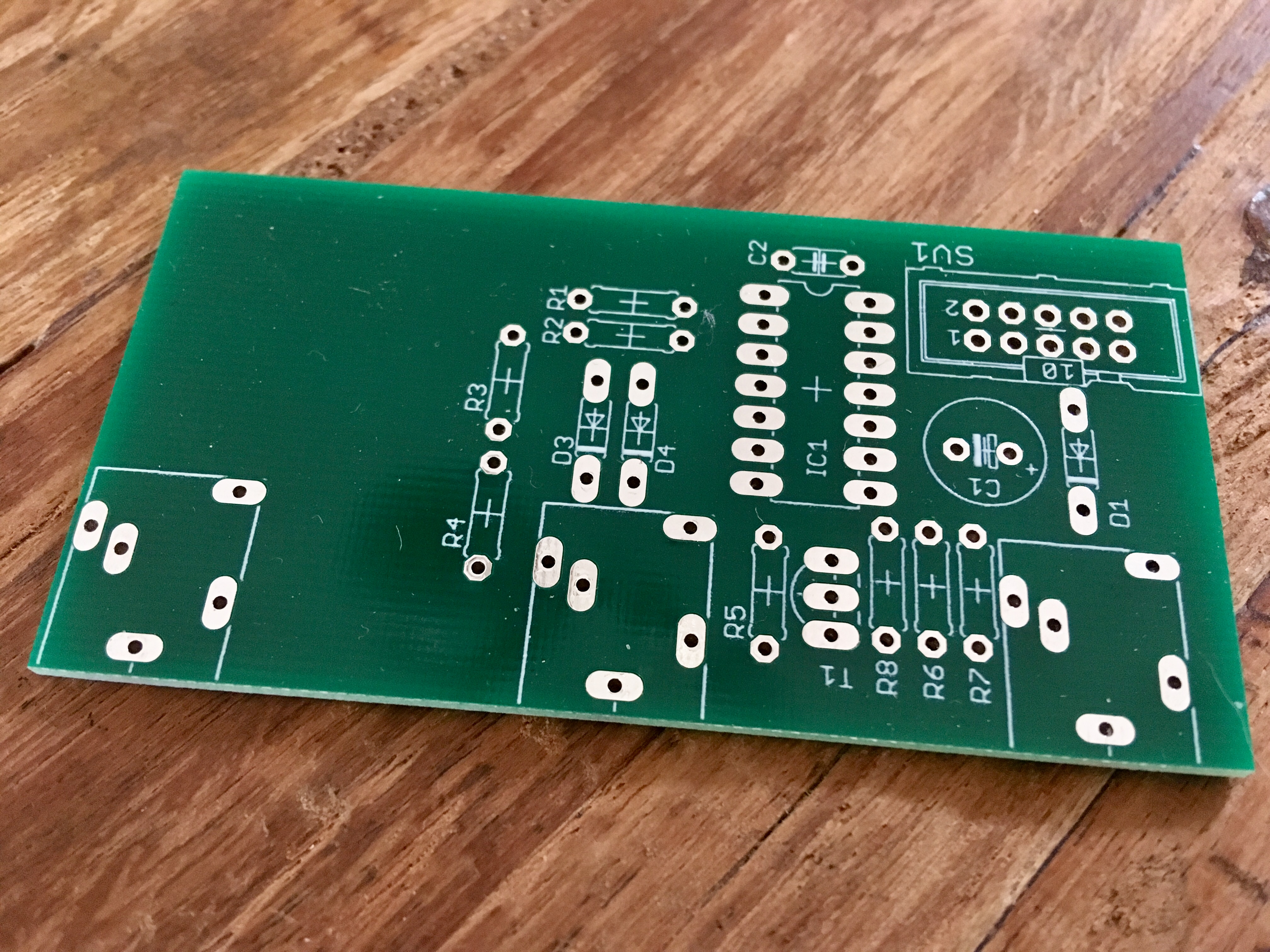

I got the panels and PCBs from Pusherman in the UK. I'm wondering what jacks to search for for the Ring Mod since I haven't been able to find me a BOM for this little module. I'll include a picture of the PCB I purchased.
What kind of jacks to use here? (5-pins?)
Any help would be appreciated.

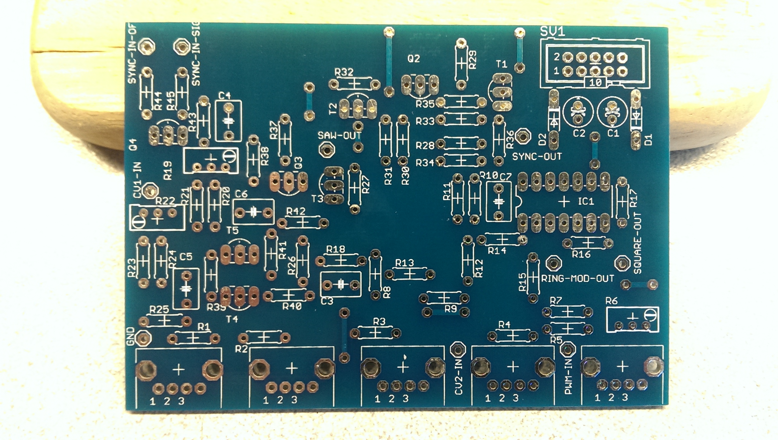

Hi...any help with the parts layout for the Current ARP Odyessy VCO sold on Pusherman.....it is SIGNIFICANTLY different to the pcb info here.

I think you're looking for this repo: https://github.com/PhilicityK/ARP_Odyssey_VCO
