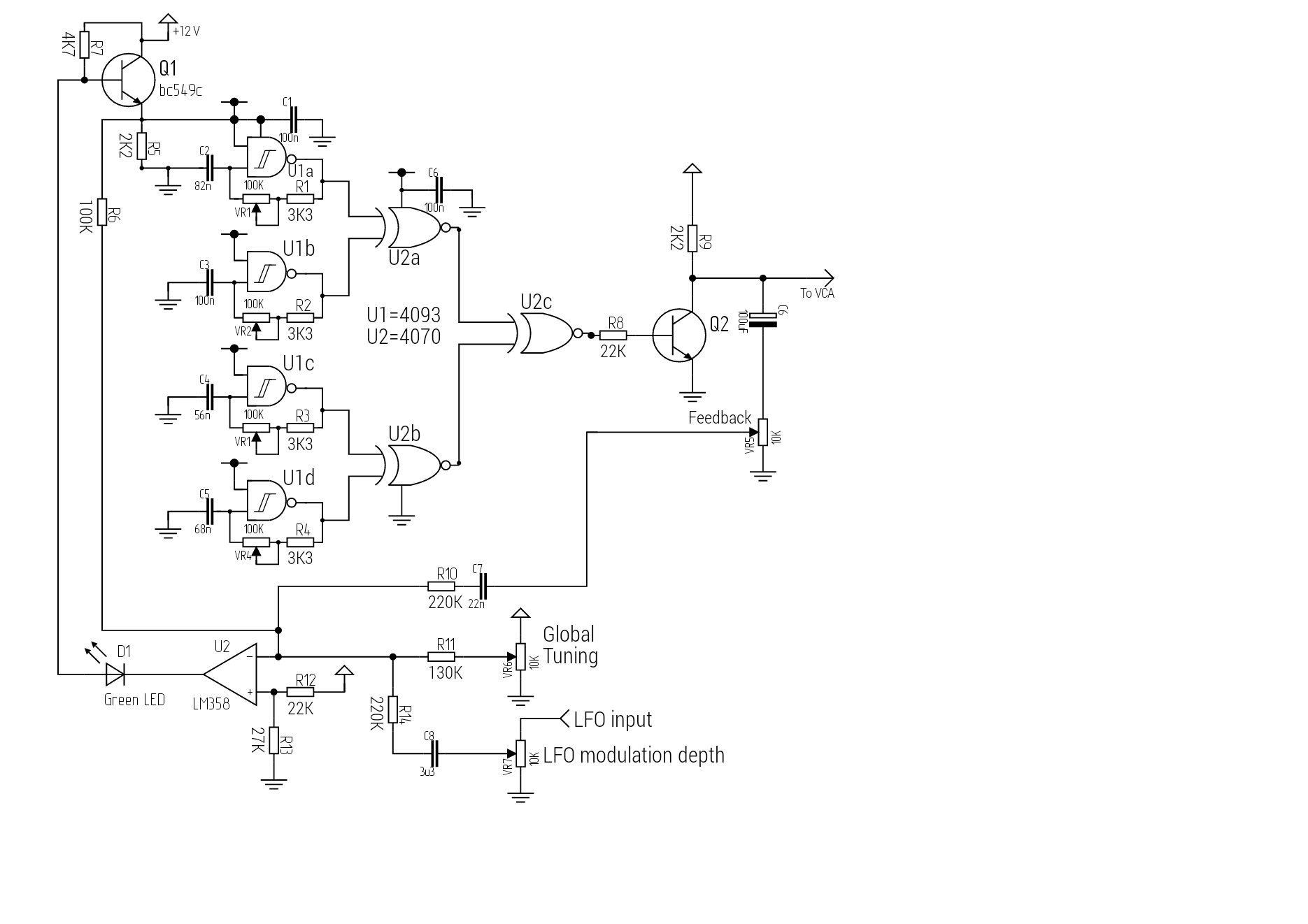

PostPosted: Wed Mar 15, 2017 3:21 pm    Post subject: New design Reply with quote  Mark this post and the followings unread
This is the current state of development of the new complex waveform generator. There will probably be some changes. I was thinking about replacing one of the oscillator pots with a vactrol to allow voltage control of the oscillator frequency, say from an LFO or Envelope Generator.
Any questions or comments are welcomed. Smile
EDIT: in the first posting of this schematic R10 was omitted in error. This has now been corrected

PostPosted: Wed Mar 22, 2017 3:46 pm    Post subject: Reply with quote  Mark this post and the followings unread
Now with added CV mixer. In case anyone is wondering why I used an inverting mixer, it is because the oscillation frequency of the Schmitt trigger oscillators is inversely proportional to the supply voltage.
Note that the lm358 is powered from a single +12 V supply NOT +/- 12 V

PostPosted: Tue Mar 28, 2017 12:03 pm    Post subject: Reply with quote  Mark this post and the followings unread
Have gotten good results with keeping the 4093 voltage fixed ( @+12V ) and using a 4046 as a 5th oscillator ( voltage controlled ) and XORing the 4046 output with the output of the 4093/4077 combo.
See attached schematic ( still to include VCO CV mixer )
 Filesize:  174.21 KB
 Viewed:  602 Time(s)

PostPosted: Thu Mar 30, 2017 8:12 am    Post subject: Reply with quote  Mark this post and the followings unread
Now with CV mixer for the 4046 VCO:
Q1, R13 & R14 are just a buffer ( inverting ) to drive the electrolytic capacitor & pot ( I think Tue outputs of the XOR gates might have struggled to do this alone )
Q2, R15 & R16 is a buffer to the next stage. Not sure what last stage should be yet, some sort of filter?
 Filesize:  132.01 KB
 Viewed:  564 Time(s)

PostPosted: Mon Apr 10, 2017 3:39 pm    Post subject: Reply with quote  Mark this post and the followings unread
If you feed the combined outputs of oscillators 1-4 ( point D ) into the CV mixer feeding the 4046 the output of the 4046 is quite like white noise, though with the ability to "tune" it using the pot also feeding the CV mixer.
