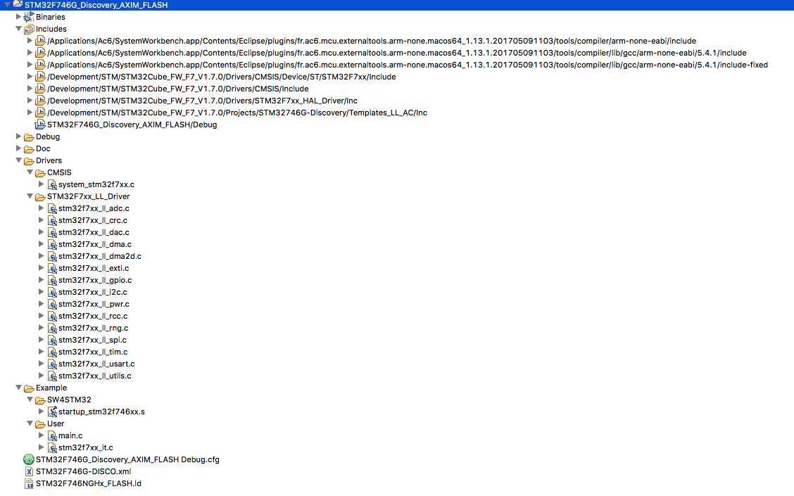

Ok, I gave up on OS X after bashing my head against the wall for a while and used Linux, Ubuntu 16.04.01.
I installed sw4stm32 which is an eclipse based dev environment for ST stuff, got this from here: http://www.openstm32.org/HomePage
I also installed the stm32cubef7 stuff from here: http://www.st.com/en/embedded-software/stm32cubef7.html
I imported the BSP example project into a sw4stm32 workspace, built it and debugged it on the board. Worked first time!
Now looking at getting something minimal running...

With SW4STM32 you can create a Cube/HAL project, the example I posted above uses that. I didn't have to use the Cube stuff to generate any code, I told the IDE what board I was using and it did it for me based on the BSP I'm guessing.
The CUBE stuff can be used to generate a Makefile version of the code needed depending on the peripherals you want to use so that may be a good starting point to start pruning. I'm not sure if it uses the HAL stuff for this, I will have a look tomorrow.
I have used SW4STM32 to generate a "bare metal" project for the board, this seems to set up the includes for C++ and C and also creates a startup asm file, a file called "system.c" and a linker def file. I have included those files. It isn't much help apart from that.

Just had another quick look before starting work.
There is a useful doc STM32Cube_FW_F7_V1.7.0/Documentation/STM32CubeF7GettingStarted.pdf that is worth a look, it shows the different levels of code that the cube stuff has.
There is a low level (LL) interface that it says is the minimal required to get something going on the board, and there are a couple of IDE template projects. There is also a set of examples using the LL interface.
I used one of the templates to create a project in the IDE, this builds and runs on the board. I have included a screen dump of the files it included.
Hopefully sometime today I can have a look and set up a makefile project and this will give you a good starting point to get going on the board.

OK good news, got the led blinking with the LL stuff Smile
Got to start work now but will get a makefile version going sometime today...

I don't think you will be upset with the LL interface, it is pretty low level. Basically just the structures needed and very low level functions to initialise hardware.
For example here is the ADC stuff:
Code:

BobTheDog
Joined: Feb 28, 2005
Posts: 4044
Audio files: 32
G2 patch files: 15
PostPosted: Mon Jun 26, 2017 6:42 am    Post subject: Reply with quote  Mark this post and the followings unread
Also you can ignore STMcubeMX and just use the LL interface to set everything up. I guess you just need the data sheets for all the relevant bits and a bit of head scratching Smile
JovianPyx
Joined: Nov 20, 2007
Posts: 1988
Audio files: 224
PostPosted: Mon Jun 26, 2017 7:32 am    Post subject: Reply with quote  Mark this post and the followings unread
Heh I do feel silly Rolling Eyes LL interface - I assume LL stands for Low Level - but where is it?
I mean, how do I use/run that? I'm currently running STMcubeMX on a Windows 10 box, can the LL thing run under Windows?
I'm considering installing VirtualBox on this laptop so I can use Fedora 25 - would that be a better idea?
Time flies like a banana.
corruptio optimi pessima
BobTheDog
Posts: 4044
Audio files: 32
G2 patch files: 15
PostPosted: Mon Jun 26, 2017 7:40 am    Post subject: Reply with quote  Mark this post and the followings unread
I think you might have missed this post:
If you look at that pdf file it gives a good overview of the different levels of abstraction.
To be honest I don't think you want to use CubeMX at all, it's for generating code at the higher HAL level so if you really want bare metal type of stuff you don't need that. If you want USB/TCPIP stacks then I'm guessing you need to use it though?
I'm just trying to get a Makefile going for building the LL example blinky I have, I'm not a make file expert though so it isn't going well!
BobTheDog
Posts: 4044
Audio files: 32
G2 patch files: 15
PostPosted: Mon Jun 26, 2017 7:43 am    Post subject: Reply with quote  Mark this post and the followings unread
you can get the STM32Cube_FW_F7_V1.7.0 stuff here http://www.st.com/en/embedded-software/stm32cubef7.html right at the bottom of the page.
